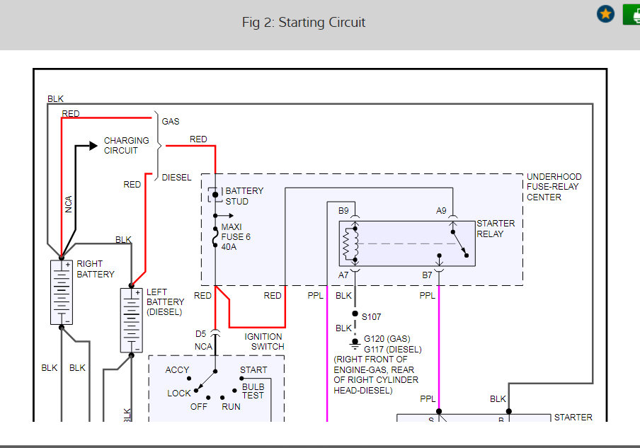

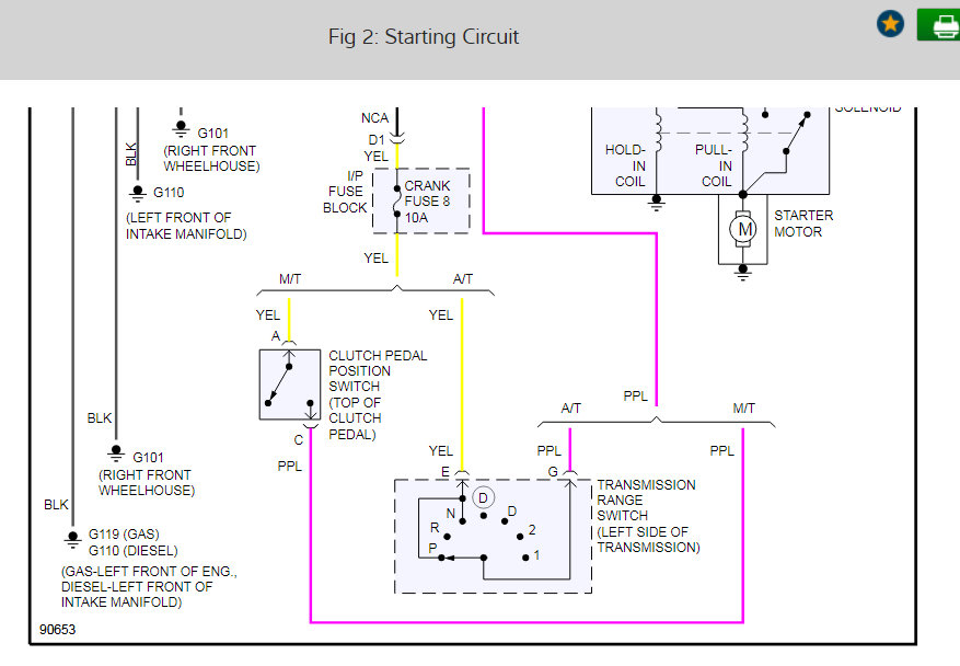

The prndl fuse keeps blowing soon as key is turned on. the pink wire from inside the cab fuse box is melted the plastic off. trying to find out where it runs to.

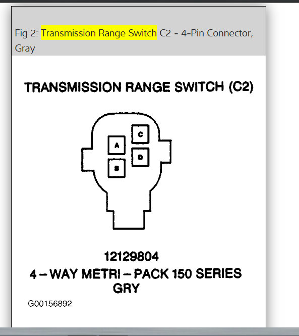

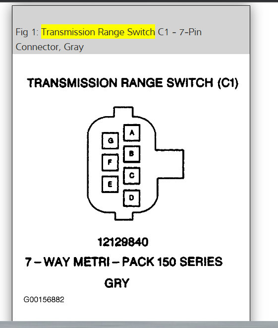

Here is what we have for a wiring diagram for the transmission selector switch. It is from your vehicle's Starting Circuit Wiring Diagram. I have included it in the diagrams down below. If you could get back to us with the DTC(s), we should be able to help you with your vehicle's problem. Please let us know.
