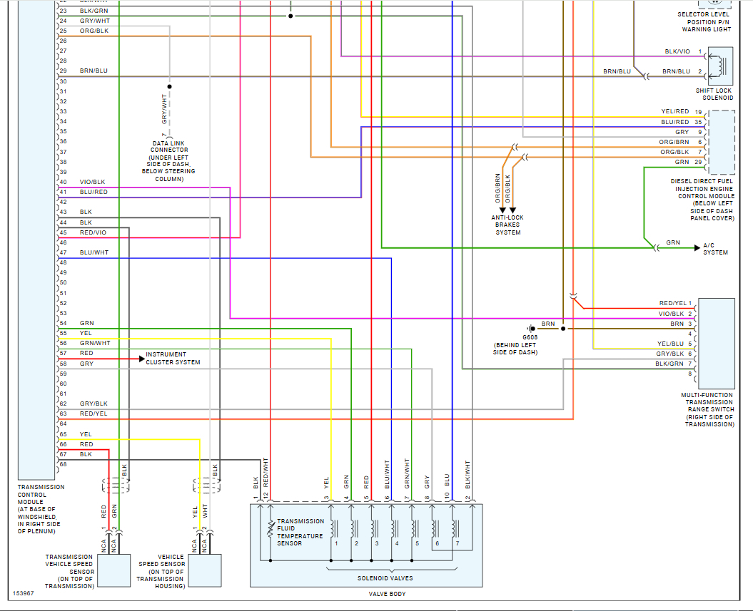

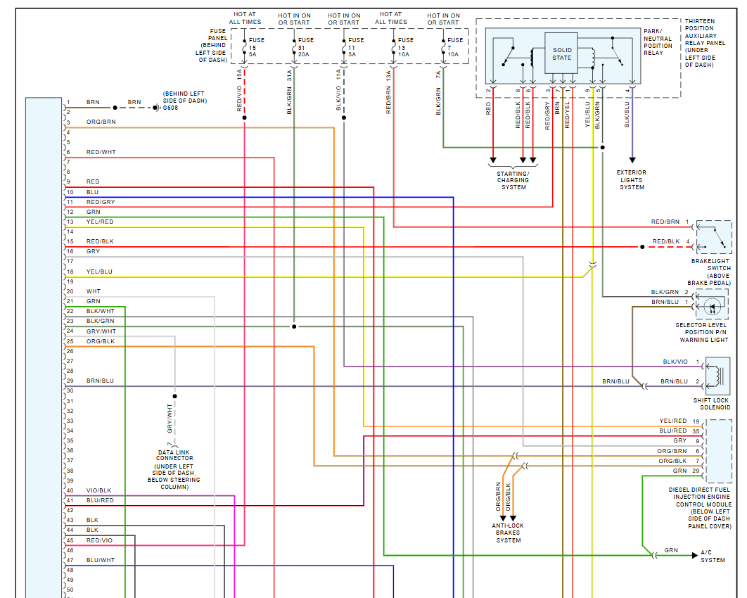

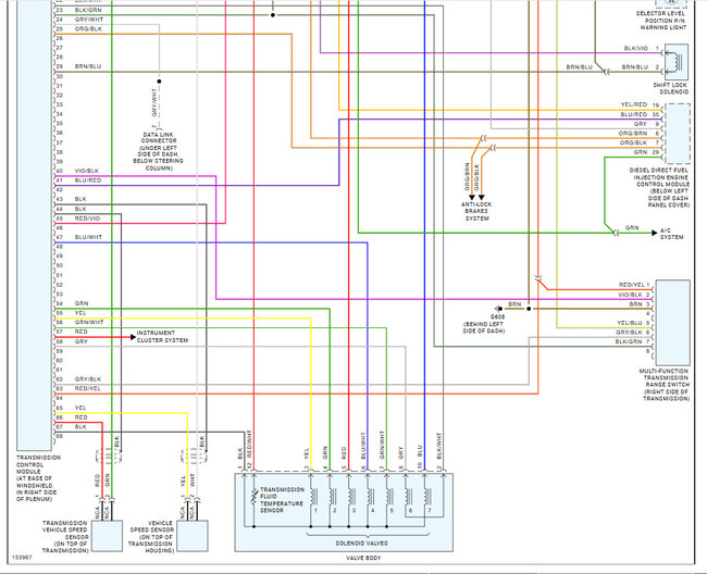

looking for wiring diagram for TCM on 02 jetta with 01m auto trans
2002 VOLKSWAGEN JETTA
23,800 MILES • 1.9L • 4 CYL • 2WD • AUTOMATIC
WIRINGHELPNEEDED
swapping 01m into another car, thought I had all the wiring figured; can't get communication with TCM I believe I cut a wire thats needed, please provide a diagram of pinout
Dec 8, 2025 at 11:04 AM
  • 55,224 POSTS
Sure, here are the transmission wiring diagrams, sorry no pinouts for this car. This guide can help you test the wiring connections.
Check out the images (below). Let us know if you need anything else.
