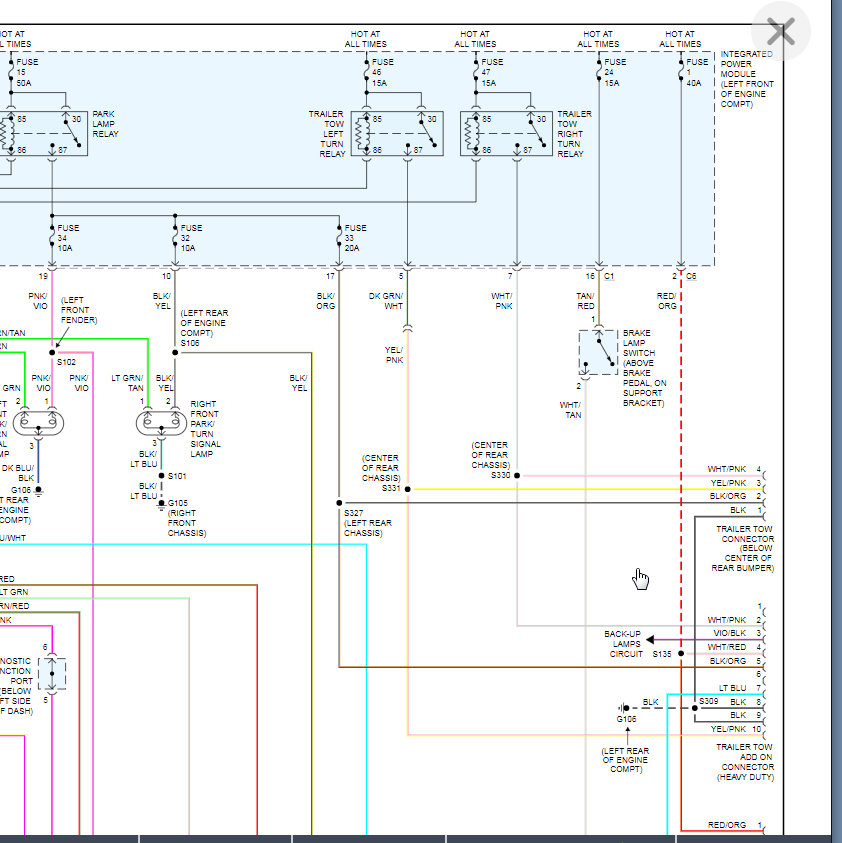

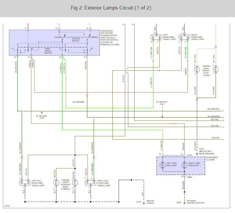

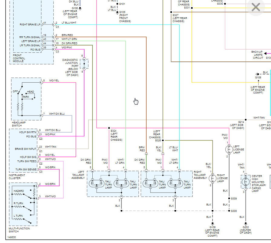

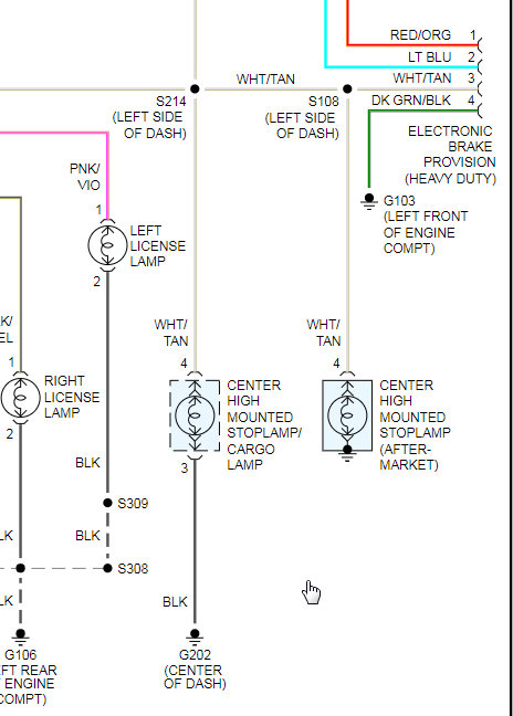

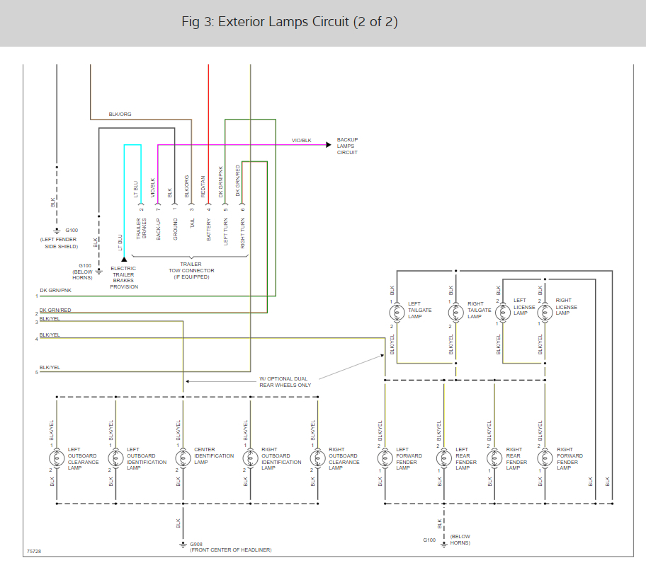

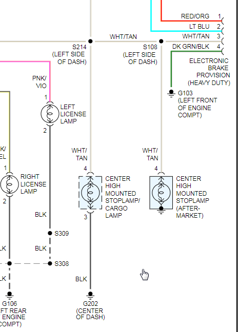

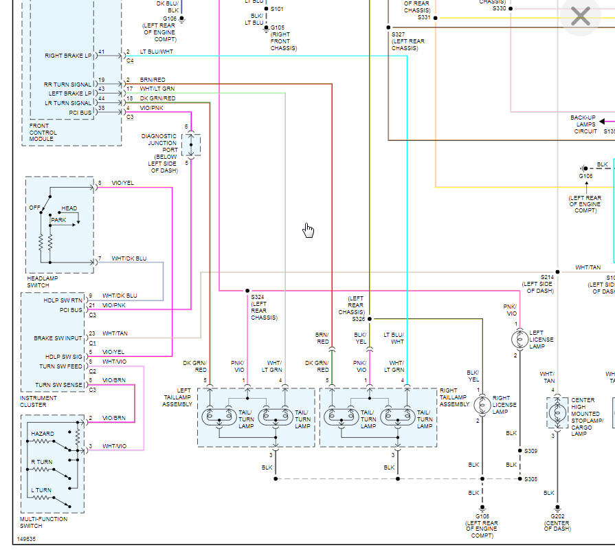

Looking for wiring color/descriptions of the diagram for high stop/cargo lamp. Bought new light and it was bad wiring.
Oct 26, 2020 at 4:39 PM
I attached the wiring diagram for this. Looks like the white/tan wire is the power wire and black is ground. Let us know if you need more info. Check out the diagrams (Below). Please let us know if you need anything else to get the problem fixed. Thanks.
Oct 26, 2020 at 5:41 PM

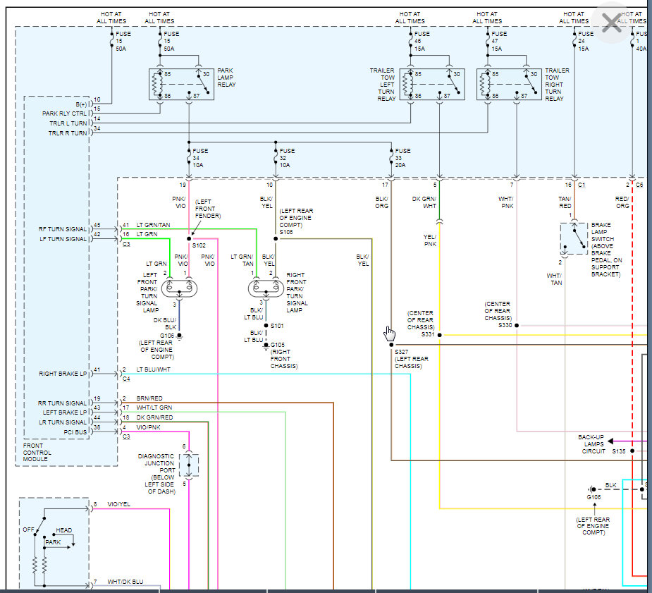

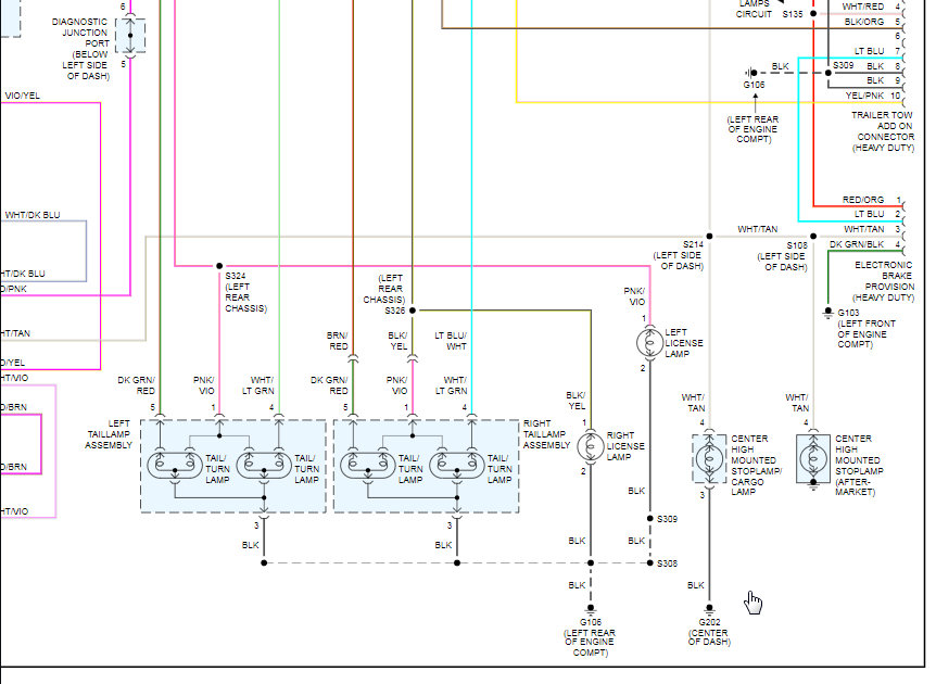

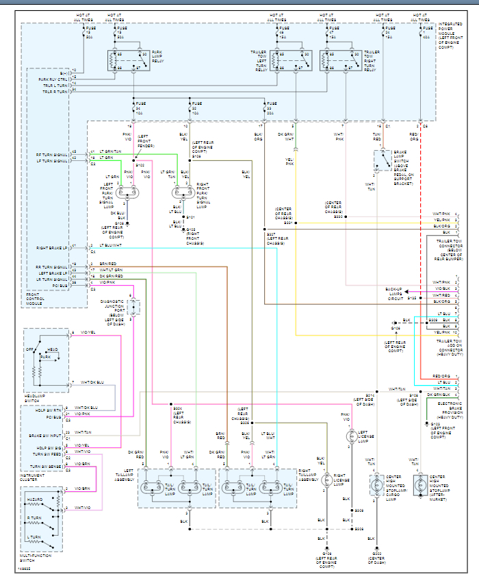

Just re-posting the complete diagrams so they are a little closer as they did not come out very clear.
Jan 15, 2021 at 3:41 PM

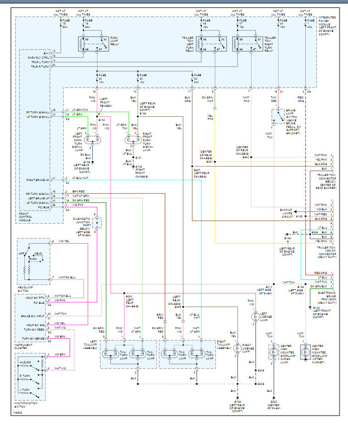

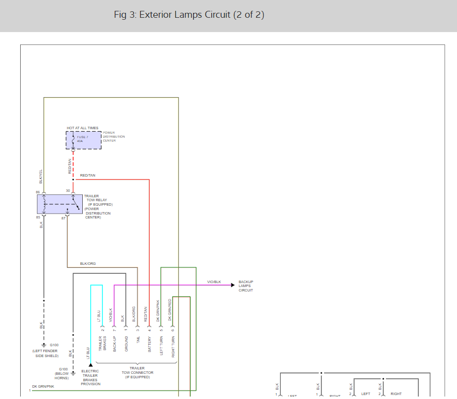

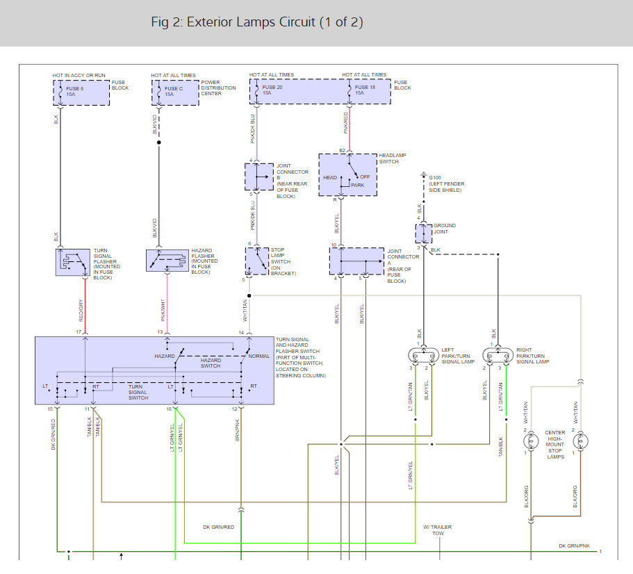

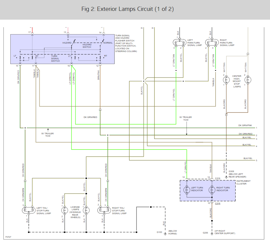

Where is the auto reset circuit breaker for my factory installed trailer brake control Commander brake control. No power being sent to blue wire to rear connector. power in is there and power out on red to stop lights is there. I need the brake light diagrams please
Mar 8, 2021 at 12:27 PM (Merged)
ANDY LUCKO
There is no fuse for the trailer brake controller its internal with the PCM. You must be losing power somewhere here is a guide to help you see where and the truck trailer wiring diagrams so you can see how the system works.
Check out the diagrams (Below). Please let us know what you find.
