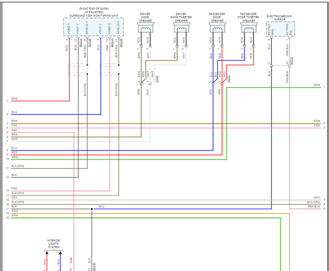

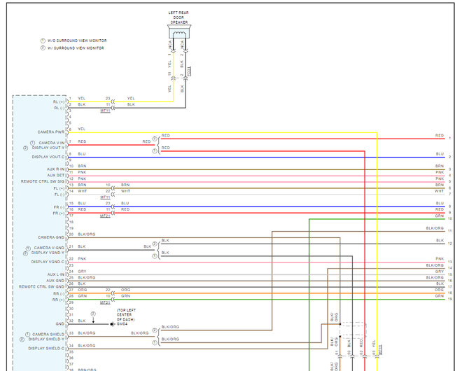

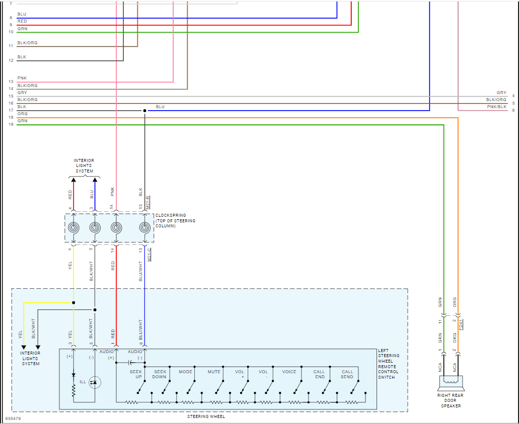

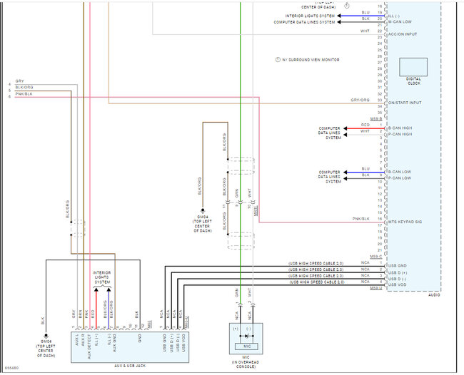

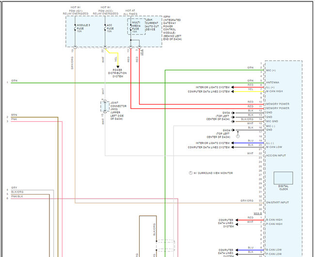

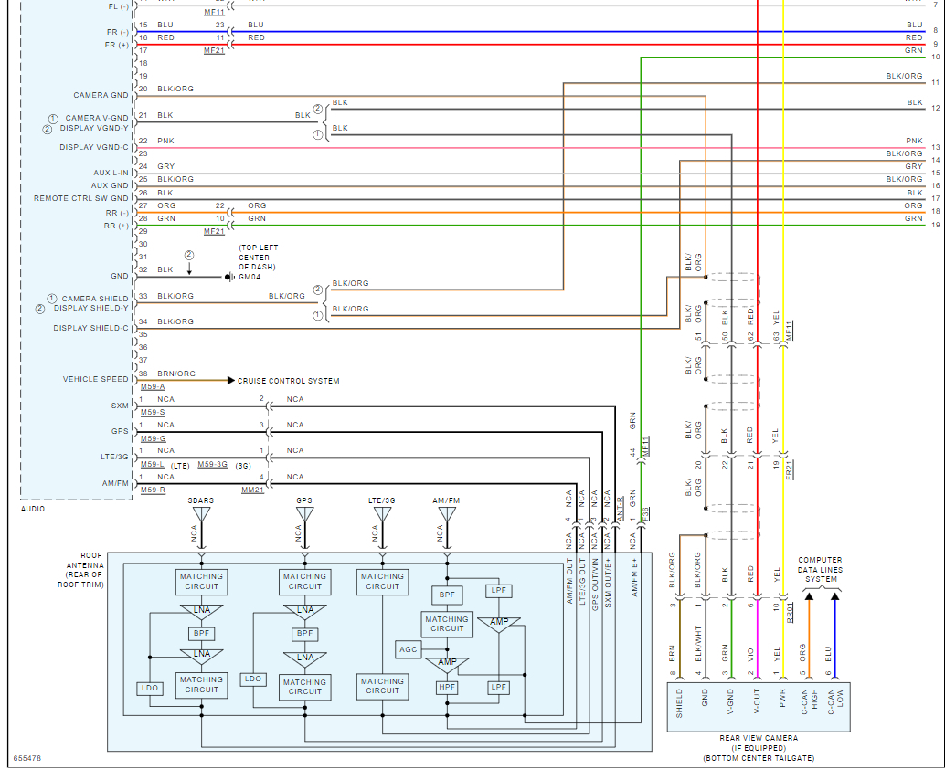

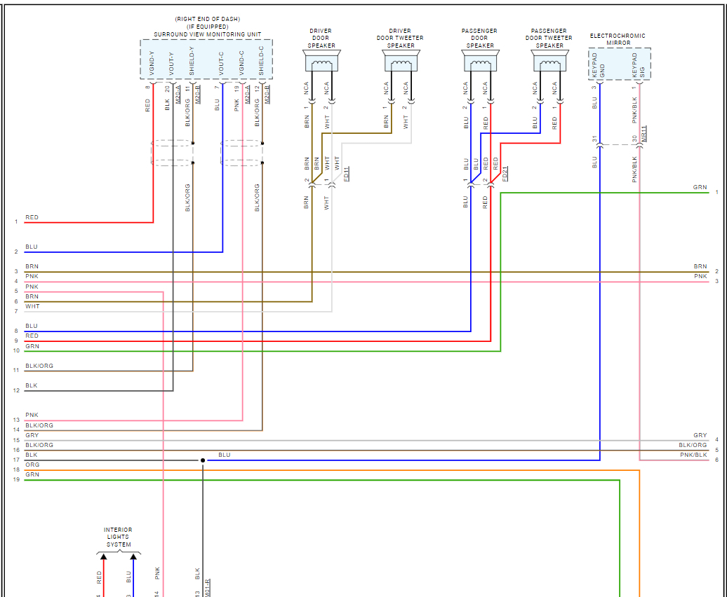

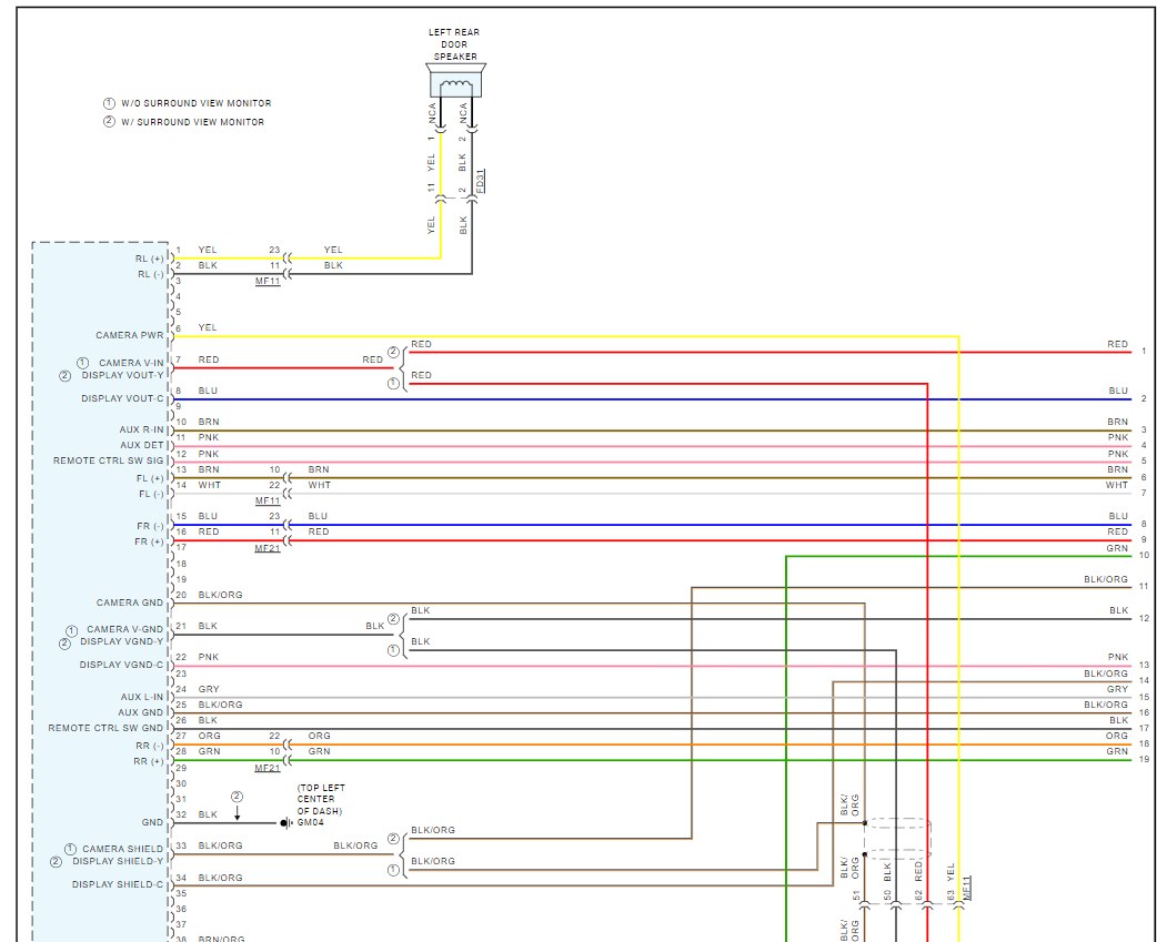

Looking for the stereo wiring diagram not premium?
2019 KIA SORENTO
76,000 MILES • 3.3L • V6 • 2WD • AUTOMATIC
EDUARDO GONZALEZ MEDINA
Need the diagram for the stereo so i can put in an audio control lc7i. The car is not the premium but still has a 7-inch display but no center channel or subwoofer.
Feb 29, 2024 at 1:55 PM
  • 54,840 POSTS
Sure, here are the wiring diagrams for the base equipped radio without the amplifier or subwoofer. Check out the images (below). Let us know if you need anything else.
