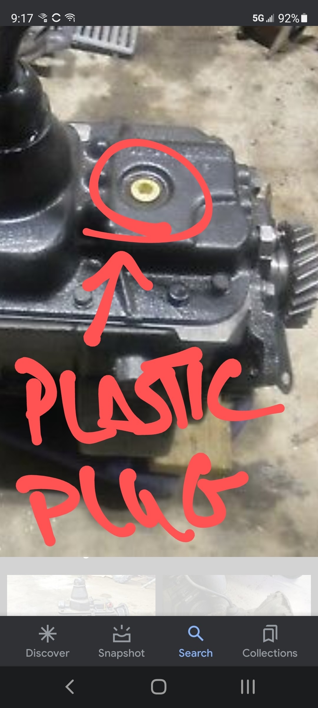

I'm mainly trying to focus in in a shift tower having the reverse switch mounted on the rear like in your pic.
A better full pic may help, it's possible this might be a modification/ or substitution.

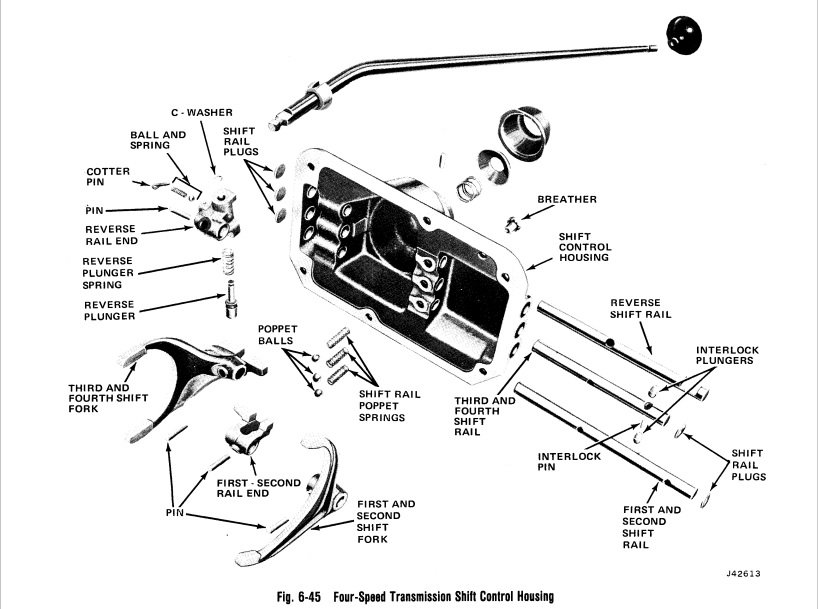

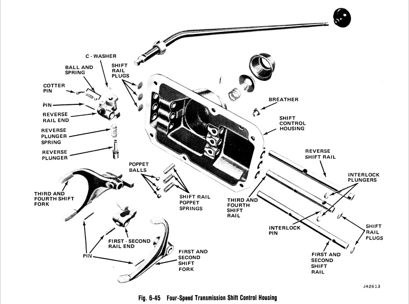

I did find this diagram for a T-18A, with parts/ pieces maybe popped loose and missing from your plug? It may have used to be this breather shown in the diagram. (Or not).
I'm wondering if it is a tapered plug, or a straight threaded plug? Is it shouldered to control how deep it goes in the hole? Plastic? Might a metal plug work without internal interference?

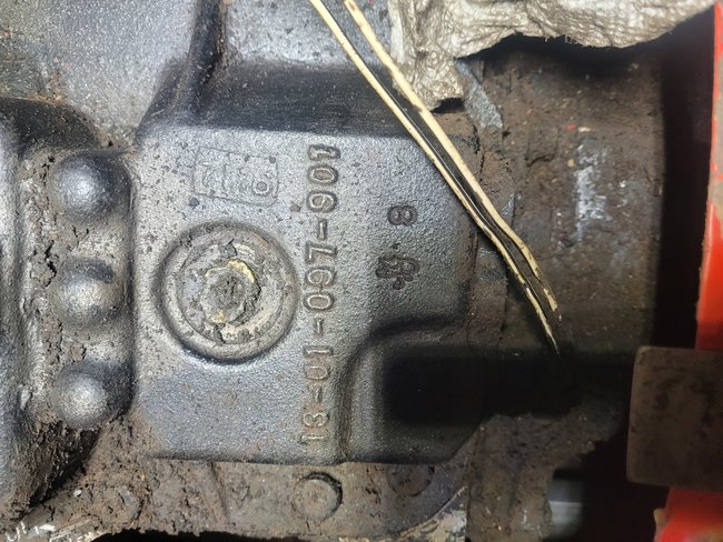

The transmission is a T18-1B and was made for and has been a Fire Department Rig its entire life. The hole is threaded, not tapered, and is shallow. The plastic nut was pretty much completely deteriorated but appeared to have a flange shoulder. There is only 1/4 to 3/8 of an inch before it hits a shift rail. It's not a vent hole as the breather is a little left and back of this main hole. I have nearly all the records and is OEM. The picture I sent I found in my research and is identical to mine. Here is a picture of mine. Still in the Jeep so it's the best I can do.
