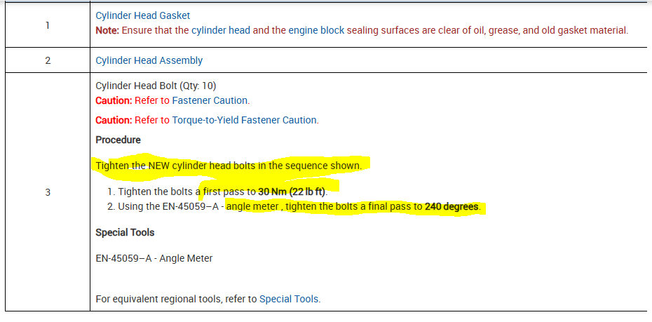

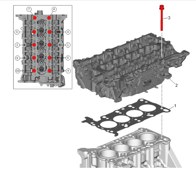

If you look below, I attached the directions for installing the head. Note: The directions (pic 2) provide the tightening sequence. Make sure to follow them.
Next, you have to do this in two steps. Once you have all the bolts installed, using the sequence provided, tighten the head bolts to 22 ft/lbs. Once that is done, you need to turn each bolt an additional 240° further.
