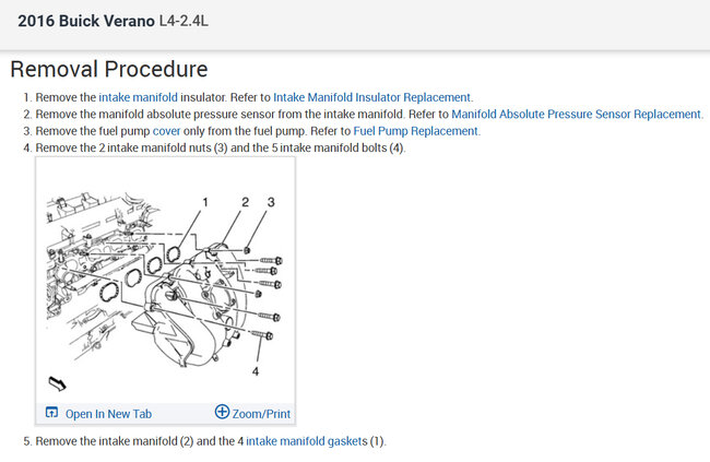

Hi! This car is unfortunately subject to a horrid PCV system. Which requires constant unclogging of a tiny hole in the intake manifold. Or the valve will fail (mine has most likely) causing crankcase pressure to skyrocket and blow gaskets (like me). I was hoping to get schematics on pulling the intake manifold and putting it back in. And how to replace the valve cover and any gaskets along with it.

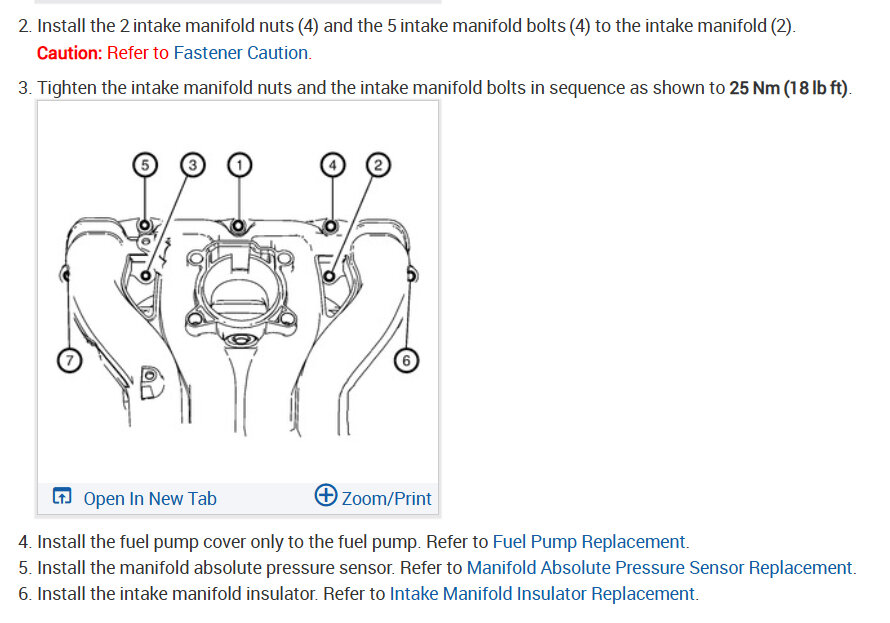

No problem, thanks for the information. I would start by disconnecting the battery. Here is how to remove the engine intake manifold. Check out the images (below). Please upload pictures or videos in your response.
