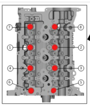

Can I get the cylinder head toque settings?
2016 CHEVROLET SPARK
215,000 MILES • 1.2L
PHILIMON
I need cylinder bolts toque specifications.
Dec 22, 2024 at 3:52 PM
  • 55,224 POSTS
These are torque-to-yield (TTY) bolts, meaning they stretch during the tightening process. They should not be reused. Always replace with new bolts.
Torque Settings:
1st pass 22 foot pounds
final - 240 degrees
Do not use chatGPT it is incorrect. Check out the images (below). Let us know if you need anything else.
