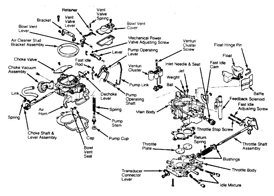

I took it all back down, and checked my float again as well.. as I read that is ultimately what controls mixture??? I feel like the float was so low when I opened it because I may have a dead mixture solenoid.. So putting the float back to proper has enriched it up. I don't know.
Does the electric mixture solenoid control all but idle and wot??
Is there anyway to test it??
Is the power valve the mixture solenoid??
Anything I can find on this carb is very vague at best.. and does a poor job of describing anything. All the literature talks to you like a Chrysler master tech lol.

there is nothing wrong with the plugs
Remove bowl vent cover and gasket. See Fig. 7. With all linkages installed, adjust idle speed screw so throttle plates will fully close.
Using straightedge, check clearance from top of accelerator pump lever to bowl vent cover surface. Clearance should be. 170-190 "(4.31-4.83 m). See Fig. 5.
Adjust clearance by bending pump link. Ensure wide open throttle can be obtained without linkage binding
I have no further suggestions......
