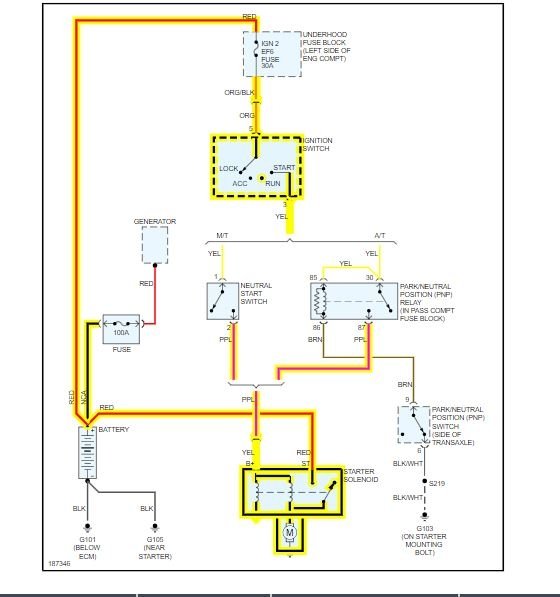

In the last week or so, random problems that I believe to be electrical have popped up, including the failing of the odometer and speedometer. Yesterday, After driving around 30 miles or so, I parked for an hour and a half and it would not start again, instead I could hear what I believe is the flywheel clicking, but the engine would not crank. I tested the battery voltage last week and it seemed fine. If anyone has a wiring diagram for this vehicle, I would really appreciate you sharing it with me, as I am currently at a loss and need my car for work.

First, I would load test the battery and make sure it has 12.6 volts. Without that, the starter will not work.
I attached the diagram for you to view as well.

Roy, thanks for getting back to me so quickly. While my multimeter it attached to the battery terminals, I am right around 12V, not exactly 12.6, but when I turn the ignition, I am getting no draw from the starter. May try to drop a new battery in just to test it, but I do believe it is simply time for a new vehicle, it's been a long time coming. I appreciate your help, and this website is awesome.
Mar 6, 2021 at 6:04 AM
Yes, at 12 volts, the battery is just about dead.
Replace the battery.
