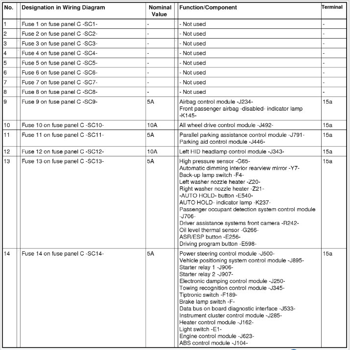

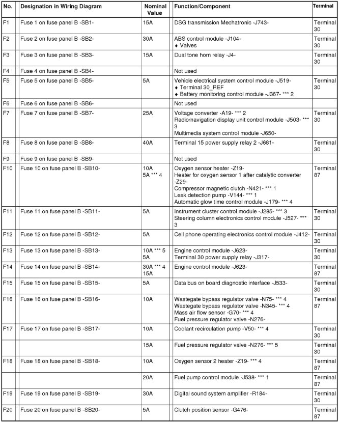

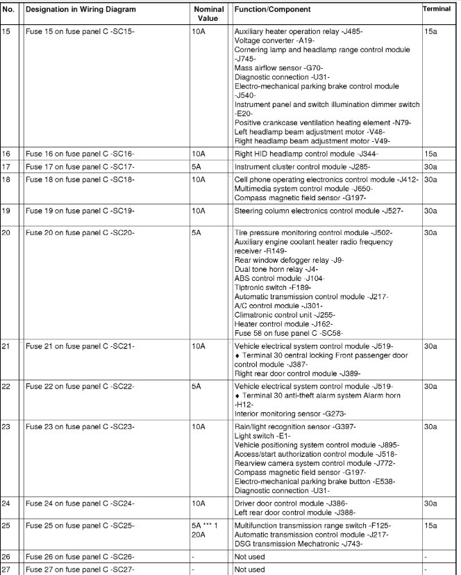

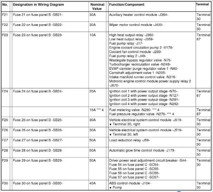

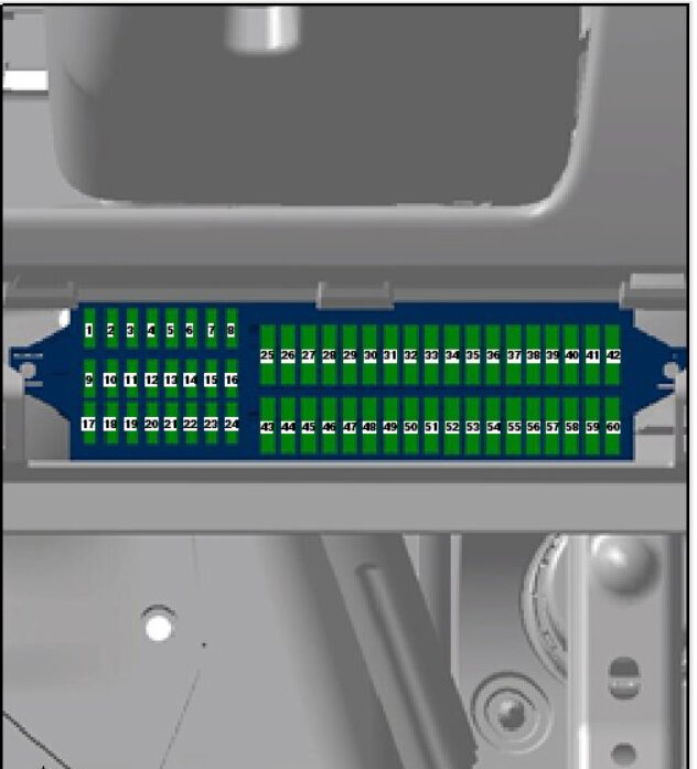

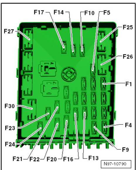

I need a description for all of.my fuse relays.
Sep 21, 2025 at 12:57 PM
Experienced Mechanic
55,746 POSTS
Sure, here is the fuse locations and assignments. This guided can help you with the testing as well.
Check out the images (below). Let us know if you need anything else.
