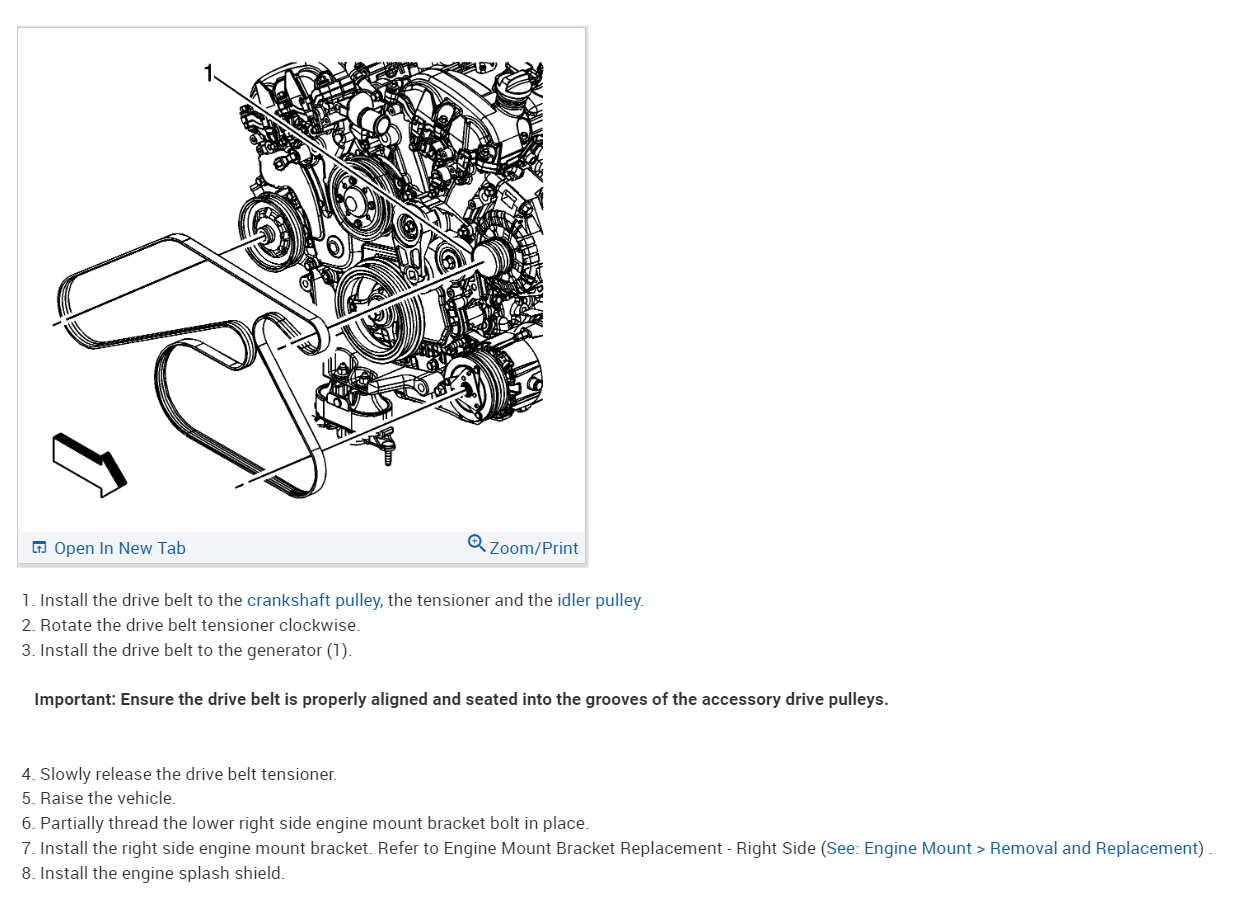

I replaced the alternator on my vehicle listed above GXP and I’m having issues getting the serpentine belt back in the right places.
Oct 16, 2022 at 3:15 AM
AL514
  • 5,667 POSTS
Hello, this is the drive belt routing for the all-wheel drive, although I don't think there is a difference for the front wheel drive. Make sure the new belt is the same length as the old belt, they do make mistakes with incorrect parts sometimes at the auto parts store,

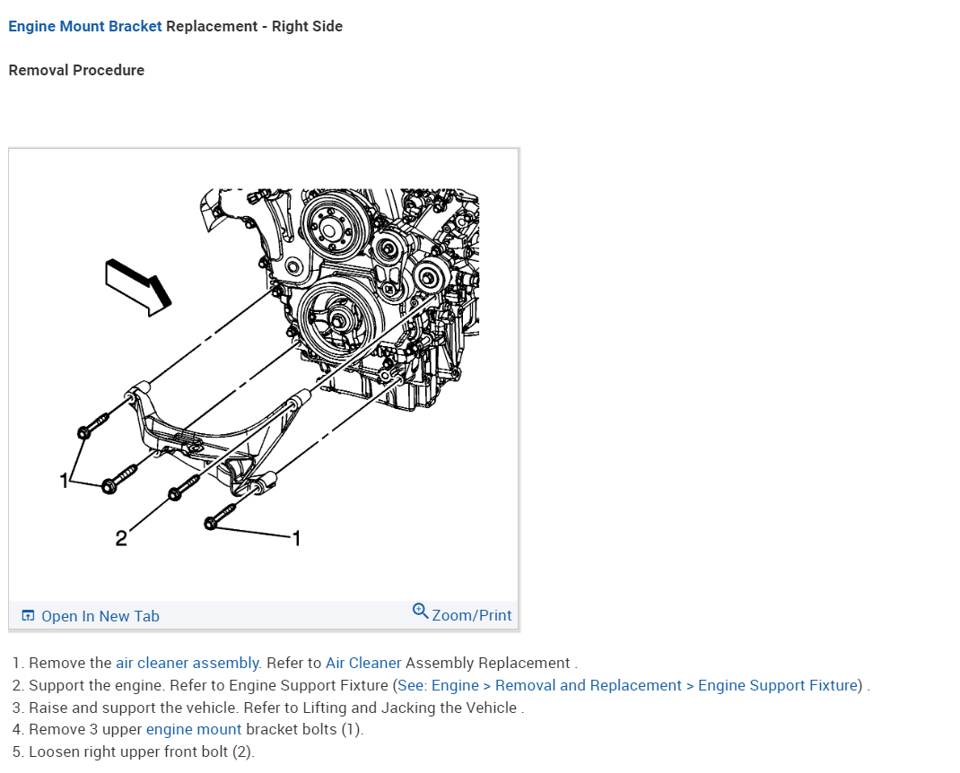

Did you have to move any of the engine support brackets?
They do mention having to move one of the engine mount brackets on the right side. This includes having to support the engine before removing the bracket.
