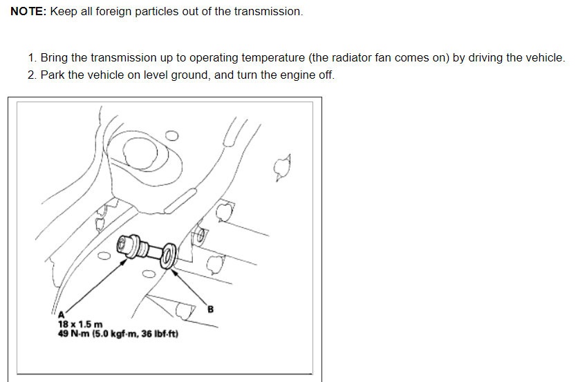

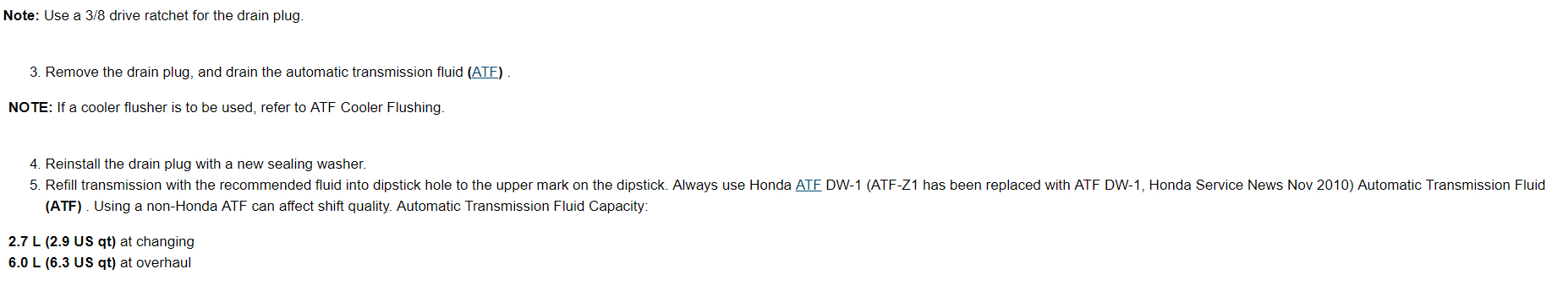

Where Is The Transmission Filter Located In a automatic 2001 Honda Civic EX? Do I have to replace it?
Thanks,
Pedro L.
Jan 6, 2020 at 5:09 AM (Merged)
  • 55,781 POSTS

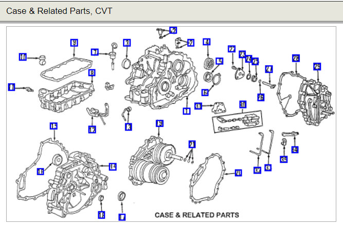

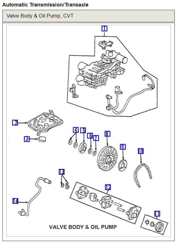

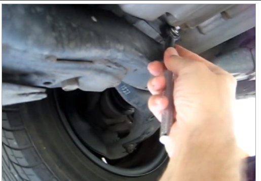

You do not need to replace the filter it is more like a screen on some cars will others have an external filter here is a video of the job being done.
https://youtu.be/pHPkHP4m0SM
The funny thing is though I see in the part explosion that there is a pan on the CVT units. Here is guide to help get the transmission serviced.
Check out the diagrams (Below) Please let us know if you need anything else to get the problem fixed.
