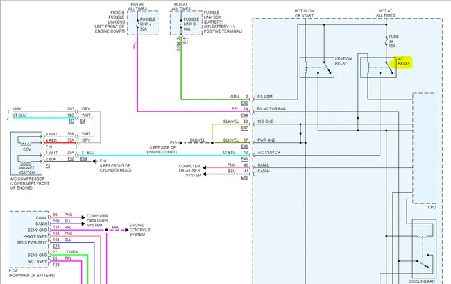

Where is the location of the A/C compressor clutch relay? Thanks
Jun 19, 2022 at 7:07 AM
  • 110,244 POSTS

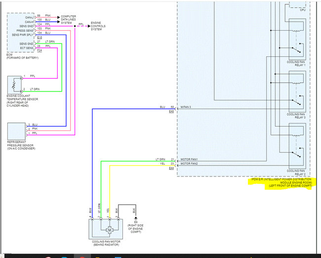

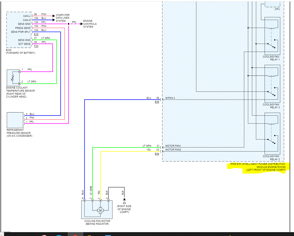

The relay is located in the IPDM (intelligent power distribution module). The IPDM is located under the hood on the driver's side.
I attached the wiring schematic below. I tried looking up a pic of the IPDM, but it isn't provided in my manual. There should be a label on the lid of the box.
