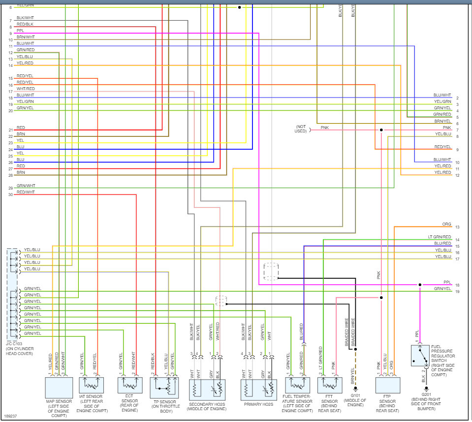

Turn the key fuel pump hums, PSI is above 40 crank delays and then runs. Replaced crank and cam sensors checked wires from sensors to ECM for brakes or corrosion nothing. Check and clean ground wires on engine and chase. Do get 3 codes P0339, P1298,P0141.

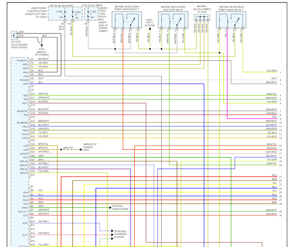

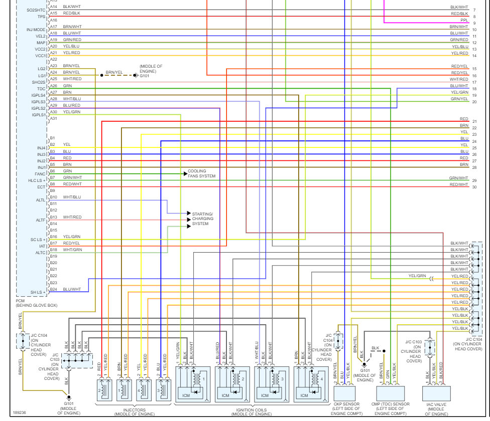

Replace the crank sensor and H2o sensor and now it starts soon but dies out on its own. The fuel pump is good, and PSI is above 40 when cranking. But I have to jump the relay. Checked for ignition power at relay and it's good but not getting the negative that the yellow/black wire needs? I moved relays around with ignition on and still the same. Jump relay = open the relay and push the tab towards the coil. Did send the ECM out and they found nothing wrong with it? If possible, to get the wiring diagram on the four relays behind the glove box?

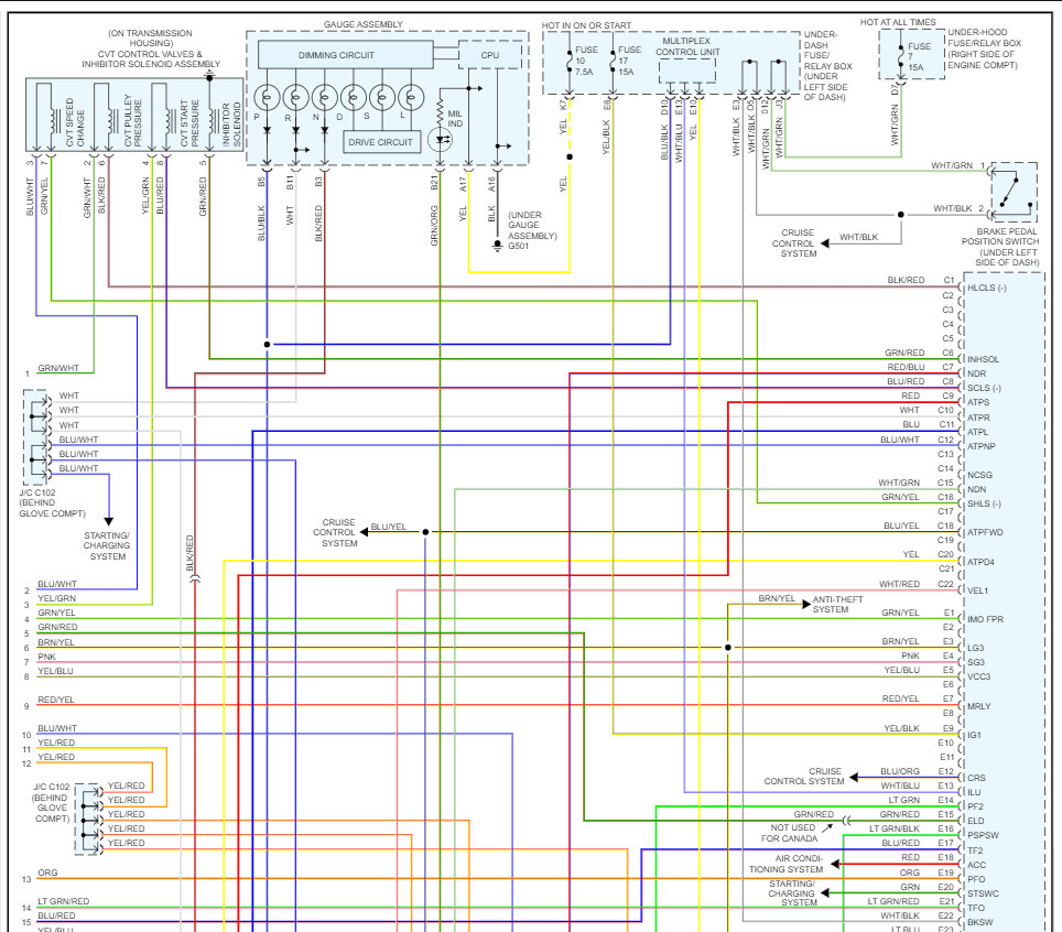

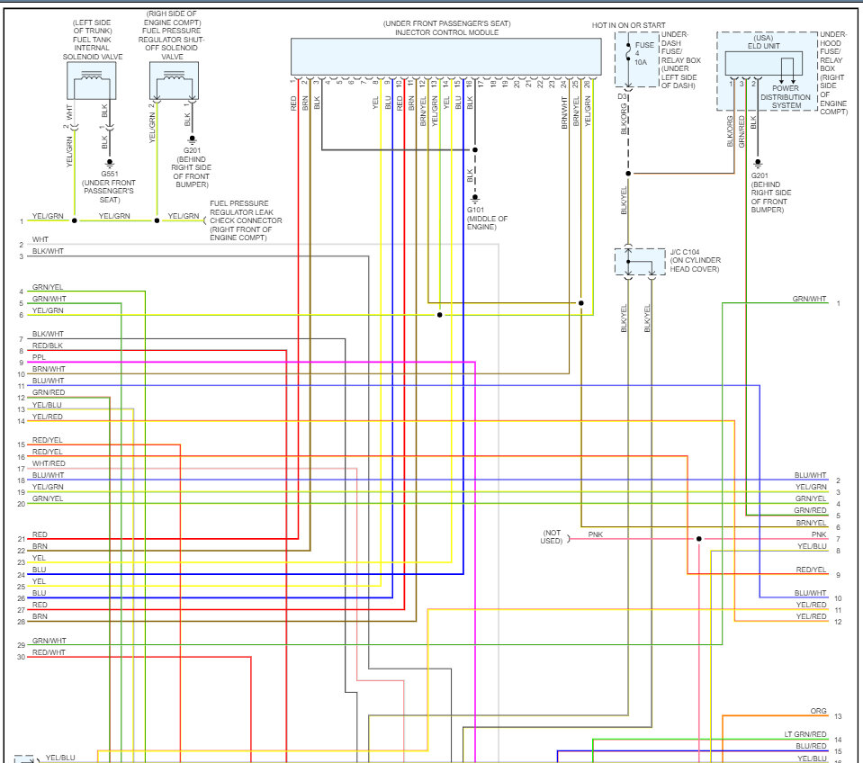

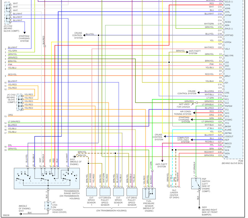

Does the engine still have the same codes, did you clear them? Also, here are the engine wiring diagrams so you can see how the system works.
This guide can help test the connections:
Jun 1, 2023 at 3:38 AM

Hello Ken, thank you for the wiring diagram. I replaced the crank sensor and also checked for current at the fuel pump relay, now the fuel pump is not turning on when the ignition is turned on or cranking and came to notice that the wiring diagram you had shared does not match to what's on the car.

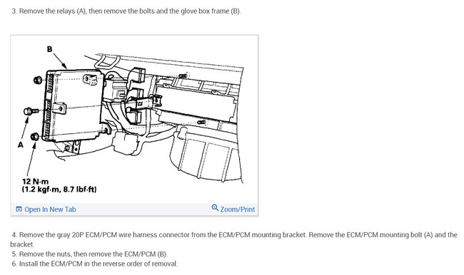

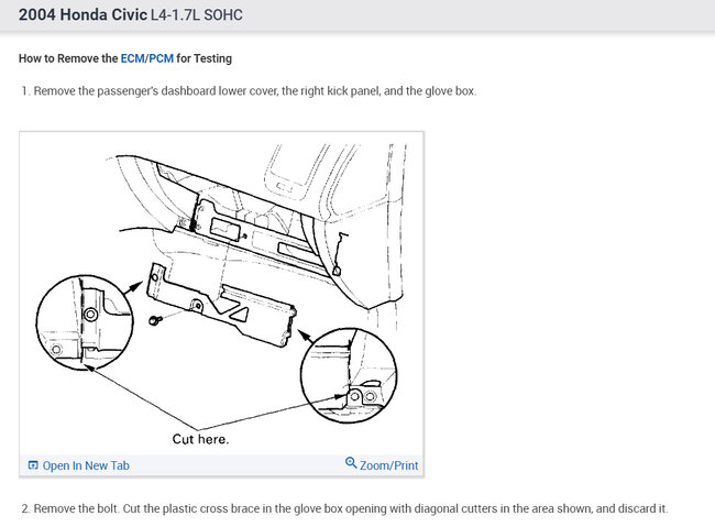

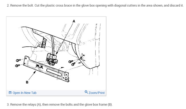

This should give us a better idea of the problem. Here is how to change the PCM out in case you get a code for it, you can get a preprogrammed unit by searching Google or Ebay.
Jun 19, 2023 at 4:16 AM
