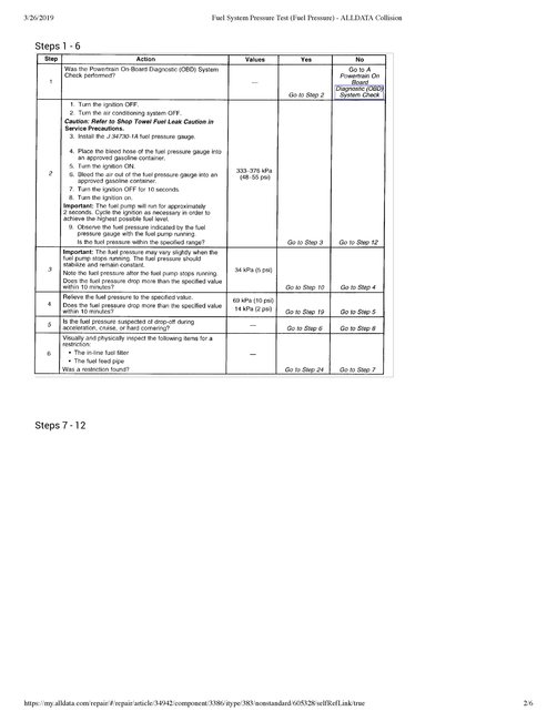

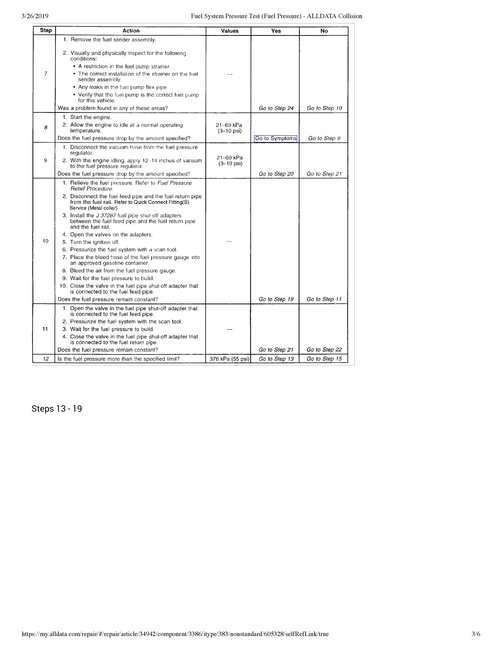

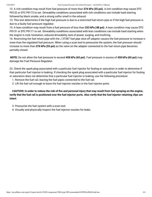

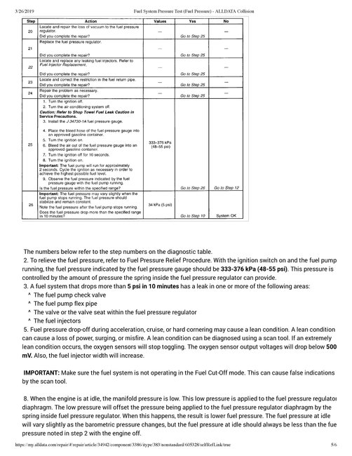

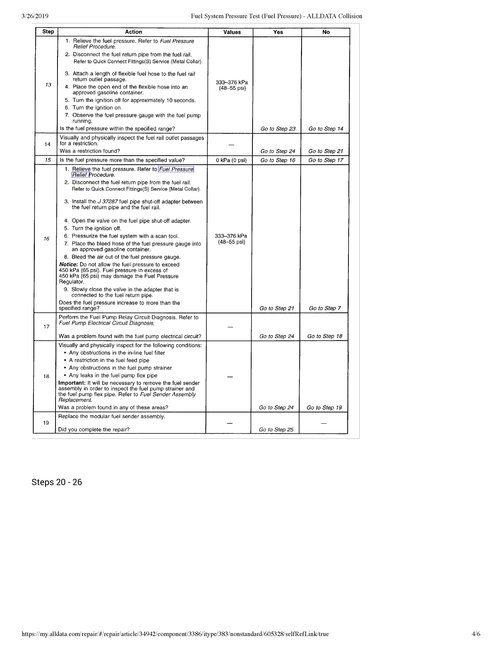

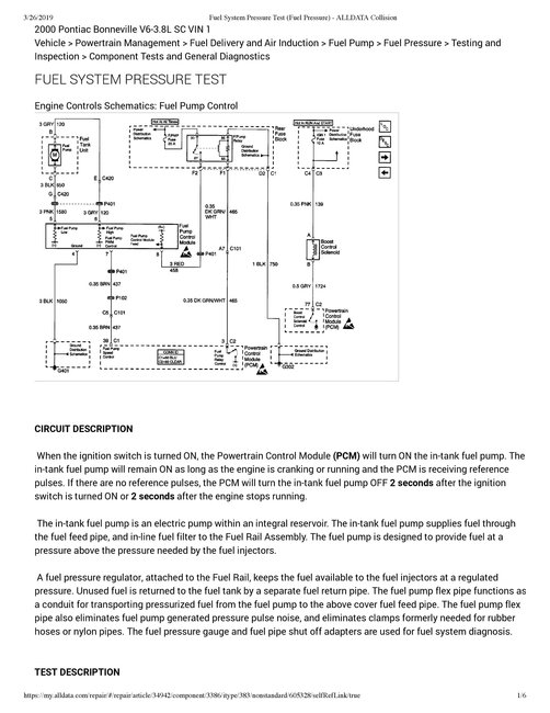

It sounds like the fuel pressure is leaking back to the tank when the engine is off.
If you have the engine running and then switch it off, right after try and start it again and see if it has the same long crank.
If not then this may be the problem.
I have attached a guide to checking the fuel pressure system on your vehicle with a diagnosis chart.
Have a read through this and let me know if you have further questions.
Regards, Joe
