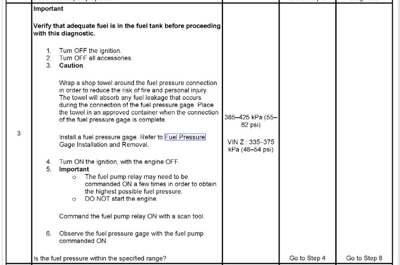

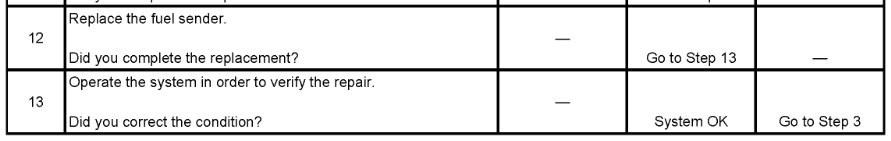

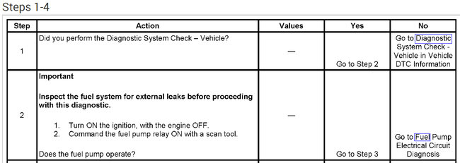

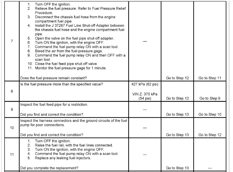

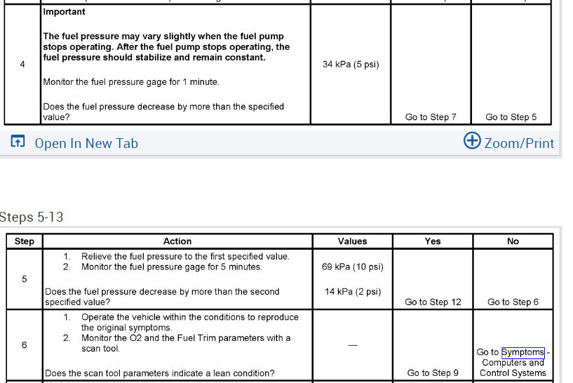

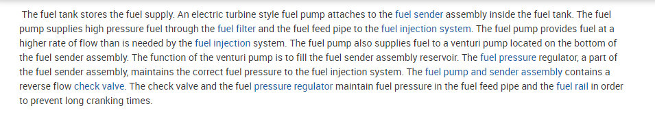

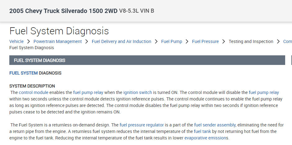

Based on what you described, it does sound like the injectors are leaking. You can do what is called a leak down test on them to see how quickly pressure drops off.
I attached the diagnostics below. Take a look through them and let me know if this is something you are comfortable performing.

Thanks. I will have my mechanic do that. It could be bad injectors...probably from overseas in the first place. I'll ask him if he's done the leak down test and see if he has and maybe we can nail this situation down soon.

You are very welcome, Tim. Let me know how things turn out for you or if you have other questions. Also, it may not be a bad idea to confirm the fuel pressure regulator is working properly and that the new injectors are the same as the original ones.
