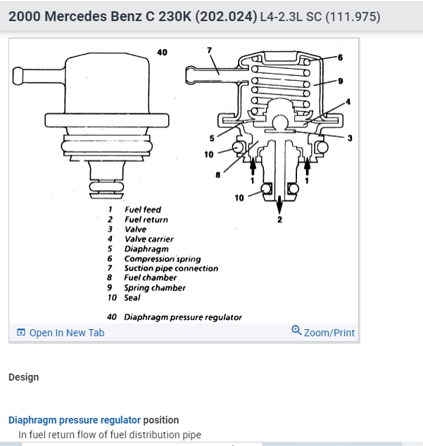

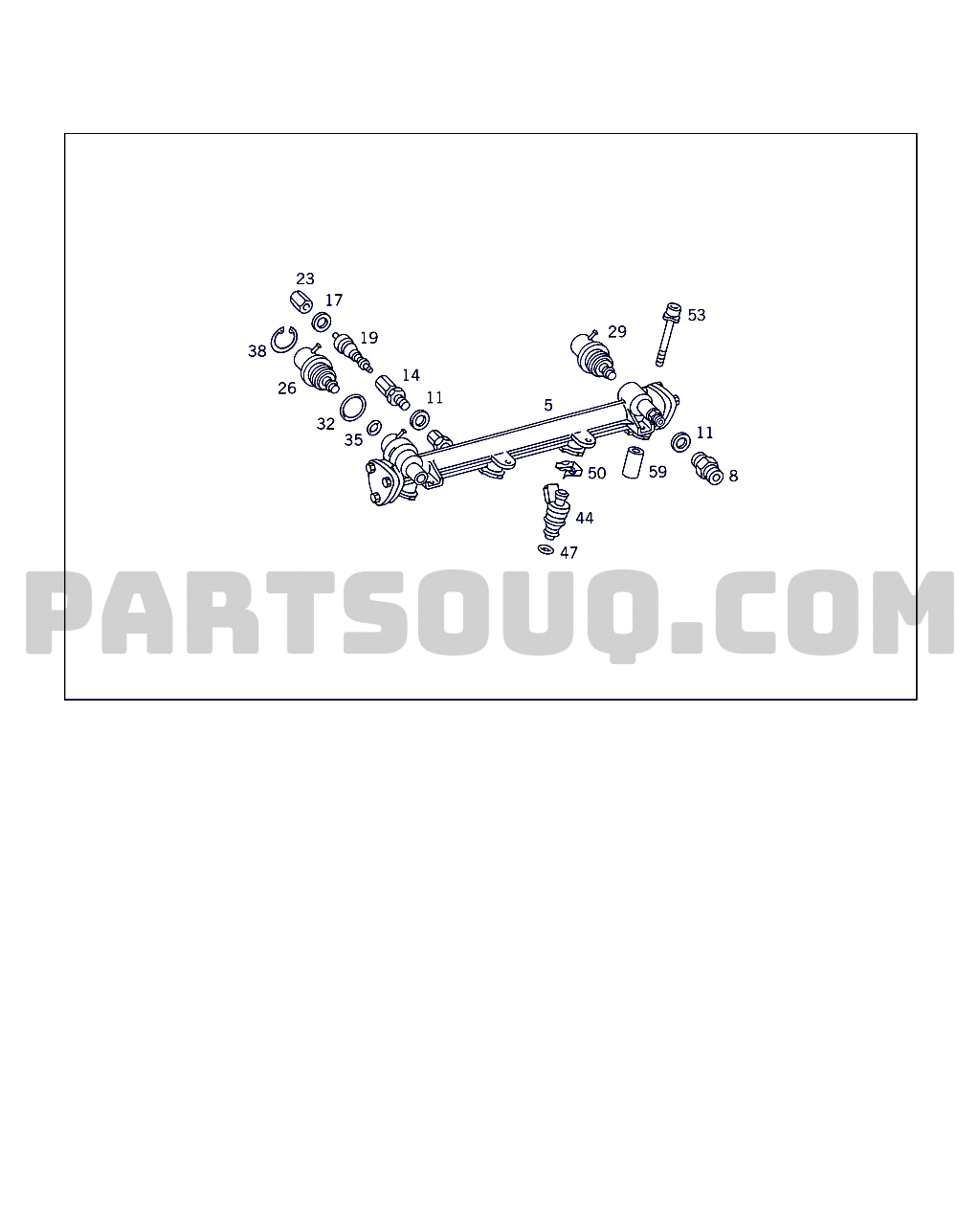

Does the vehicle start normally performing what I mentioned at all times? If it does, then it is more likely that the fuel pressure drops off and requires the pump to repressurize the system.

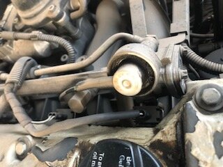

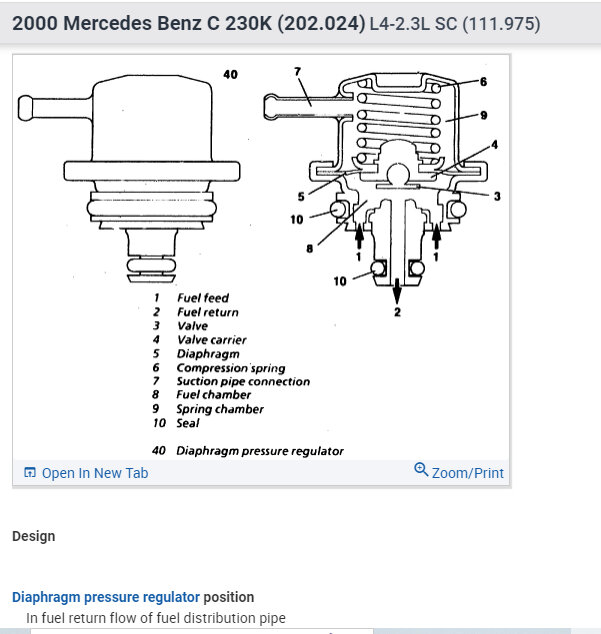

As far as a regulator, it should be on the fuel rail. I attached the best pic I could find below. Let me know if that helps.
See pic below.

Yes, the car starts normally after performing the procedure stated above. The car seems to jerk as well after a while, so yes, I think it has to do with fuel pressure somehow. Thank you for the image, I have found it. I'll check it out and report back what I find before proceeding with repair. On that point, is there a way to test? Also, is there a way to repair it, or straight replacement is the only way to repair?

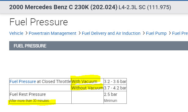

If it is bad, it will need to be replaced. Also, there will be a vacuum hose on it. Disconnect that hose and check to see if there is any evidence of fuel in the vacuum hose.
Here is a link that explains how to test fuel pressure and the regulator:
Also, I attached the manufacturer's fuel pressure specifications below.
Let me know what you find.
See pic below.

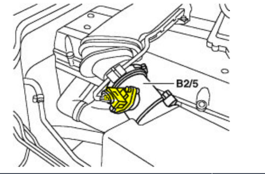

I would think fuel pump pressure would regenerate without turning the key off. To me, and this is a theory, it could be related to the mass air flow sensor.
If you disconnect the MAF, it should force the computer into preset mode. Try disconnecting it and check if it shuts off at 4,500.
See pic below.

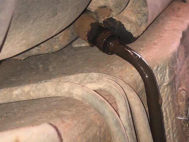

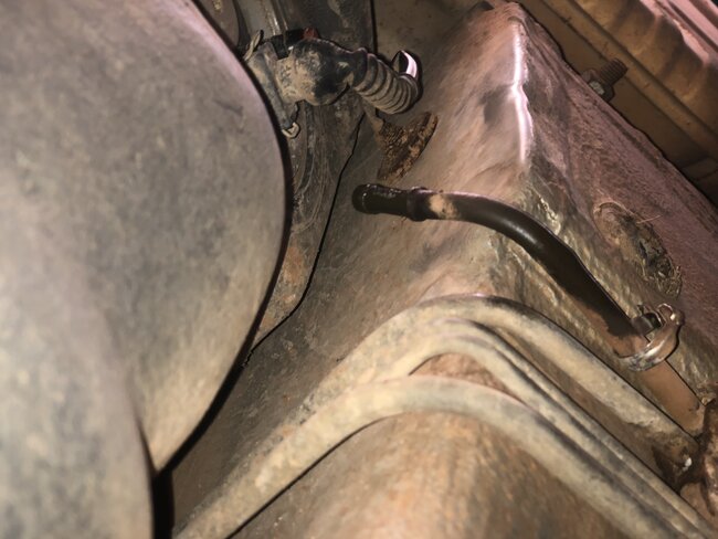

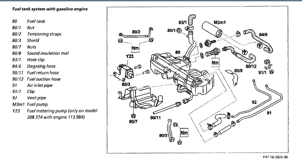

I have yet to attempt the unplug as stated above, but also when I started the car last time, I learnt it had a fuel leak, left side just ahead of the rear wheel. I found out it is a common issue with these cars, but I'm not sure what exactly is leaking. I’m planning to Jack it up and have a look.
Regards,
Jan 2, 2023 at 9:06 PM
  • 110,194 POSTS
A fuel leak will certainly cause a delayed start. It could be a few things in that area. I attached an exploded view of the fuel tank and hoses so you have a reference.
See pic below.
Jan 3, 2023 at 7:44 PM
TUKZ86
  • 28 POSTS

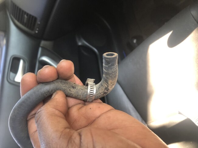

Got the pipe out, downstream of 90/11 on your image. Can’t really tell what’s damaged, so will just replace the hole rubber pipe and new clamps and will let you know.

That is certainly a leak. Make sure you inspect the steel pipe and make sure there isn't a rust issue that made a few tiny holes.

All checked, and all looks good. No leaks at all now, and all clamps seem to be holding. Thank you…

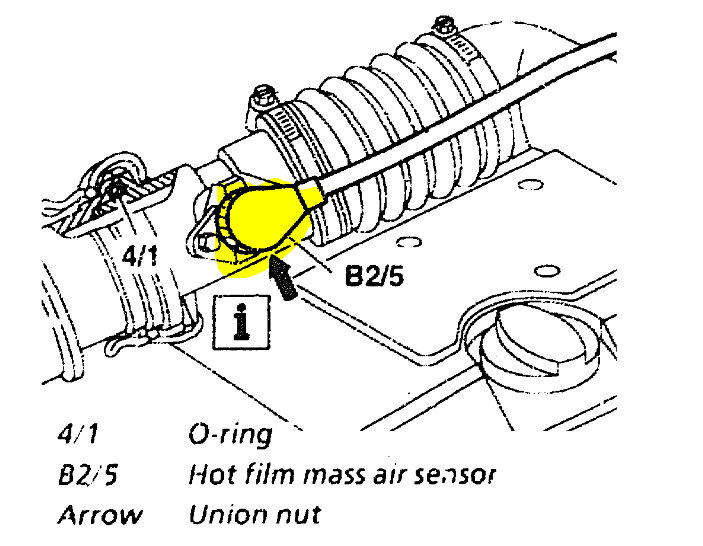

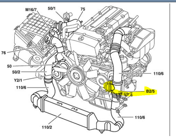

Now, back to the MAF Sensor: is there a better indication as to where it is?
Jan 4, 2023 at 7:41 PM
  • 110,194 POSTS
Thanks for the update. I'm glad to know that it is fixed.
As far as the mass air flow sensor, it could be in one of two places based on the engine you have.
If the engine does not have a supercharger, it will be in the air induction tube between the air filter box and the throttle body. See pic 1.
If the engine does have a supercharger, it will be in the charge air tube after the intercooler and before the throttle body. See pic 2.
Let me know if this helps.
