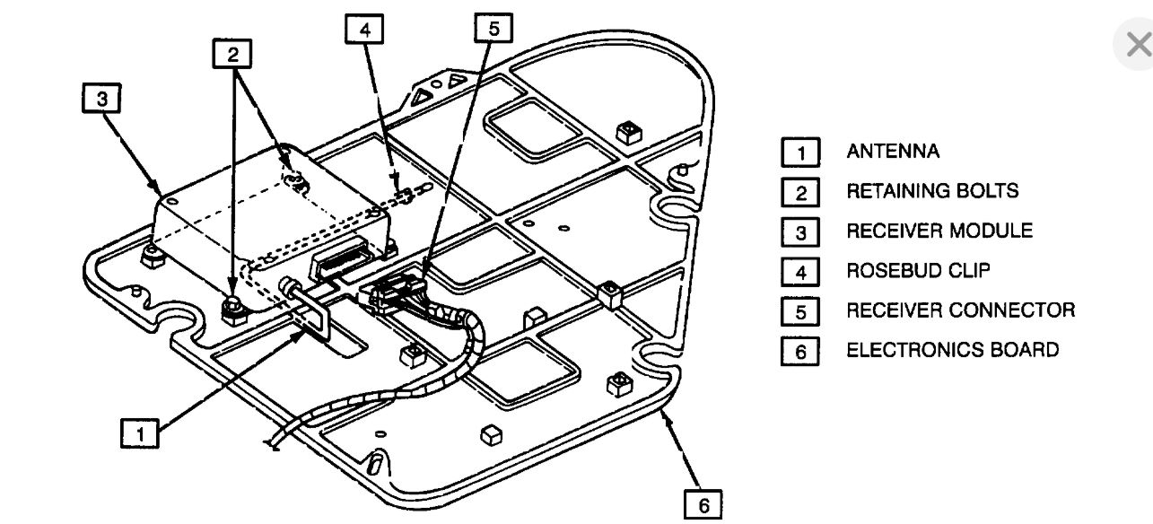

Hi Roy, if you get duplicate replies, I apologize. It's the door locks on all doors that don't lock or unlock the lock or It did work before. The rke module does click when fob is depressed. Yes I did depress key fob, for longer than 2 seconds. Plus when I press trunk button in car, that does not work either.
Mar 22, 2020 at 9:29 AM

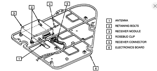

It does sound like the module may be receiving the signal but not sending a signal to the BCM.

The only ground wire is the one you already replaced.
Looks to be the module from what you have posted.

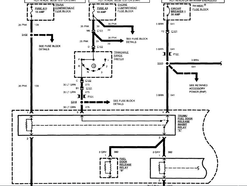

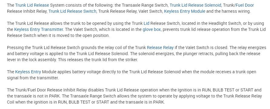

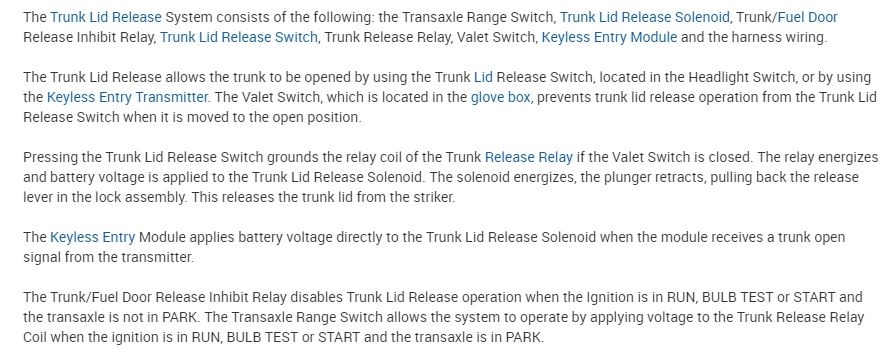

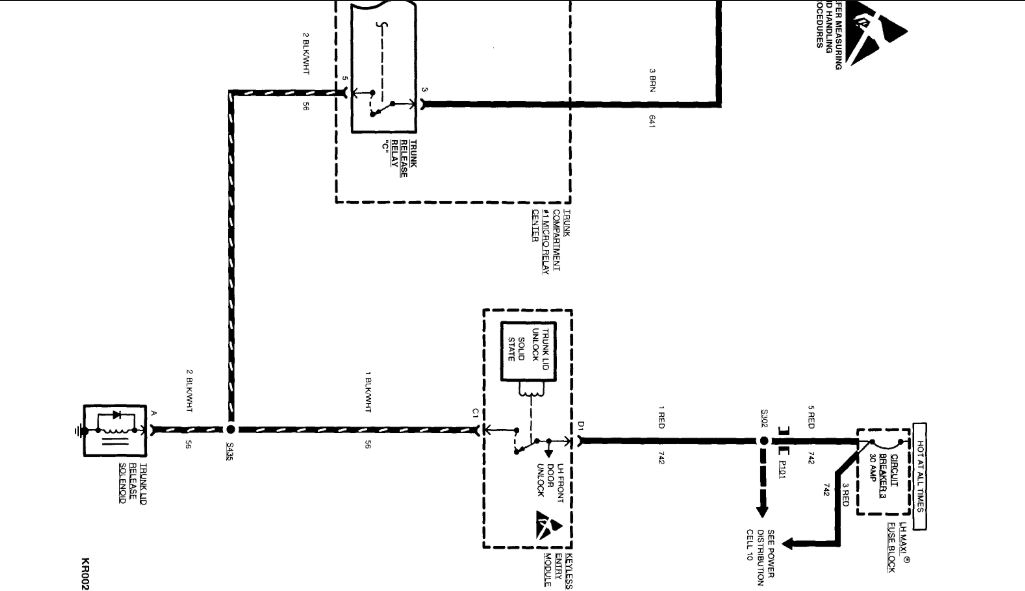

So which wire is providing the trunk release power? I am assuming it's the black wire with white stripe, that goes in solinoid of trunk release.
Mar 22, 2020 at 2:23 PM
Correct, as per the diagram, the black/white would be the trigger wire.
The antennae receives the signal and sends it to the module. Then the module sends the command out to the release.
Mar 22, 2020 at 2:41 PM

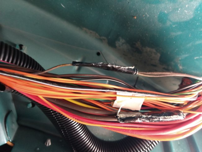

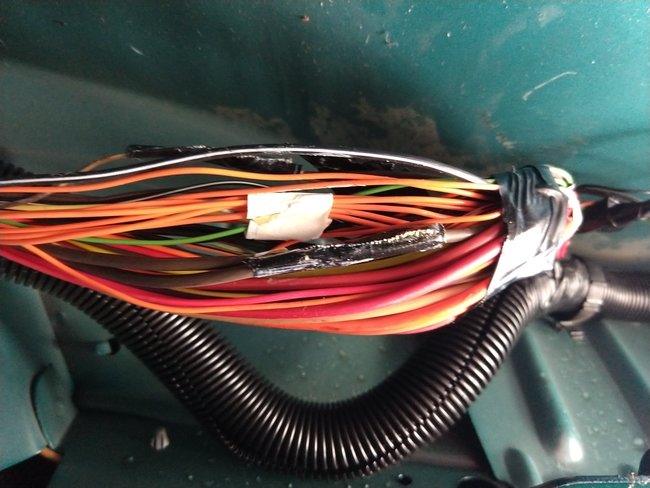

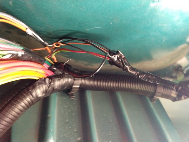

Okay, thanks a lot for your help Roy. I just got back from dinking with it. Found a mess. I did find the ground was severed. So I put that back together. And guess what, the trunk light works now. Locks and trunk release, do not work. I did a lot of work on that car myself, the water pump, radiator, heater core. All in like a month. Now electrical, I still don't know how to read and the settings on voltage meter. So I did shock myself a couple times. I noticed a lot of wires had been repaired. Just with electric tape. So I am going to check and redo with shrink tube. Now I did find a couple things. Now the 3 wires going to front of latch. I put the test light to each one. The light did not go on for the red one. The other thing is when I ground the test light and then touch any metal on car the light goes on, bright. Does that mean that red wire is touching metal in car somewhere. Now on the other side I found 2 more boxes, both with relays. One is the antenna, I don't know what the other is. Is there a trunk release relay under glove box? Thanks For putting up with me Roy. Much appreciated.
Mar 22, 2020 at 5:45 PM
Okay, can you post some pictures of what you see?
Solder and shrink wrap is the best way of repairing the harness. Butt connectors are not a good repair although they are quick. Outside environment gets into the connection and corrosion is the result.

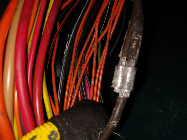

Okay, the thick brown one going to 2 thick brown, shocked me. There is 1 brown going to 3 brown. I will solder and shrink tube.
Mar 23, 2020 at 12:33 PM
Wow, somebody did a really poor wire repair.
Yes, solder and shrink wrap all those wires back together again.
Mar 23, 2020 at 12:36 PM

This connector looks pretty solid. Plus it looks hard to get undone. Why are wires still have power. I disconnected battery?
Mar 23, 2020 at 12:53 PM
No, it is exposed to outside environment. You need to redo it completely and solder and seal it up.
Mar 23, 2020 at 1:09 PM

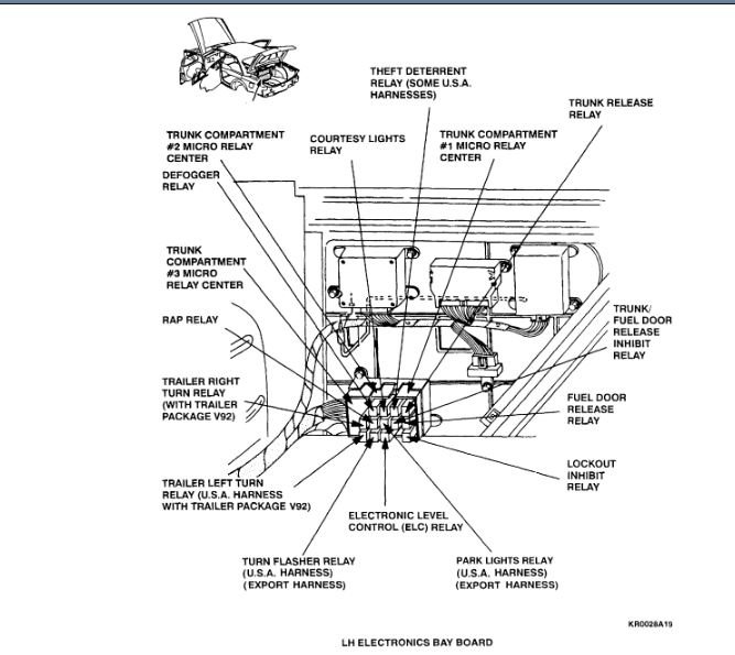

I had gloves on. It took me 4 hours to do 3 wires. I do not solder well at all, I probably made more of a mess. But it is what it is. So where is the trunk release relay? I am going to follow the red wire today. The one that had no power. Looks like that one is coming from fuse box.
Mar 24, 2020 at 10:12 AM
In the rear fuse/relay block in the trunk.
I attached a picture that identifies the location.
Mar 24, 2020 at 10:16 AM
