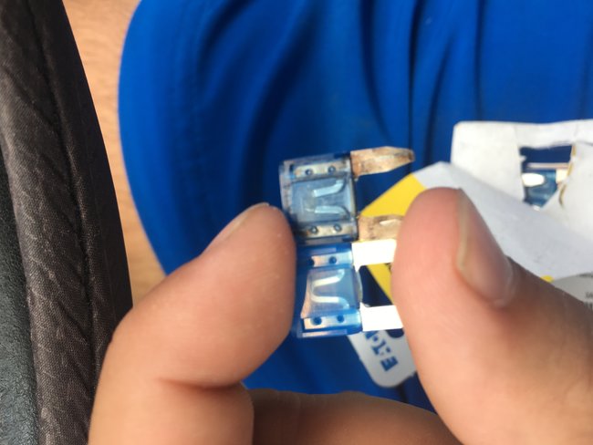

My car has automatic locks and I changed the door with one from the junkyard, but now the locks don’t lock together and the sunroof doesn’t work. what do I do?

Did the electrical connectors match up? Lets test fuse # 15 lets start there and here are the door lock wiring diagrams so you can see how the system works and the fuse location:

Old one looks burnt out. replacing it see if it works.

Only sunroof works now. locks still doesn’t lock all doors.
