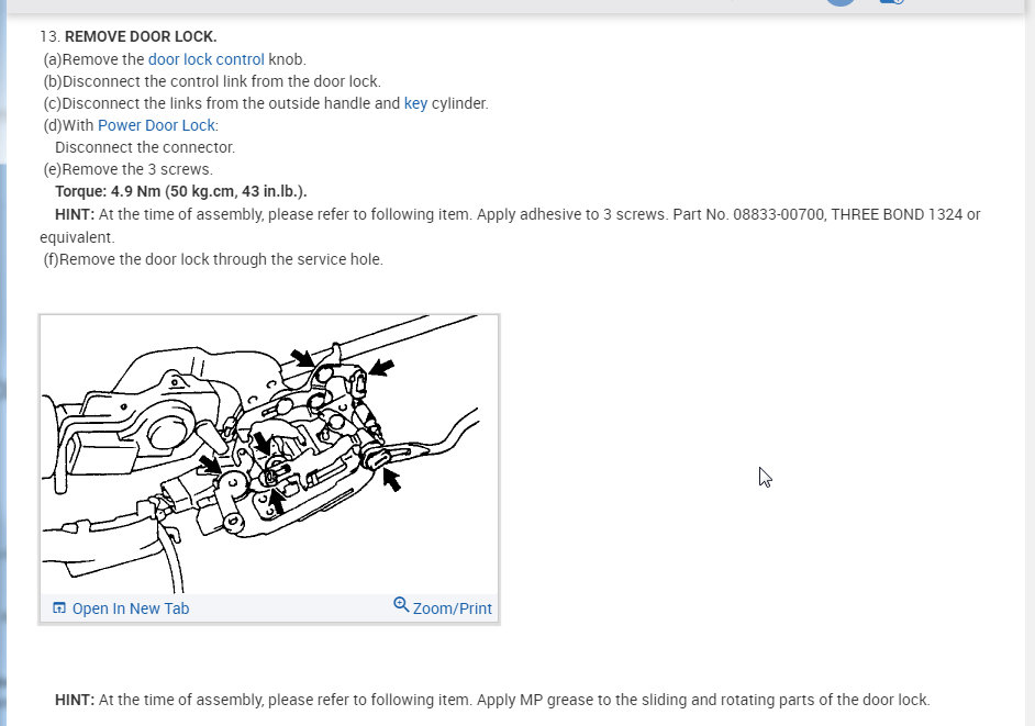

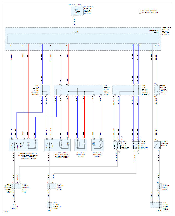

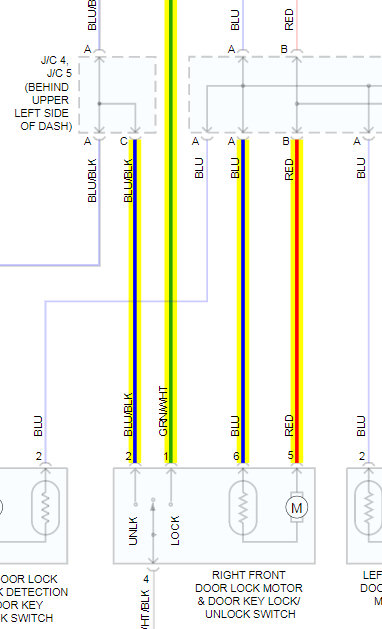

Okay. I suspect the actuator is the issue. We need to confirm this by putting a voltage meter on the wiring on the diagram shown and operate the locks. Then as long as you have voltage then the actuator/lock assembly will need to be replaced.
