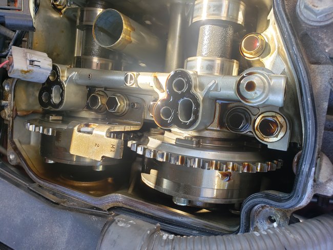

This car was on the side of the road. Apparently it just quit while driving and will not start. It attempts to start and everything turned so we had it towed back.
When it arrived the battery was toast so I bought a new one. The computer is throwing codes saying camshaft position sensor "B" has high input voltage, also Camshaft position sensor "B" performance.
Tried to start diagnosing the issue by checking voltage at the connector for that sensor, got 5V at the reference circuit, and shortly after starting it with a new battery a loud bang happened and the starter smoked. So I put in a new starter, and that blew up immediately. Took it back and got another, and the new starter just hits really hard but the motor isn't turning anymore. I tried jacking up the car with both wheels in the air and transmission in Neutral to turn the engine by hand at the crank and it will not budge, even with the spark plugs out

If it will not turn by hand then yes. It is locked up. I would pull the plugs and use a borescope and look in the cylinders for any damage. If it look rusted, you can use penetrating oil to try and break it loose. However, if this just happened then I suspect the crank is seized due to lack of lubrication. This could be due to a failed oil pump or lack of maintenance.
At that point, you need to drop the pan and see what is going on inside the engine. Let me know if you have other questions. Thanks

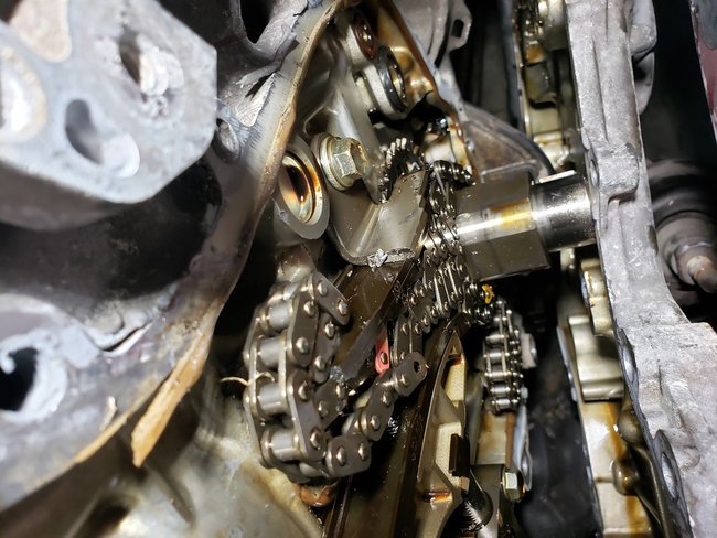

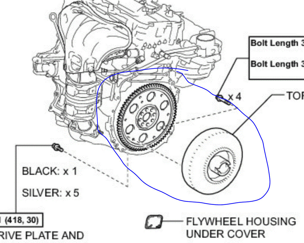

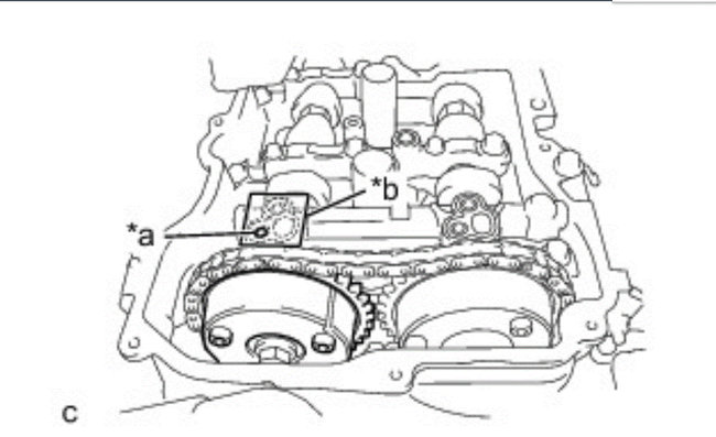

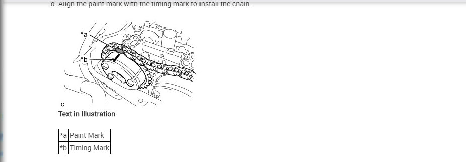

Something locked up, but since you experienced the starter issues, the first thing I would check is the flywheel/torque converter to see if a bolt has come loose.
If nothing is apparent there, remove the valve cover and inspect the timing chain to make sure nothing has come apart.
See pics 1 and 2 below.
Sep 5, 2020 at 11:07 AM
CANNON1349
  • 861 POSTS

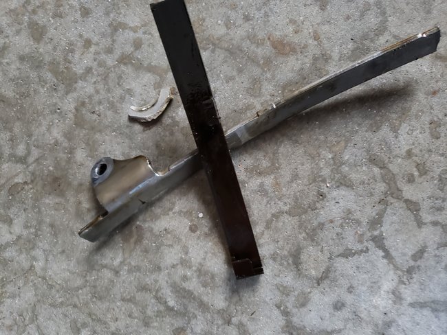

Well... Looks like the timing chain broke... Wow. On 150,000!!

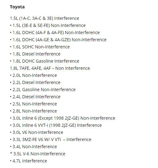

So at this point I guess I need to know if this is an interference engine or not, and where to go at this point.
Sep 6, 2020 at 12:25 AM

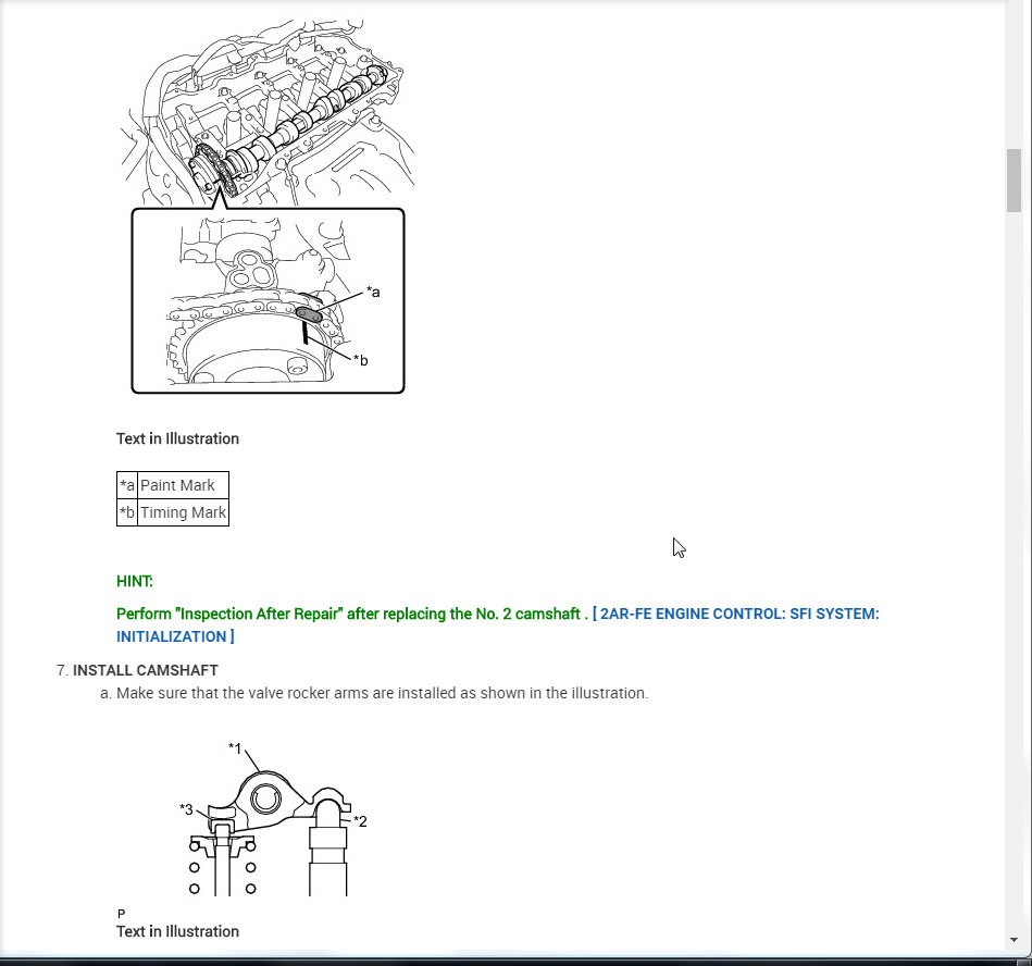

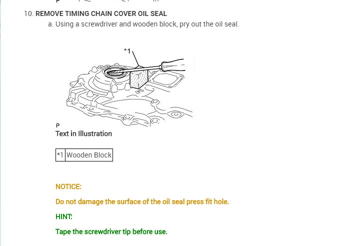

Okay. Good idea Joe. At this point I show this is a non interference engine (see attached) so I imagine the chain is bound up around the crank not allowing it to turn. So you need to remove the front cover and remove it and reset the timing and install a new chain. Clearly once it is removed, turn everything over and make sure it spins freely.
Sep 6, 2020 at 1:25 AM
CANNON1349
  • 861 POSTS

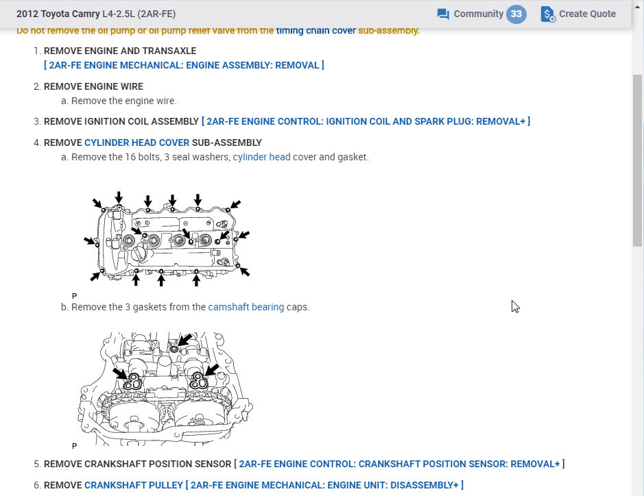

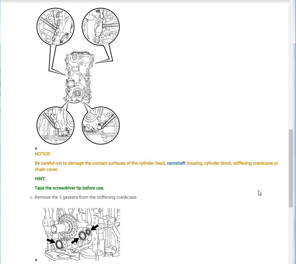

But the real question is, why did this chain break so early? This is almost unheard of in a Toyota. And what is the procedure for removing the timing cover and resetting the timing?
Sep 6, 2020 at 1:28 AM
Unfortunately, I think you said the key term, "almost" unheard of which means it is heard of even though it is rare. Unfortunately it appears you have one of the rare ones. These timing chains just fail at times. It could have been just a weak link in the chain that took this many miles to finally fail.
I attached the procedure for your review.

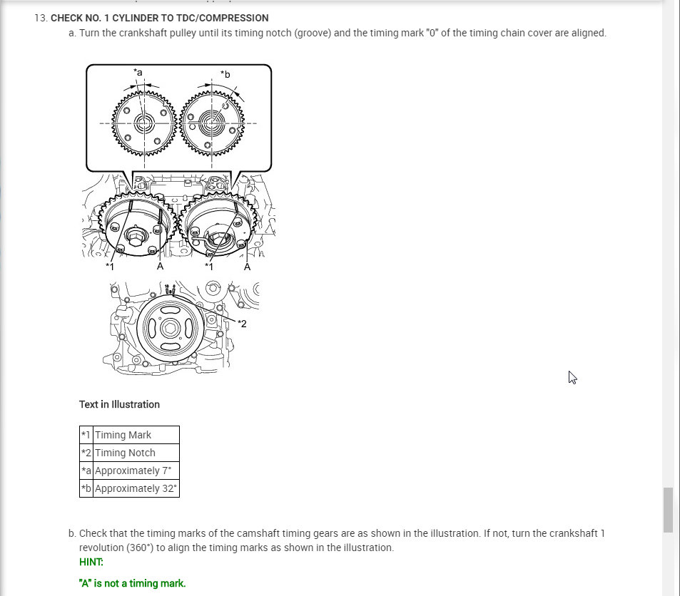

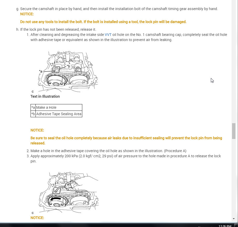

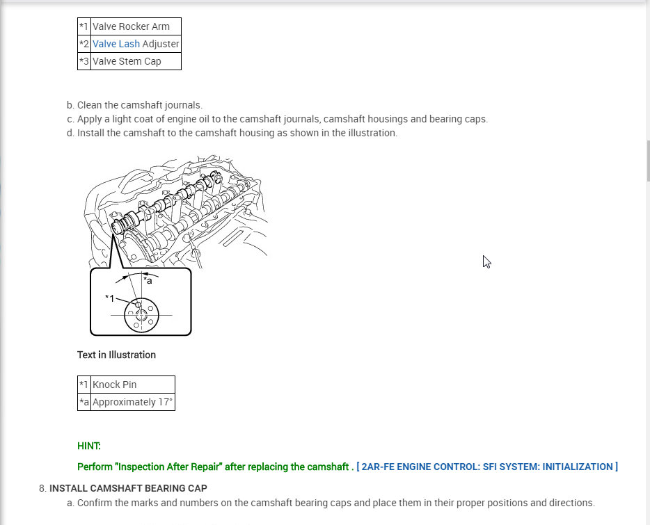

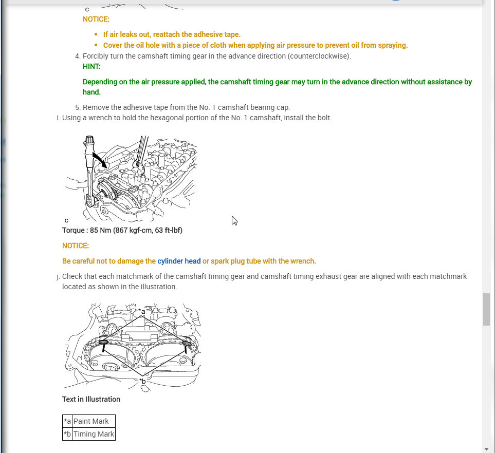

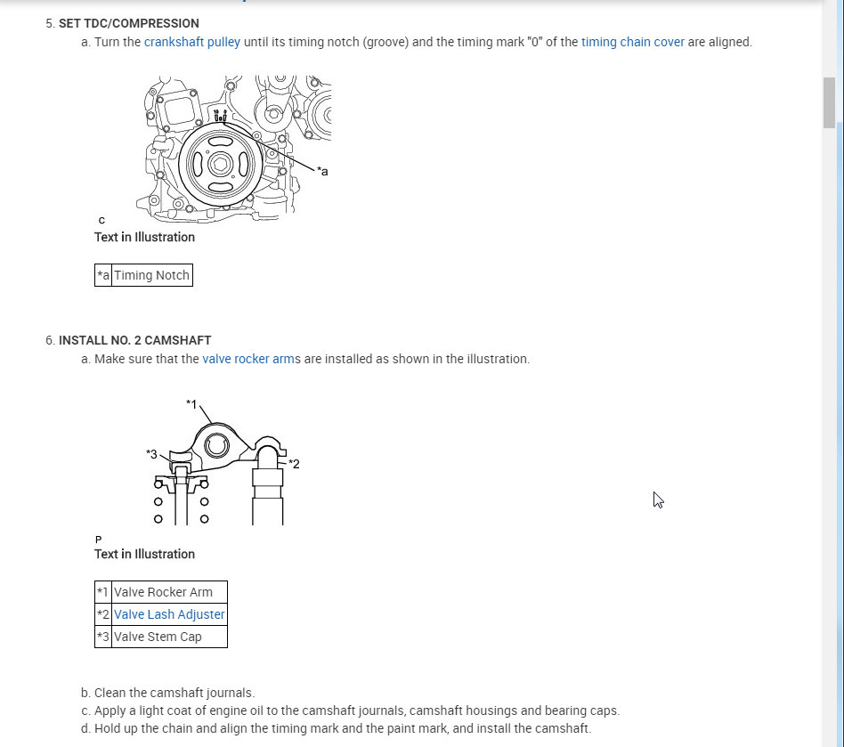

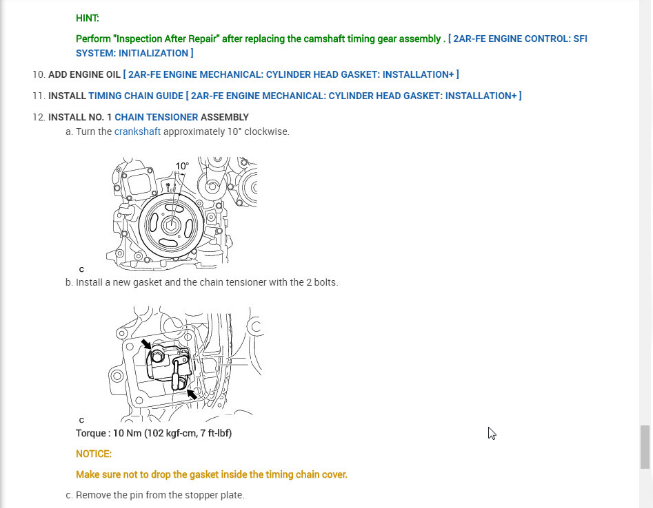

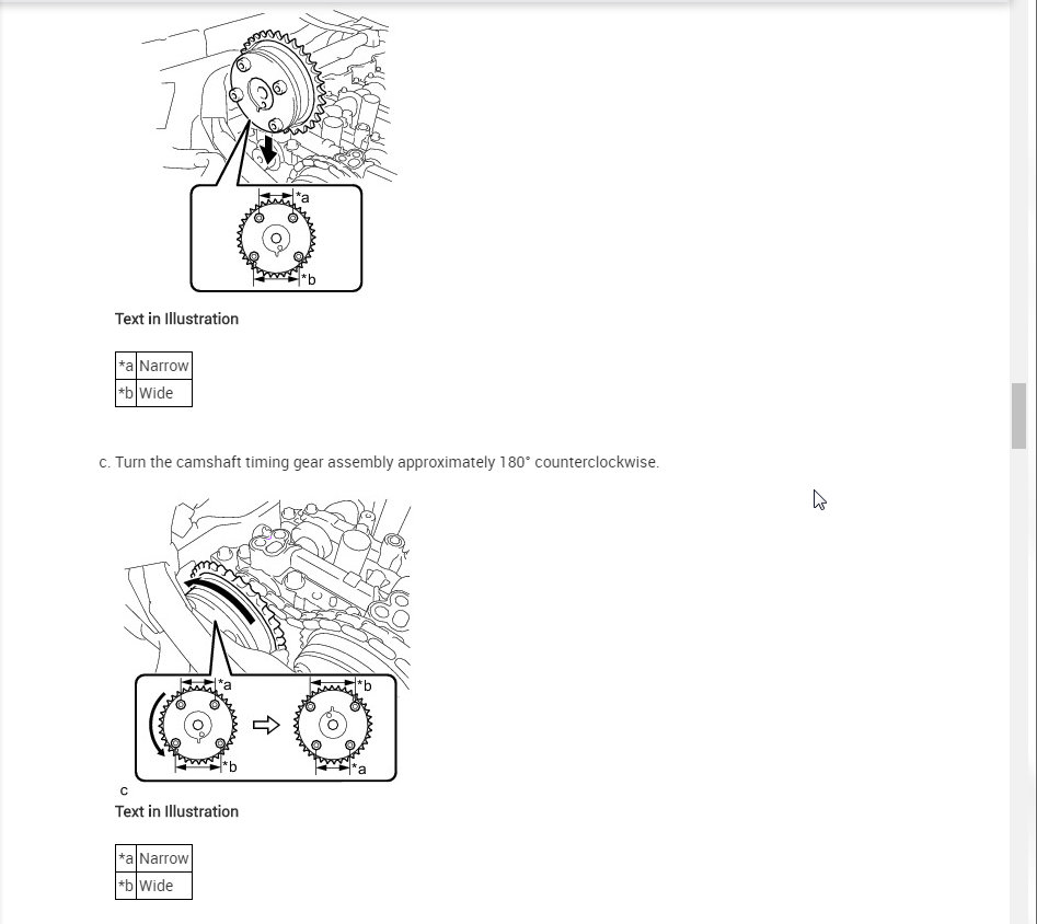

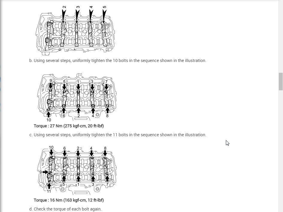

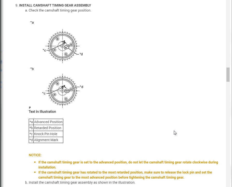

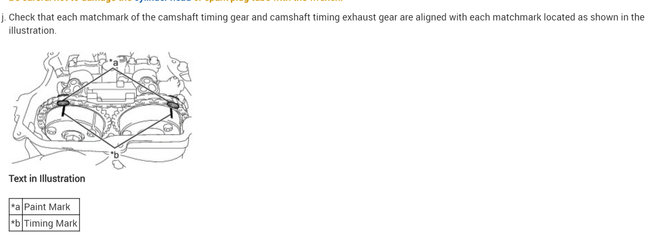

I'm familiar with lining up the crank but the cam timing instructions are a little weird, shouldn't you just rotate them like so or what? I don't recall having to remove bearing caps and stuff.
Sep 6, 2020 at 3:38 AM
CANNON1349
  • 861 POSTS
I'm sorry, what I'm asking is it looks like your instructions want me to remove the cams, is that really necessary or is that just part of the general instruction where you took your screenshots? I was assuming I only needed to turn the cams to their 0 marks as well as the crank and let her rip.
Sep 7, 2020 at 12:27 PM
  • 110,248 POSTS
If you are simply setting base engine timing, you don't need to remove the cams. Simply make sure they are properly aligned. That is the biggest concern. See pic below. Note that the chain will have painted links. They need to be in the correct positions.
Let me know if that helps.
Sep 7, 2020 at 1:12 PM

also step 1 says removing the engine/trans-axle assembly. Is that really necessary?
Sep 7, 2020 at 9:12 PM
No. Sorry for the confusion. They didn’t have a procedure for just the timing cover or chain so I had to pull it out of the rebuild info.
Sep 7, 2020 at 10:51 PM

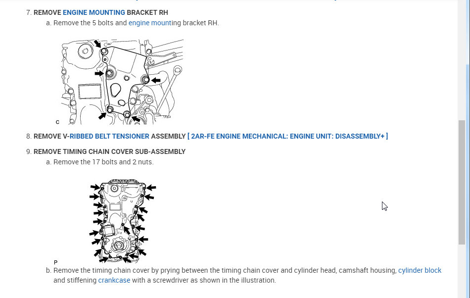

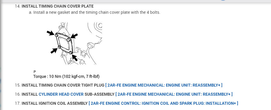

What about that engine bracket? Can it just be removed or do I need to jack up the engine? Will need to remove the oil pan just to be sure I get any chain bits out of there so.
Sep 12, 2020 at 1:19 AM
CANNON1349
  • 861 POSTS
Unfortunately everything I read mentions removing the engine/transmission assembly. When I search for oil pump removal, or timing chain removal, etc. Which seems a little ridiculous.
Sep 12, 2020 at 2:08 AM
Yeah. These manuals are only showing these components during the engine overhaul and not in-vehicle repairs. I have not done any of these personally on this engine but find it hard to believe it can't be done in the vehicle. I will keep looking for other information and let you know what I turn up.

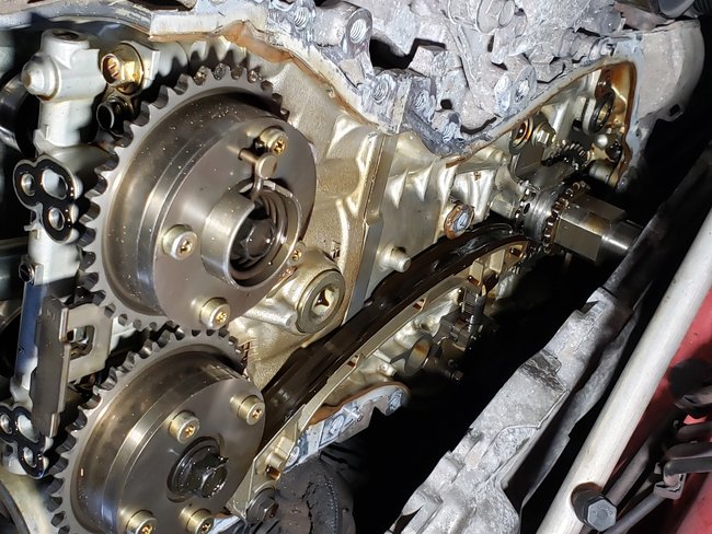

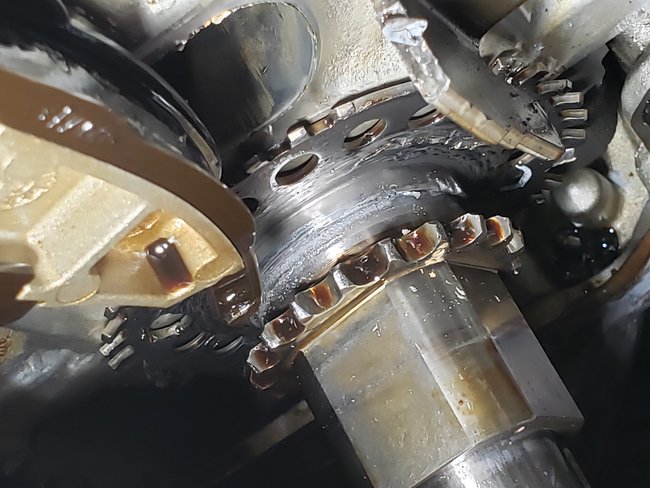

Well here's the damage. Doesn't look good. There's a bent/chipped gear on the crank that possibly drives the oil pump?
Sep 14, 2020 at 9:27 AM
CANNON1349
  • 861 POSTS
Okay, so that wheel is just the crankshaft position angle plate. Does it look like it needs to be replaced? I can't find one on parts.toyota.com, only a diagram. Also, the chain guide pictured seems to be bolted in with a bolt that goes through the timing cover, so how would I go about putting all this back together ? Or is it worth putting back together?
Also I cannot remove the timing cover unless I get the lower engine mount out. Two of the studs on the mount seem to be riveted in or something. Only one nut on the bottom and one on the top for a bracket and the rest are these threaded studs.

Just wanted to throw my 2 cents in.
The tone wheel for the crank sensor is part of the crankshaft itself.
That is why you cannot find it in any parts catalog.
At the point you are at, I would replace the motor as most likely you have valve and possible piston damage as a result of the chain failure.

but it was supposed to be a non interference motor. also the tone wheel slides off with the crank sprocket.
Sep 14, 2020 at 9:14 PM
I checked as well and the old 4 cylinders were non interference engines but the newer one are interference engines. The fact it was running and failed makes me think you are heading for a full rebuild.

I can't find anything that says it's an interference engine, only mycarangel.com saying it could be noninterference. So I don't know what to believe.
