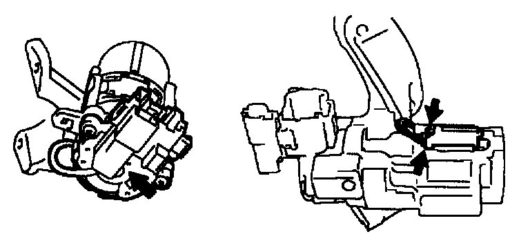

Locked ignition cylinder
2005 TOYOTA CAMRY
128,000 MILES • 2.4L • 4 CYL • 2WD • AUTOMATIC
YABBUTT
Wheel Locked and Ignition cylinder locked. Can't turn the key to ACC, and the wheel won't unlock.

First, if you have a different key, try that and see if it helps. Also, take a look through this link.
https://www.2carpros.com/articles/ignition-switch-wont-turn-stuck
If neither of these suggestions help, it sounds like the tumbler AKA lock assembly is bad. Here are the directions for replacement and repair.
PROCEDURES
See picture 1
1. REMOVE IGNITION SWITCH LOCK CYLINDER ASSY

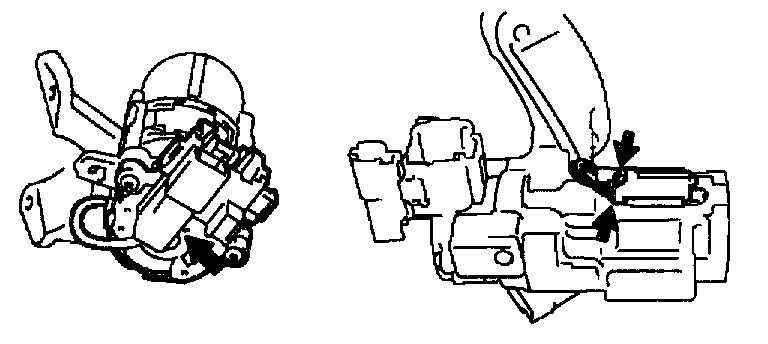

2. REMOVE UN-LOCK WARNING SWITCH ASSY
a) Disconnect the un-lock warning switch assy connector from the ignition or starter switch assy.
b) Remove the un-lock warning switch assy.
3. REMOVE IGNITION OR STARTER SWITCH ASSY
a) Remove the 2 screws and ignition or starter switch assy from the steering column bracket assy.

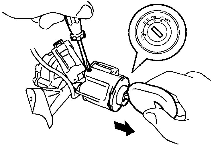

6. INSTALL IGNITION SWITCH LOCK CYLINDER ASSY
a) Make sure that the ignition switch lock cylinder assy is at the ACC position.
b) Install the ignition switch lock cylinder assy.
7. INSPECT STEERING LOCK OPERATION
a) Check that the steering lock mechanism is activated when removing the key.
b) Check that the steering lock mechanism is deactivated when inserting the key and turning it to ACC position.
