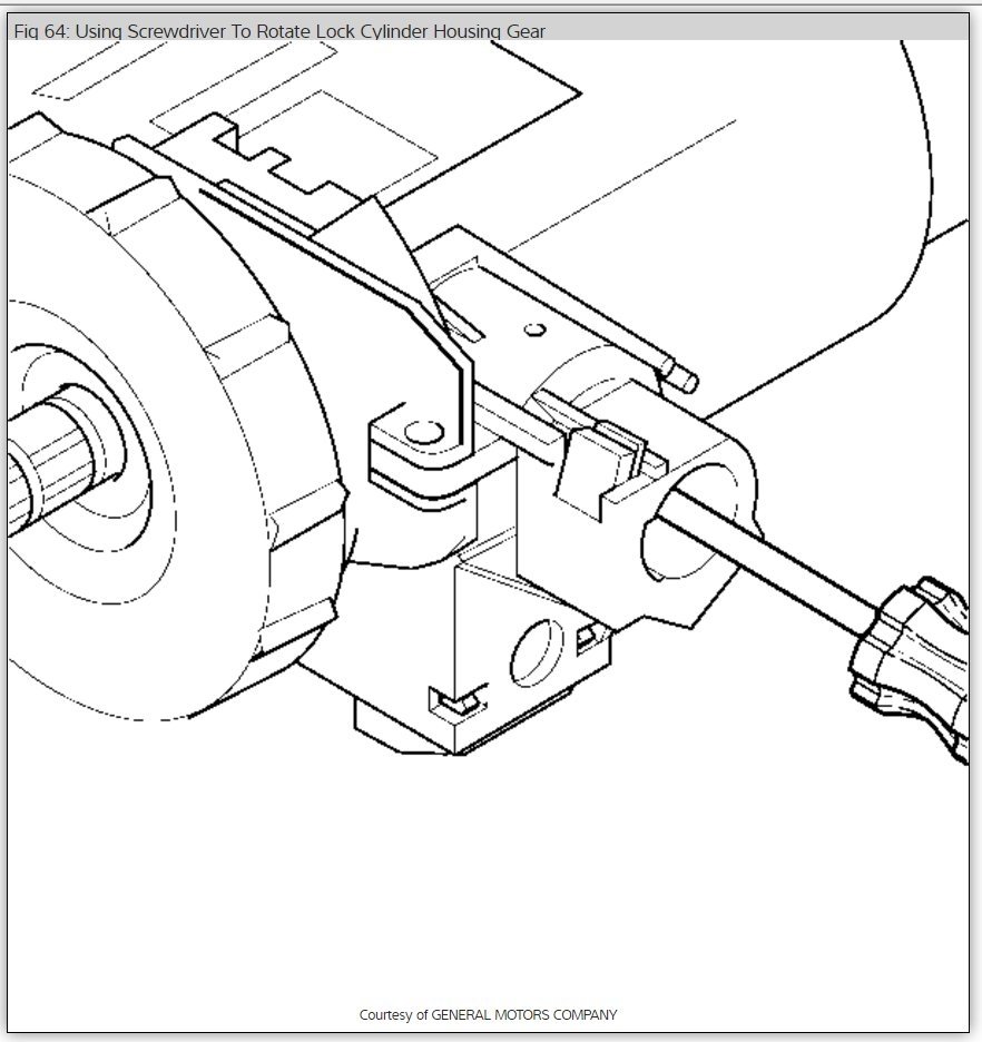

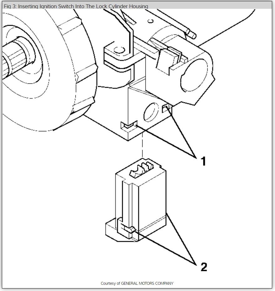

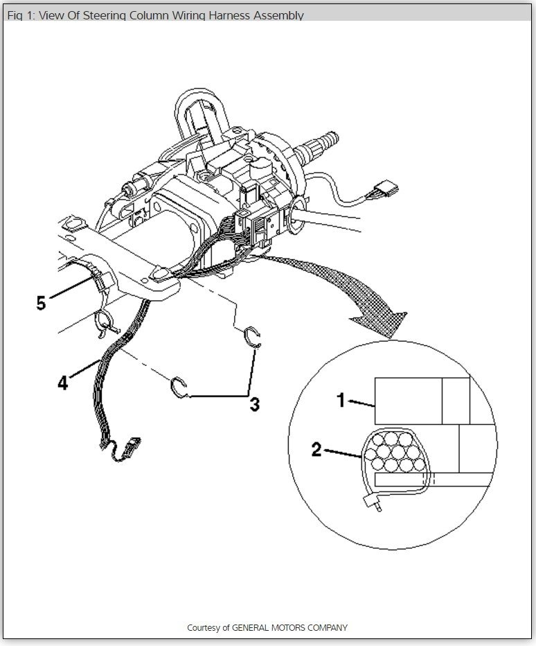

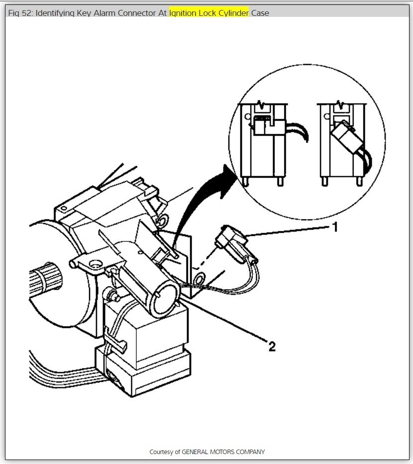

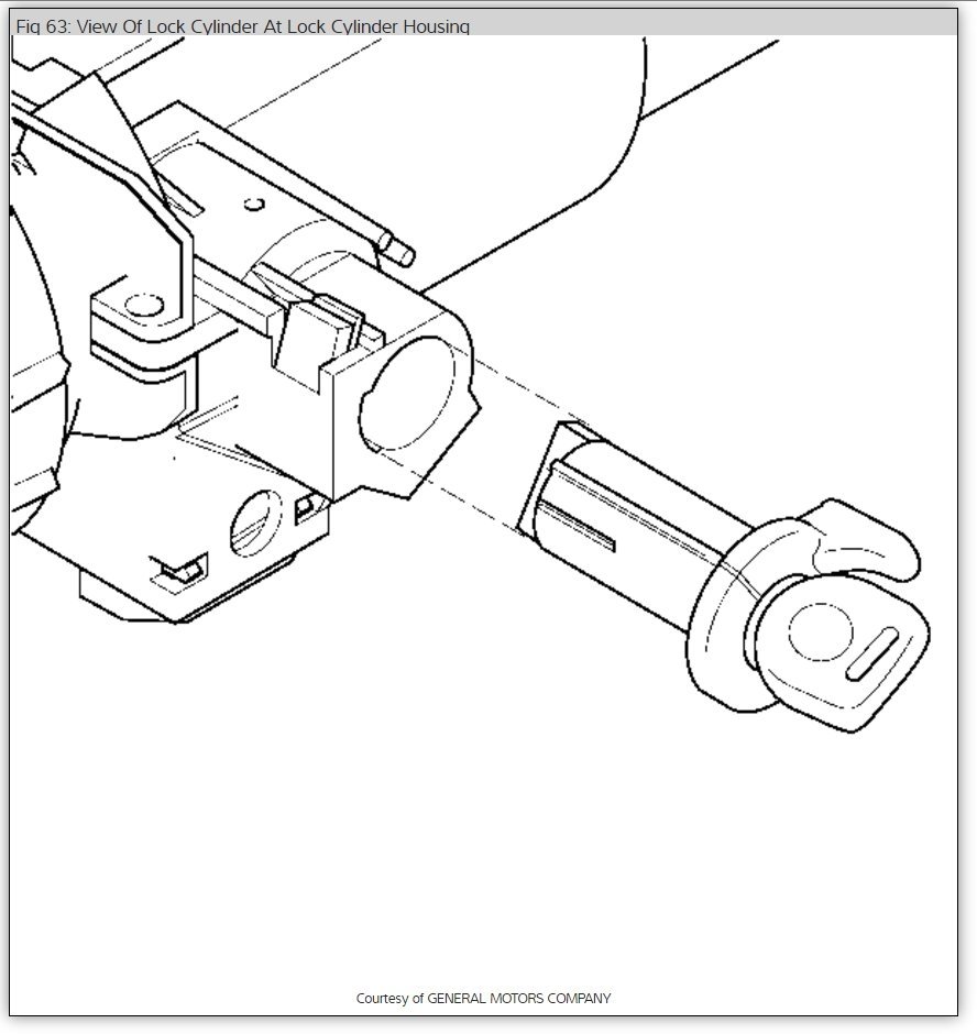

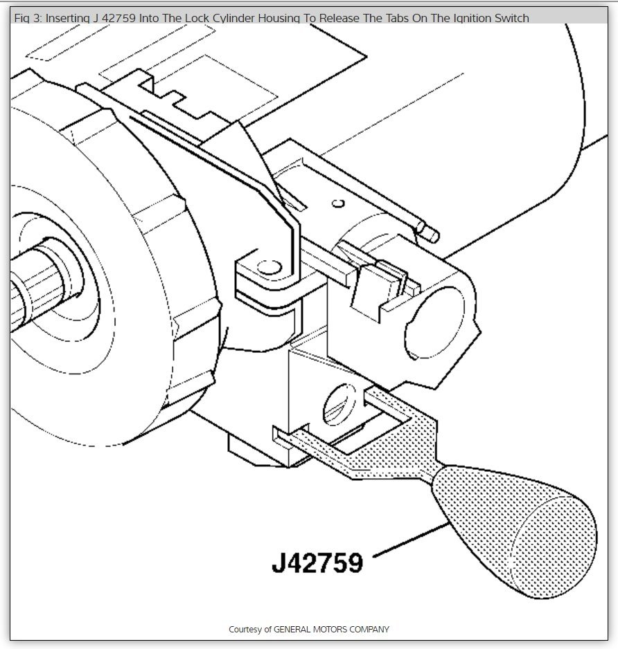

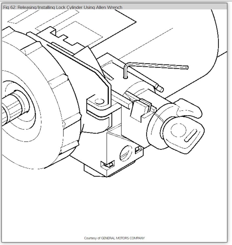

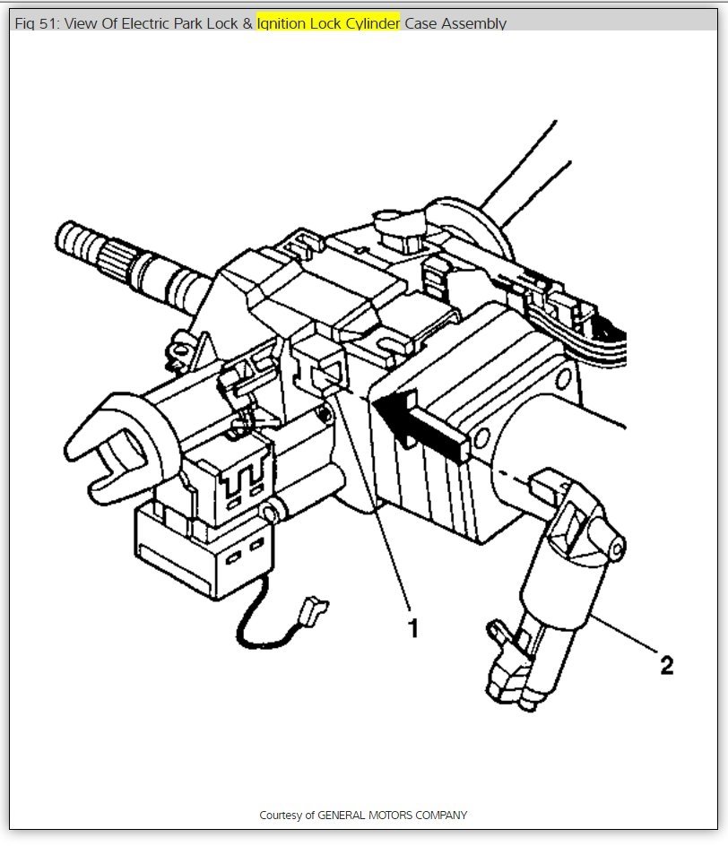

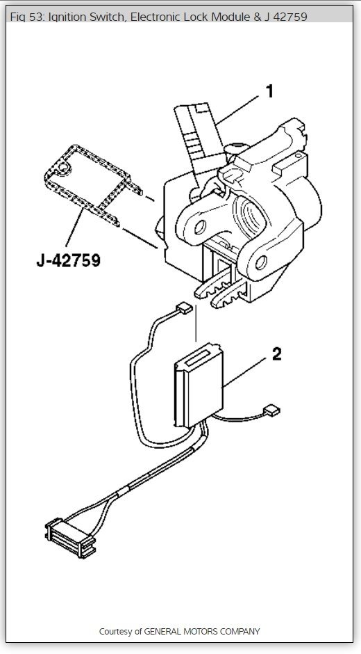

It sounds like the ignition key lock needs to be replaced. You will need to have the key programmed before installing it which the dealer can do. Here are diagrams to help you get he job done. (below)
