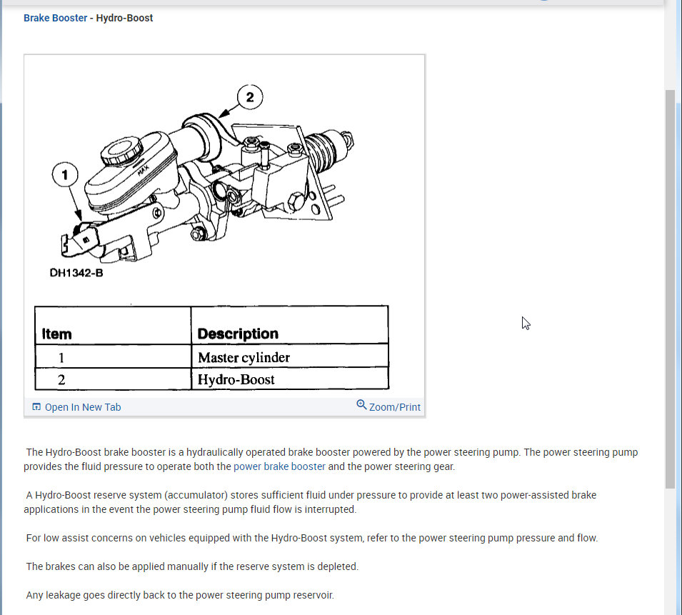

All 4 wheels lock up and I have to floor the gas to go 45 in 2nd gear. When this happens the brake pedal is stiff and doesn’t want to depress. I replaced the hydroboost and it fixed the problem for 3 days, then it locked up again.

Sounds like you have a master cylinder issue but the hard pedal does point to a booster issue.
However, how do you know it is all four wheels that are locking up? Also, what do you have to do to get it to release?

In the 3 days that it was "fixed" did you drive like normal and it operated the entire time with no issues?
If so, then was this the same issue that you replaced the booster for?
Did you just replace the booster or did you get an assembly with a new master cylinder as well?
See below for more detail.
What I suspect is happening depending on these questions, is the brake push rod is sticking and causing the brakes to drag.

Yes, this is why I replaced it in the first place. But I only replaced the booster. Would the brake push rod just need to be lubed?
Apr 16, 2021 at 12:41 AM
You could try that but I suspect the rod in the master is where it is sticking so that means replacing the whole unit would need to be the solution.
I am not sure this will work but try getting it to lock up again and then push down and actually pull up on the brake pedal to see if they release quicker then before. I doubt it will be an instant thing but it may.
