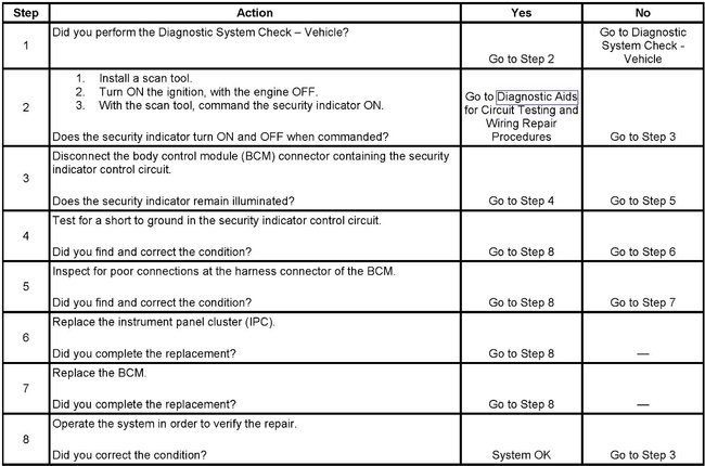

Went to start car and it started, but now has lock and car symbol on the dashboard.

Welcome back to 2CarPros. Is it on solid or flashing? Solid means that after it started the system stopped being able to read the keys transponder. To see which part has the fault you need a high level scan tool that can access the pass-lock system and see which component has failed. The body control module and the anti-theft modules are common issues but you still need the scan tool to test it and program any replacement to the car. Depending on what component has failed the engine may or may not start. You could try a different key or replacing the battery in it but they normally don't cause this issue without giving a warning that the battery is low.

I went out and put the key in and started it. The symbol was gone. Went out the next day started it again and it was back. Got it scanned and nothing came up for the anti theft. Any other ideas on what might be?

Who did the scan? Unless it was a dealer level tool it usually won't be able to read the codes that the anti-theft sets. With it being an intermittent problem I would suspect the ignition switch as that is the moving part but it would need to be tested to see if it's the switch itself or the wiring. When did the light come on? When you turned the key to start or after the engine started and you released the key back to run?

Well they should have used a capable scan tool. Looking in the GM codes list for your vehicle P0049 isn't listed as a valid code though. I would also expect the code that is setting that light to be either a B or U prefix. The attached is the test used if the light is on all the time. In your case it is intermittent but could be related.
This requires a bi-directional scan tool to test the system.
