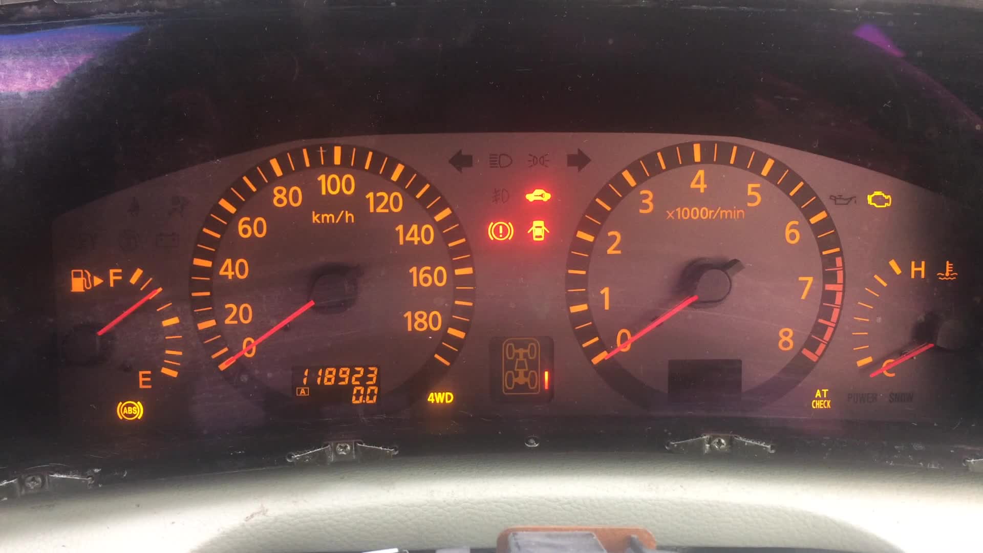

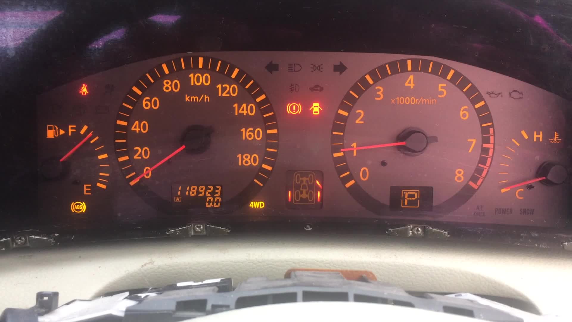

I am not able to clear these codes as these are coming back. When I turn on the ignition the security key light stays on and the radiator cooling fan will start running and the headlights will also turn on, the cluster lights are also randomly turning on here and there.

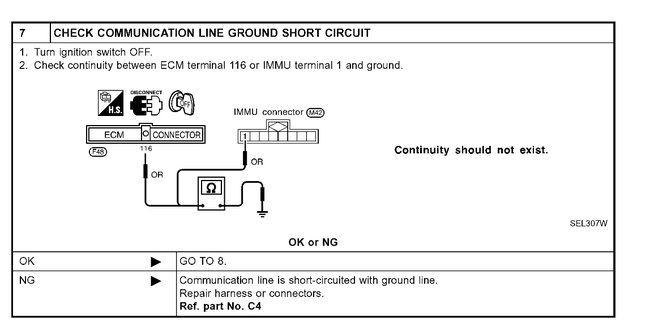

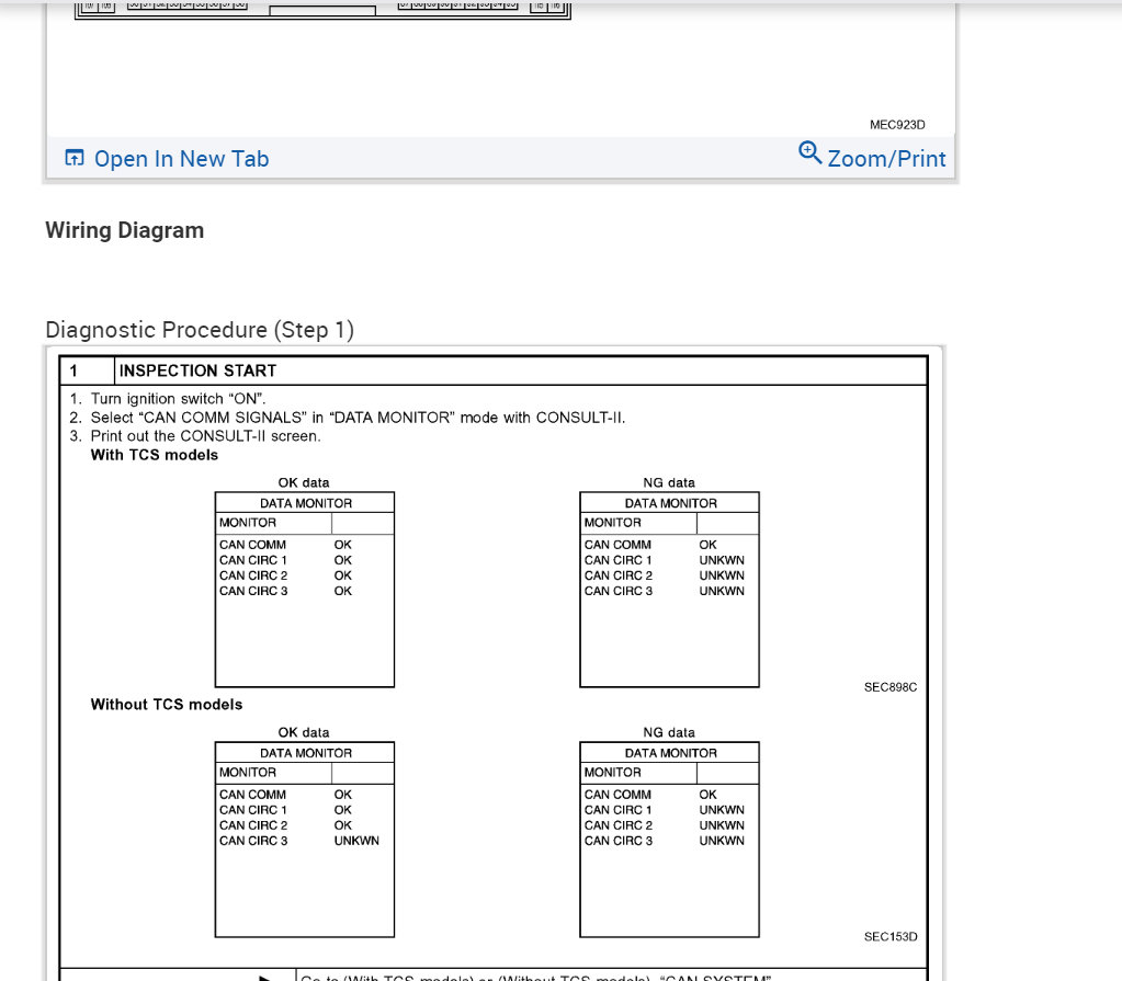

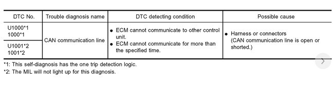

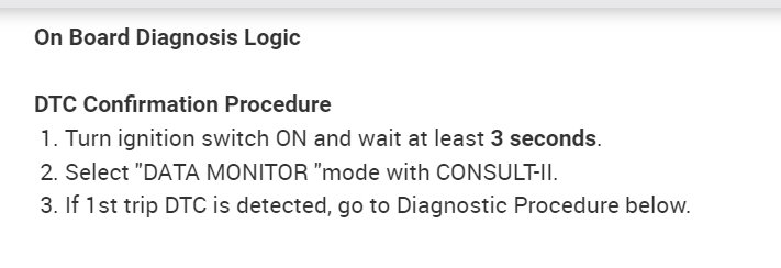

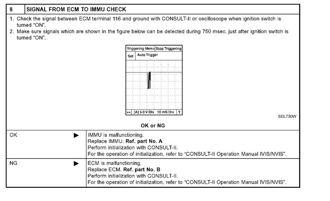

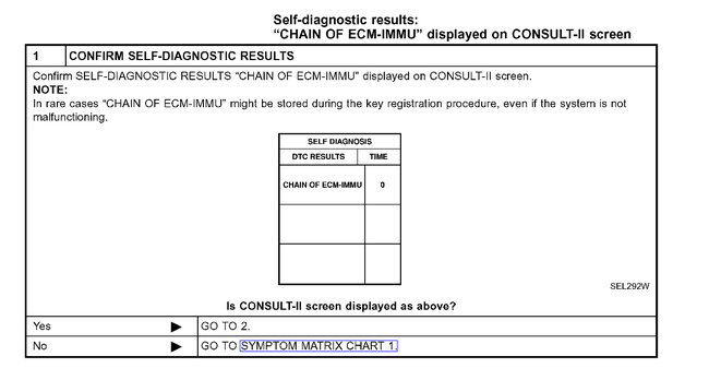

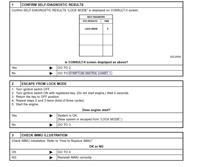

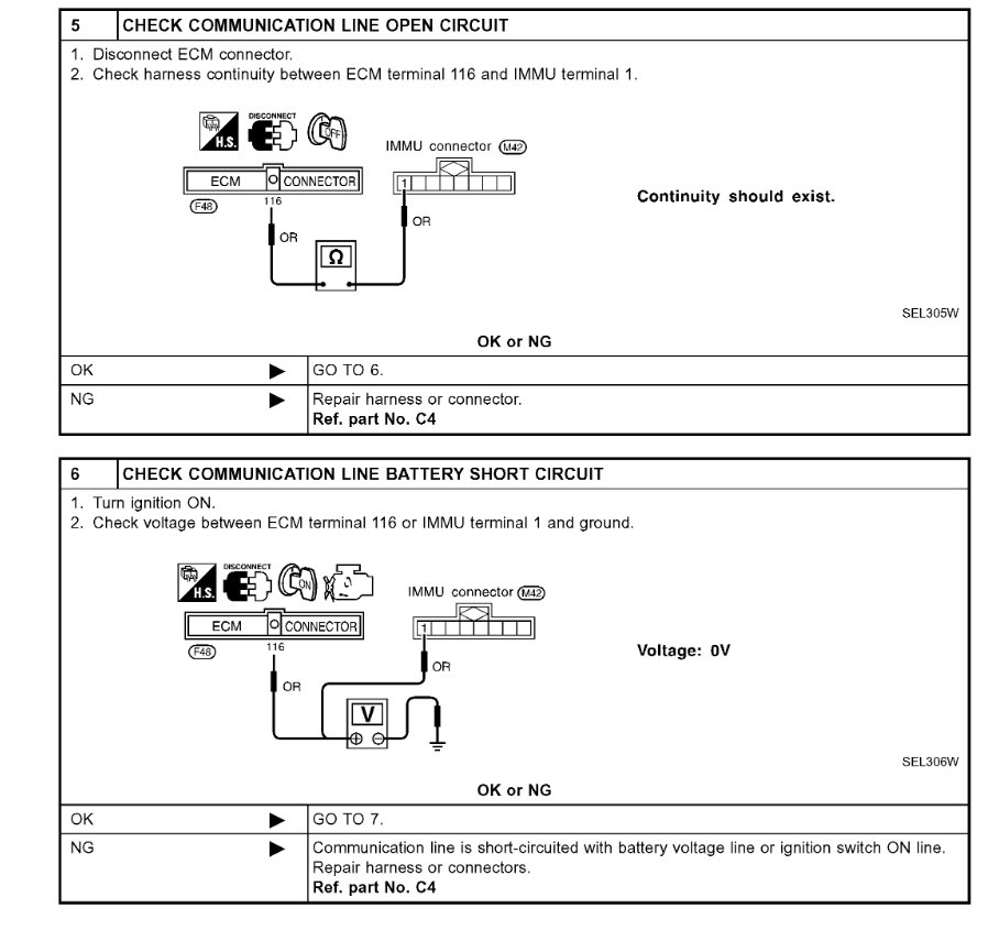

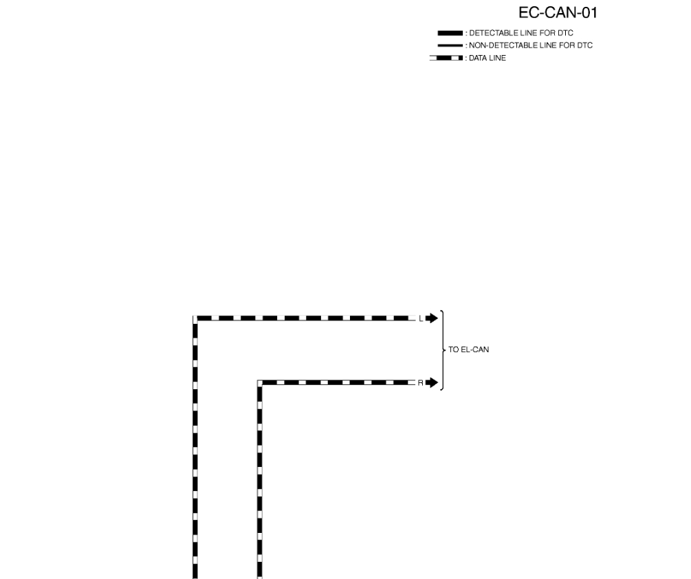

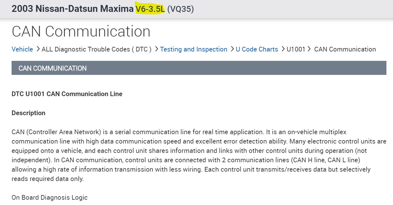

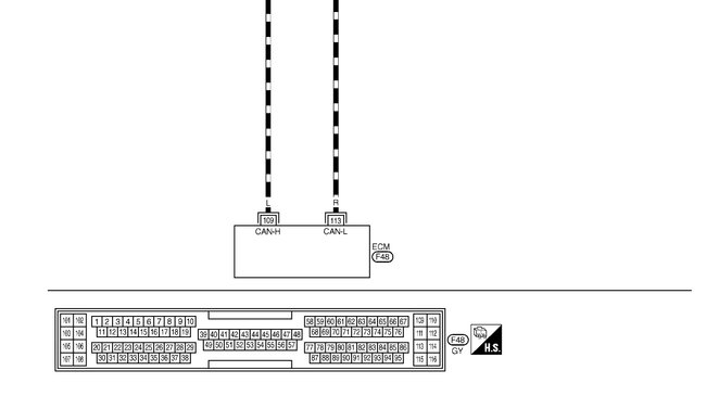

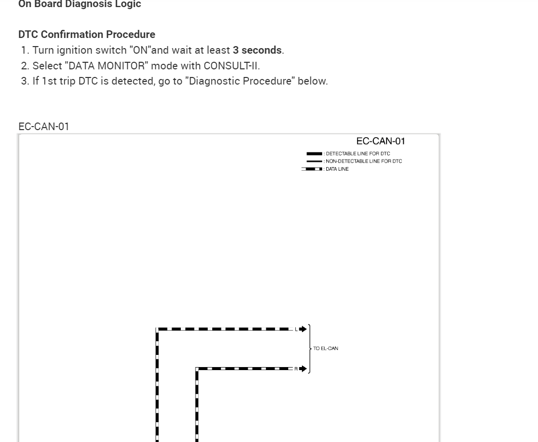

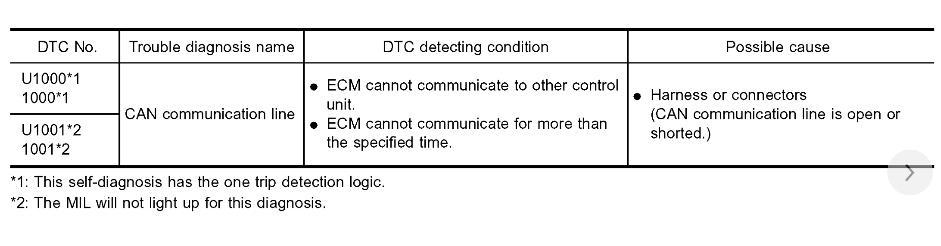

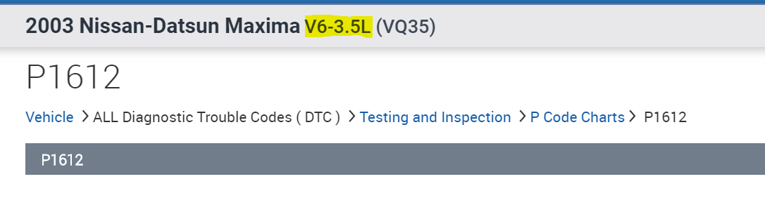

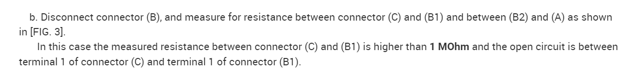

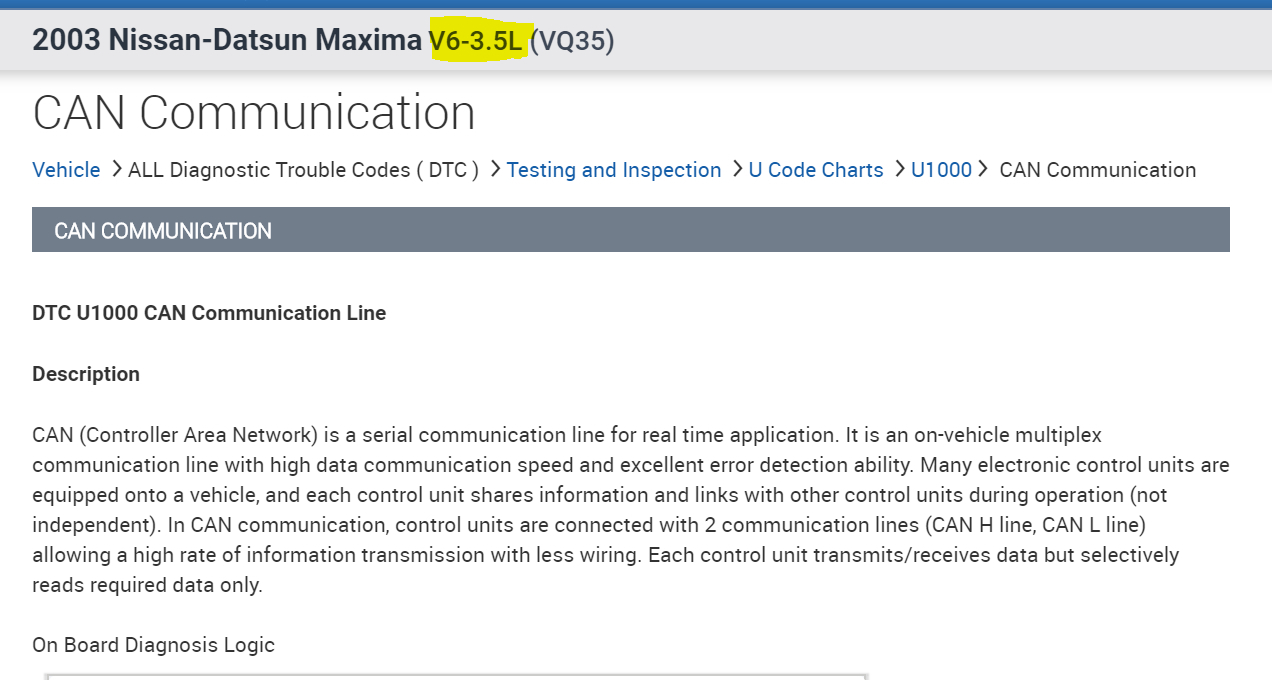

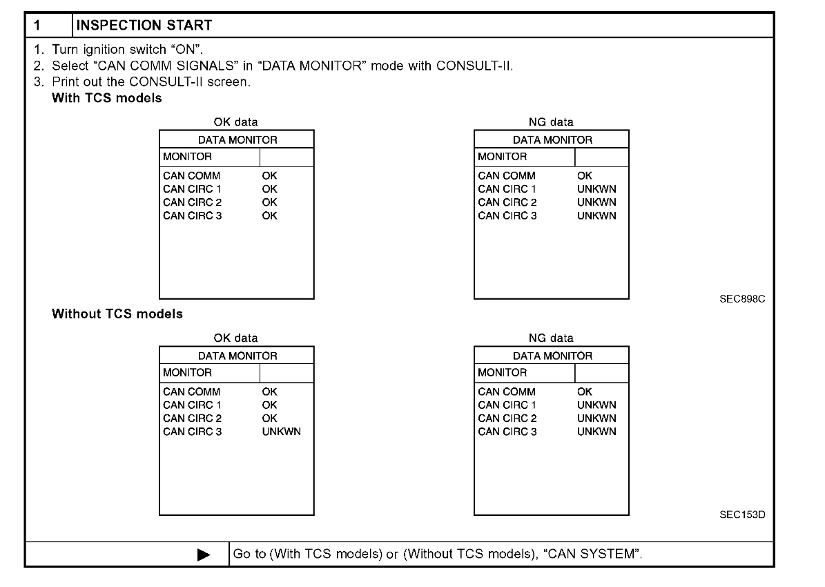

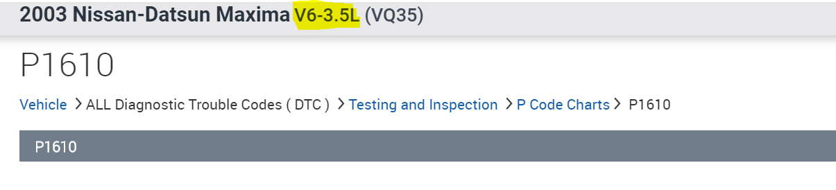

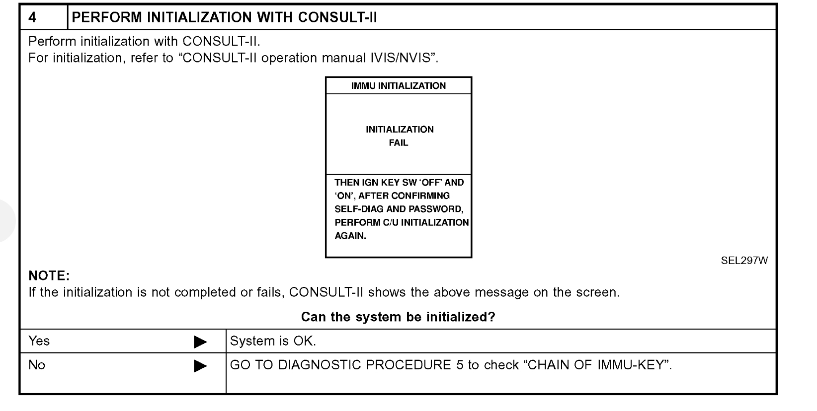

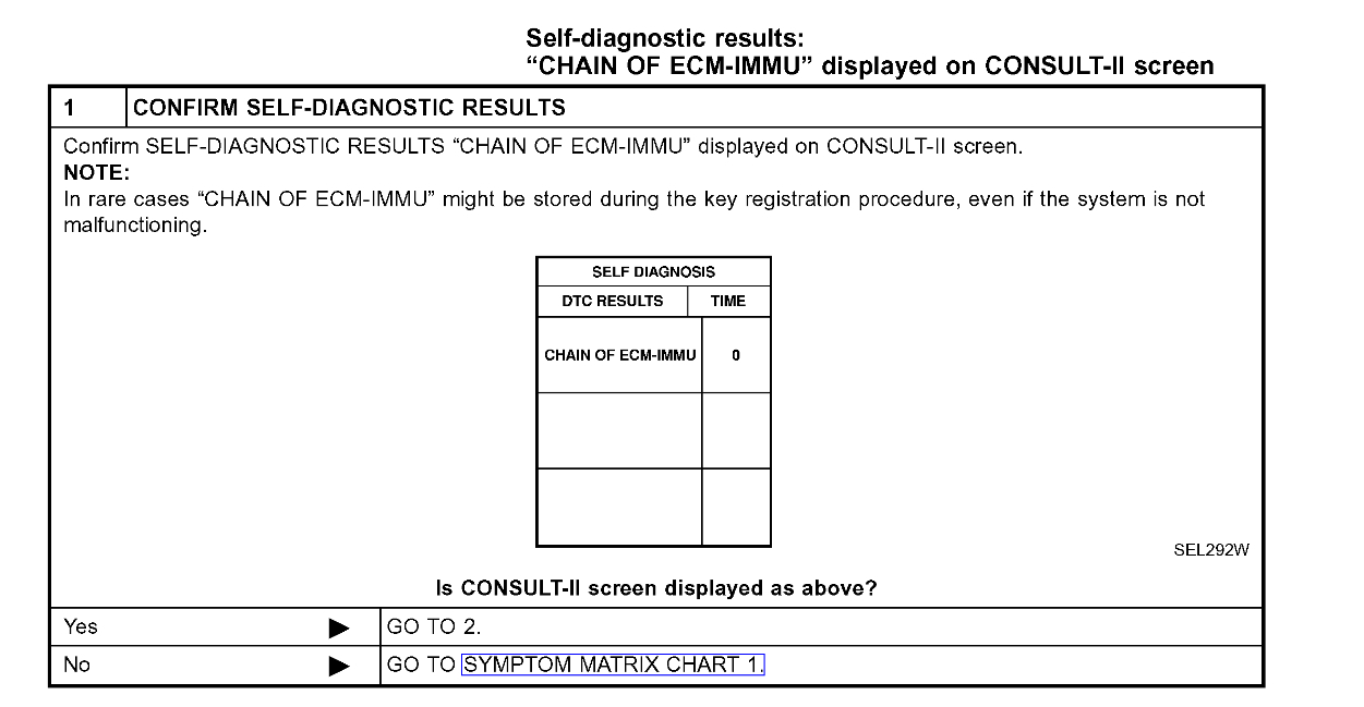

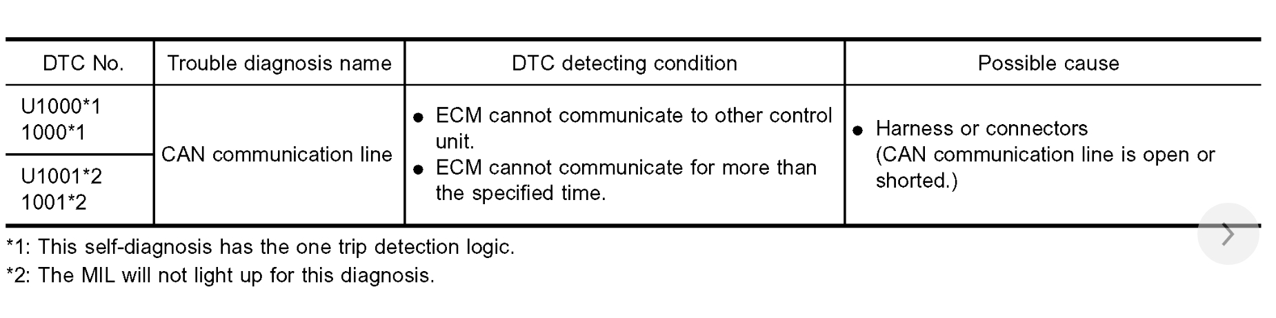

In the diagrams down below I have included the factory diagnostic troubleshooting guides for Direct Trouble Codes (DTC)(s) P1610, p1612, u1000, and U1001. You will need a multi-meter to go through these guides and I have included a link below if you are unfamiliar with how to use one.
Please go through these guides and get back to us with what you are able to find out.

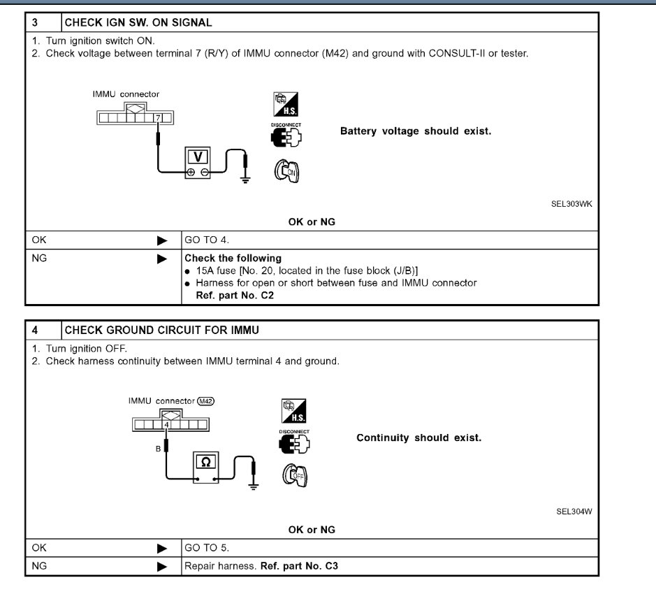

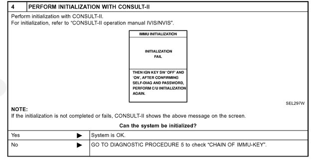

Thanks for your reply. I have gone through the guides. With the “Escape for lock mode” procedure the car does starts but only once or twice and even if you repeat the “Escape for lock mode” procedure it won’t start again.

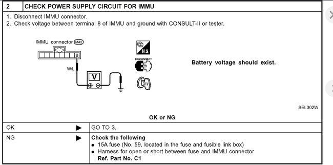

With regards to the power supply circuit for IMMU it shows 5 volts between terminal 8 and ground for couple of seconds only if you switch on the ignition and then it goes back to 0 volt. But if you do not switch on the ignition then there is 0 volt between terminal 8 and ground.
IMMU Terminal 7 and 1 are not connected with the harness therefore relevant testing could not be done.
Continuity exists between IMMU terminal 4 and ground.
What else can I do?

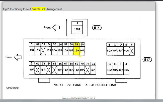

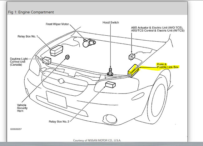

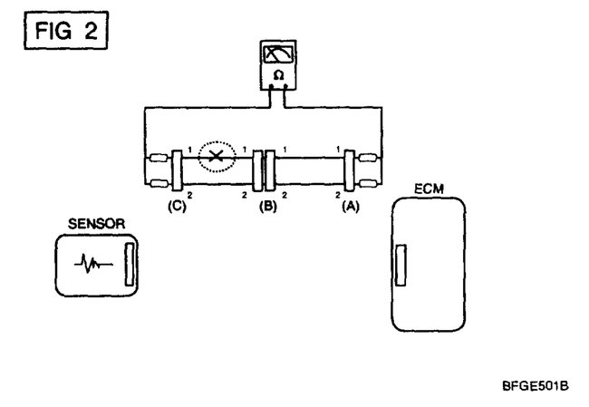

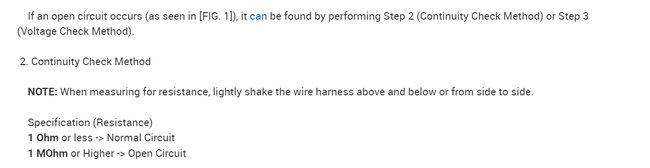

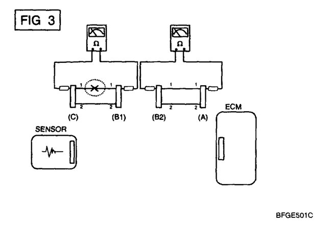

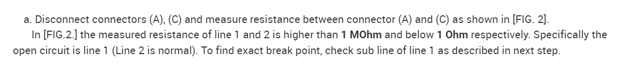

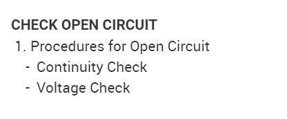

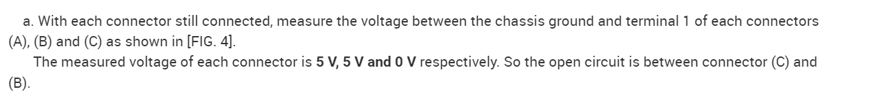

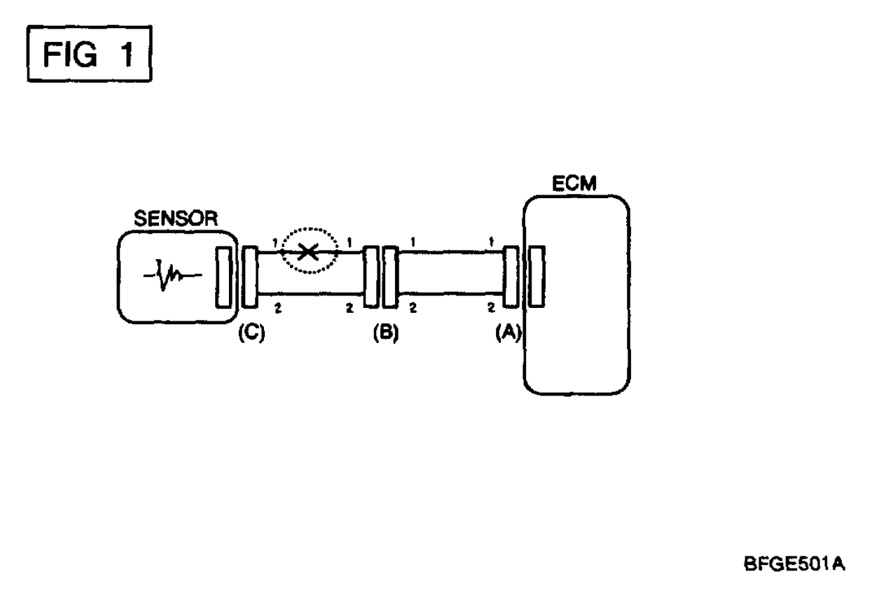

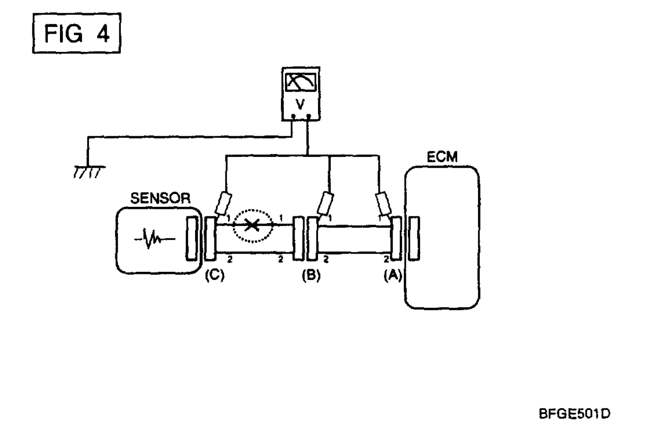

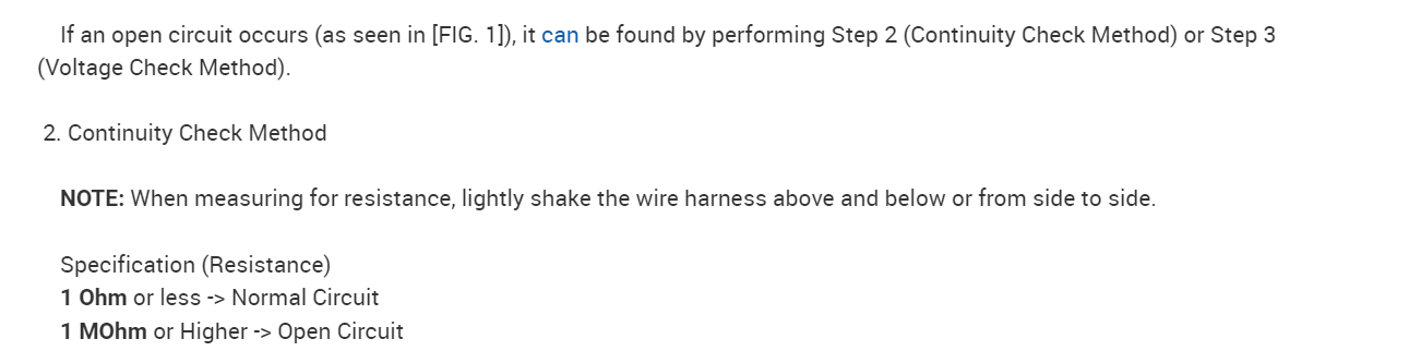

With the key in the "off" position you should have battery voltage between pin 8 and ground. If not you should look for an open in between fuse 59 in your vehicle's fuse and fusible link box in the left side of the engine compartment and the IMMU connector. In the diagrams down below I have included a diagram of the fuse and fusible link box, a call out for it and it;s location, as well as how to find an open in an automotive electrical circuit for you. Please go through these guides and get back to us with what you are able to find out.
Thanks,
Alex

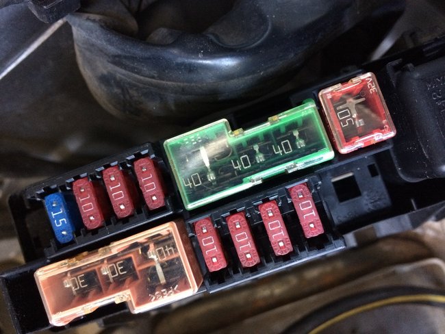

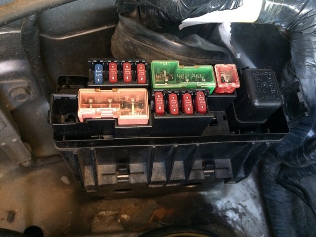

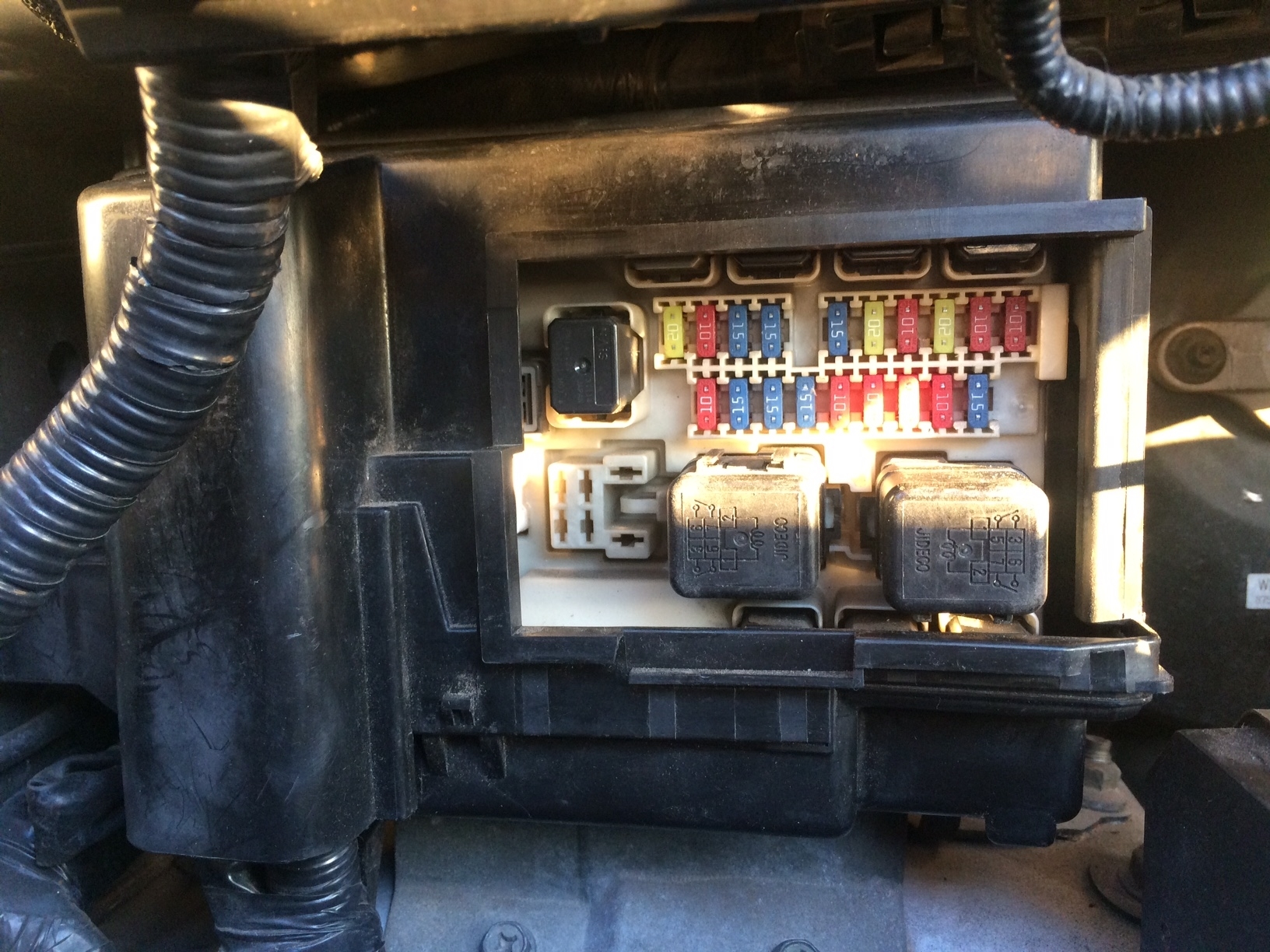

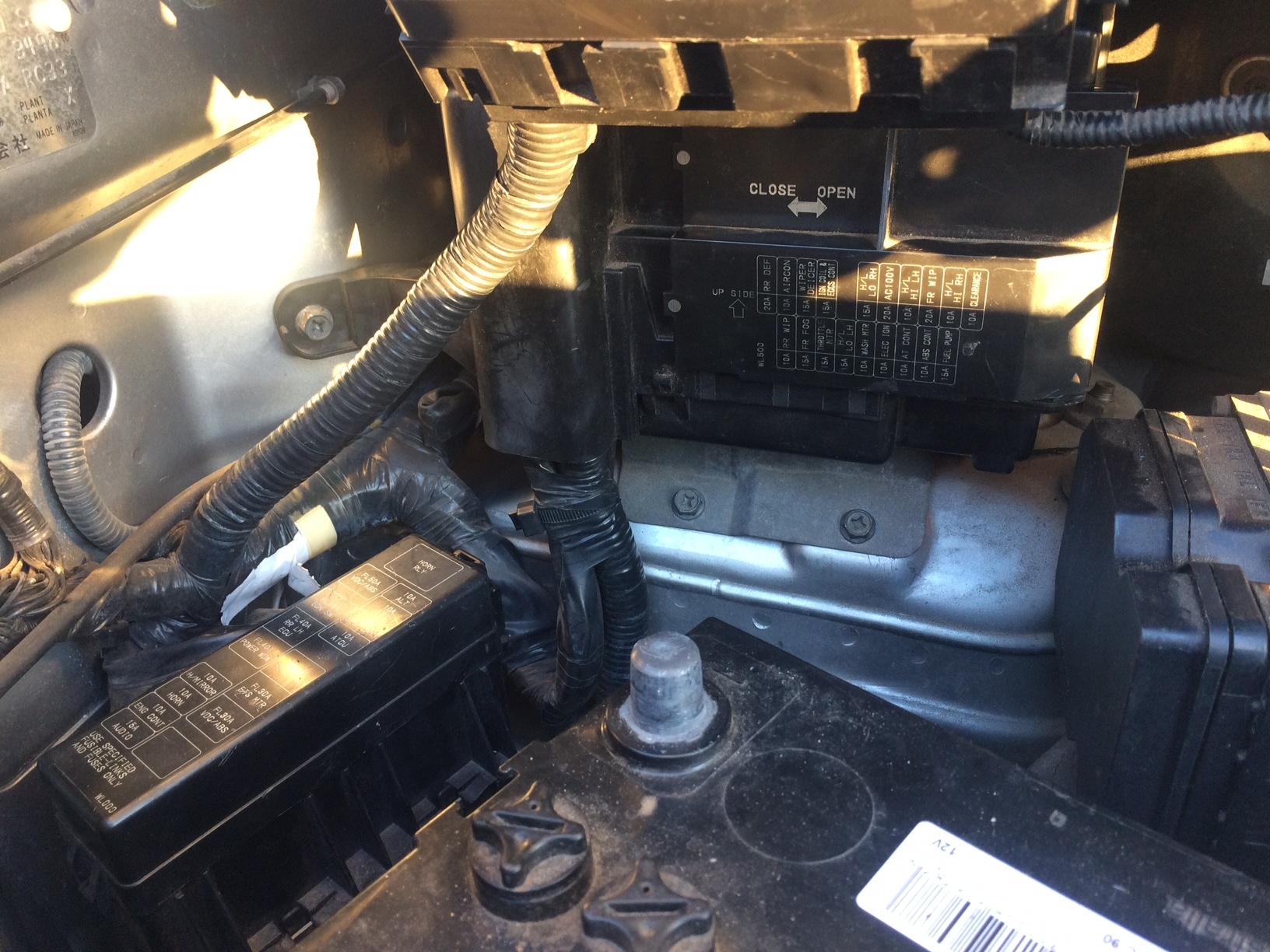

Hi, unfortunately my Nissan Elgrand fuse and fusible link box location is different and they are not numbered. I have added some images for your reference. Do you know what is the purpose of fuse 59 then I can try to match it with mine if I could.

It looks like you have a fusible link out. can you get a better picture of the links? More straight down please.

Hi, attached. please find the picture for your reference.
Thanks
Jul 14, 2019 at 8:32 PM
  • 55,433 POSTS
The links look good, let look for a power failure at the ECM relay inside IPDM. Here are the locations guides and diagrams to help below:
You could have a bad IPDM which is common it is easy to replace because it self initializes.

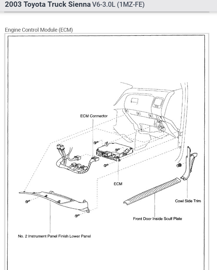

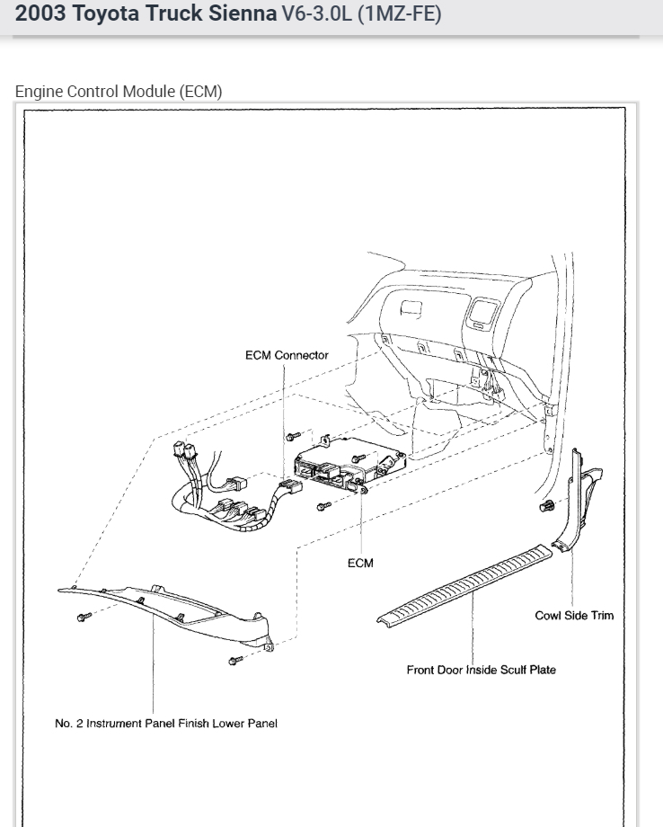

O yes, we like to check out everything before calling the computer but it does sound like it. Here is the ECU location under the seat, I would check the connectors for corrosion. Check out the diagrams (Below). Please let us know what you find.

Hi, in my Nissan Elgrand the ECM is located at the left side engine compartment. I have removed the wire harness and ECM and inspected the connectors for corrosion or any physical damage but all looks good.

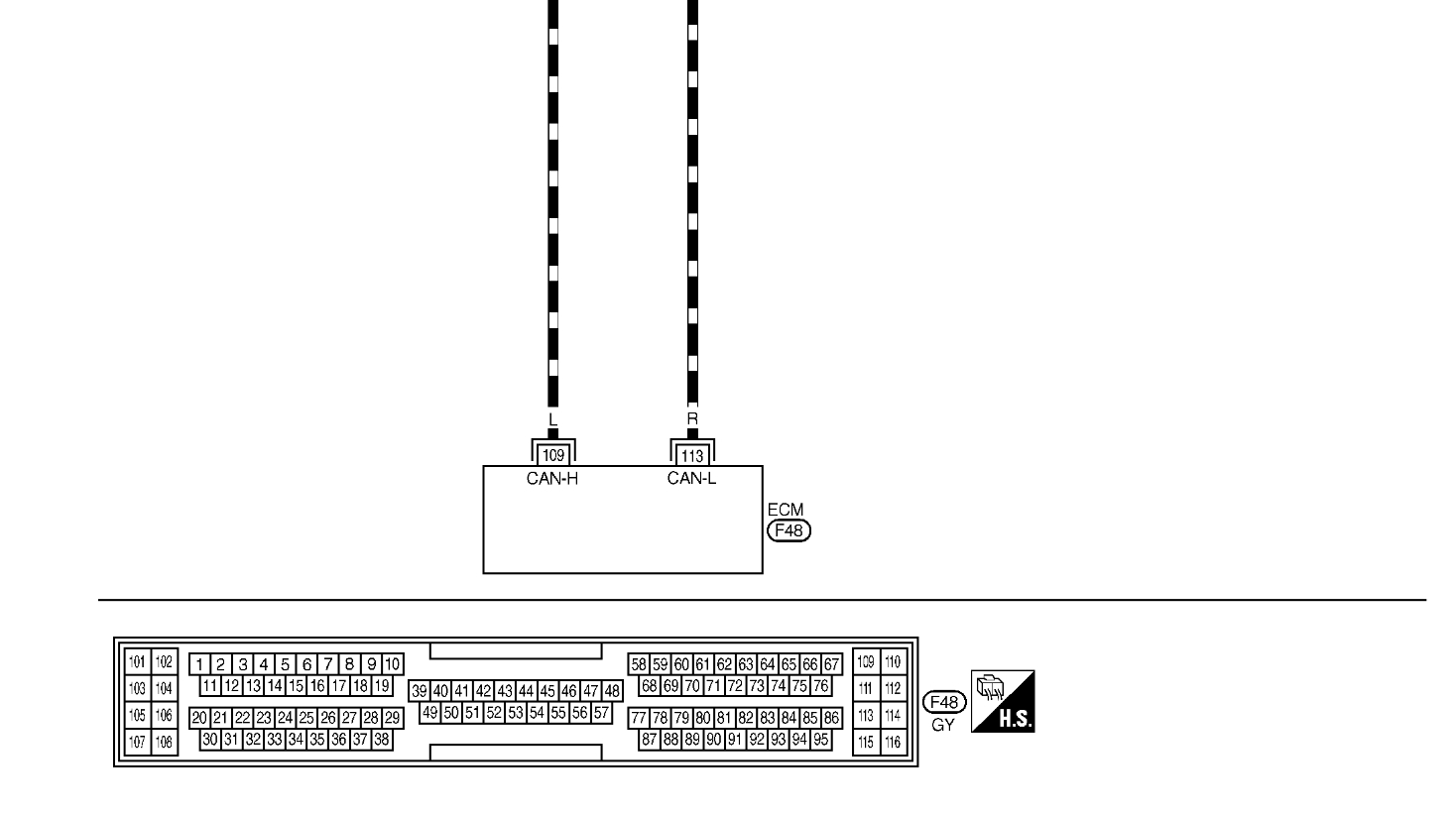

Lets do a CAN scan to see what comes up here is a video of how it is done.

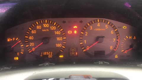

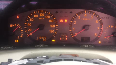

The IPDM go out all the time. Can you please shoot a quick video with your phone so we can see what's going on? that would be great. You can upload it here with your response.

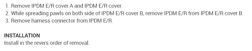

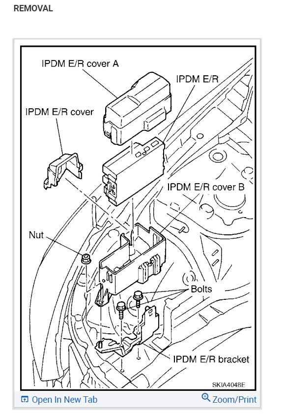

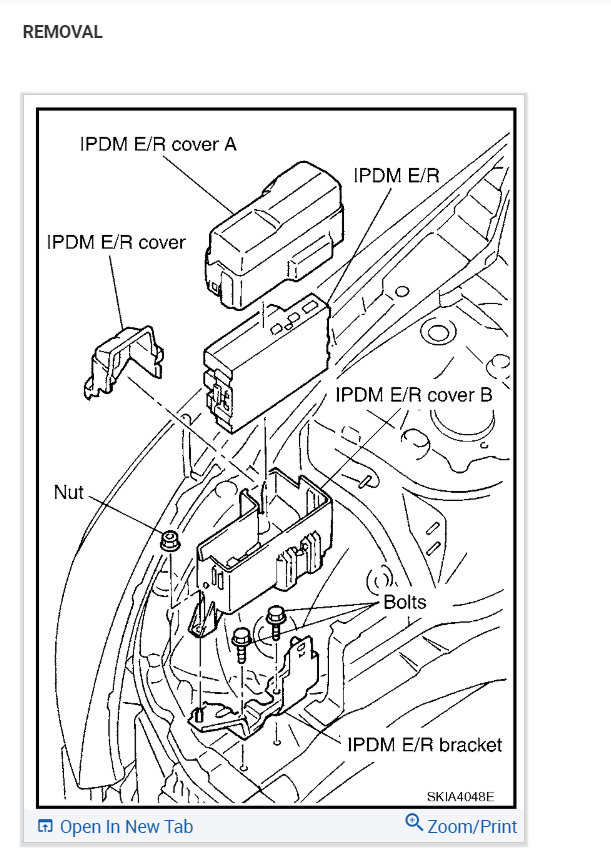

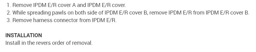

Here are instructions on how to replace the IPDM which is easy because it self initializes. Check out the diagrams (below). Please let us know what you find. Did we ever get the CAN scan done?

Attached you will find the video clips for your reference. I am unable to find the same IPDM part number: 284B7WL500, still searching for it.

While watching the videos it looks like the cluster could be shorting out causing the CAN issues as well. I would unplug the cluster and check for corrosion on the terminals.
Aug 5, 2019 at 3:00 AM
RAAHY
  • 11 POSTS
I did that already and the terminals are fine.

Did you replace the cluster? If not I would try to find a used unit and plug it in to see what happens. Also try to get the CAN scan done.
