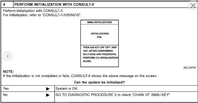

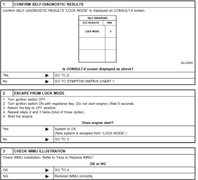

lock mode, code p1610
2002 NISSAN MAXIMA
60,000 MILES • 3.5L • V6 • 2WD • AUTOMATIC
TYLER MORRIS
i just bought this car. i pulled off after we put the tension belt on and we didn't tighten the belt enough and it would go over 5 mph and i shut the car off. then we tried starting multiple times and it went on lock mode p1610.

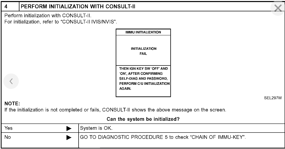

Hello, I'm Danny.
I've attached 2 pictures below showing a troubleshooting chart for that particular code.You will have to find a local repair shop or friend that has access to a Nissan factory code reader to unlock the problem.Hope this helps and thanks for using 2CarPros.
