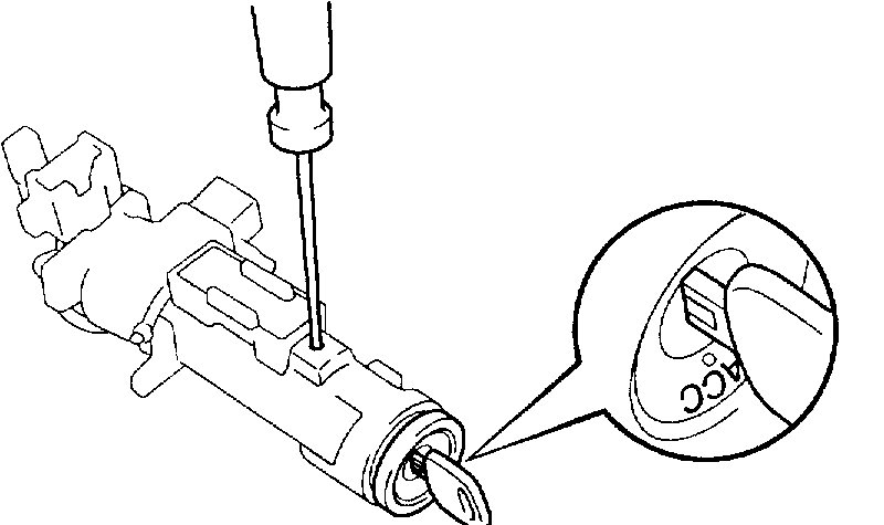

The key lock cylinder needed replacing. I bought one part # 69057-34040. When I put the cylinder in with the key, I can turn the key but cannot get the key out without removing the cylinder
PS. I have already removed the old one and have purchase another. please watch the video.
Thank you, Suzette

I believe the ignition switch has to be in the accessory position when you install the new key lock cylinder. Here is what I'm seeing:
2. If necessary, replace key cylinder.
a. Place the ignition key at the ACC position.
b. Push down the stop pin with a screwdriver, and pull out the cylinder.
c. install a new cylinder.
The vague directions lead me to believe it has to be in the ACC position for install. Is that what you are doing?
