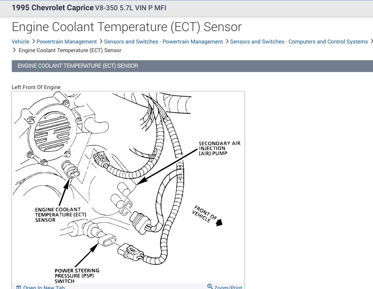

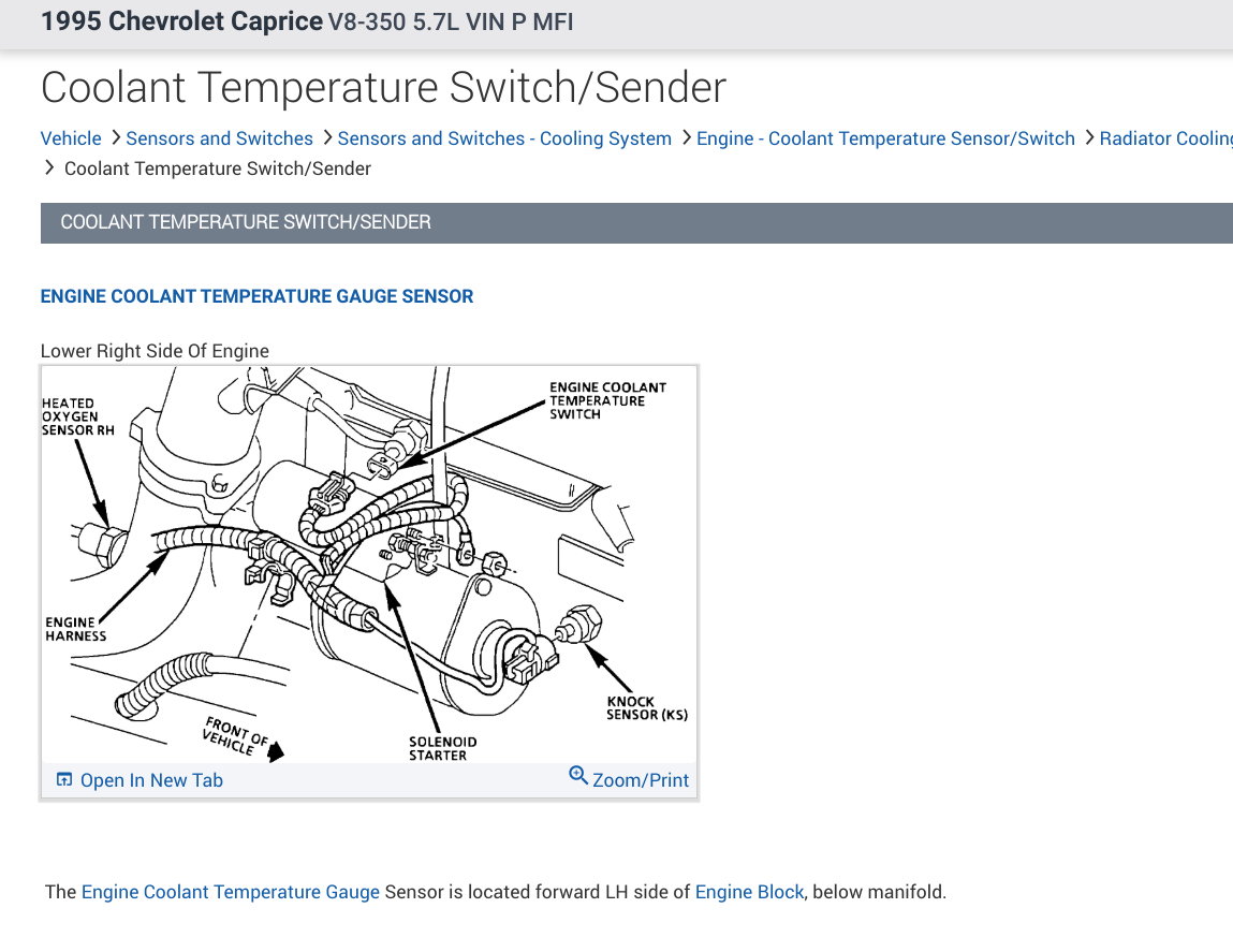

I was told there two temperature sensors and one is on the water pump in front of the engine but wasn’t able locate other one.

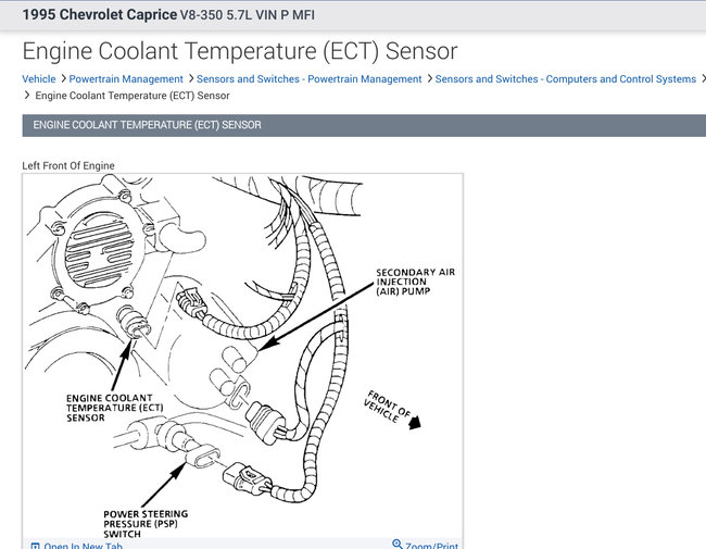

In the diagrams down below I have included the diagrams for the Engine Coolant Temperature [ECT] sensor, that is used by the vehicle's Power-train Control Module [PCM], or "computer", and a diagram for the Temperature Gauge Switch, which is used for the temperature gauge. I hope that this helps.
Thanks,
Alex
