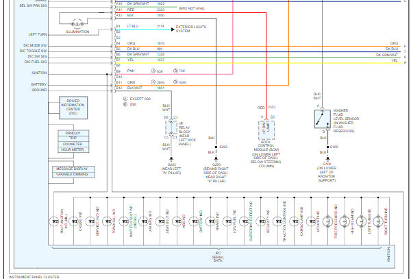

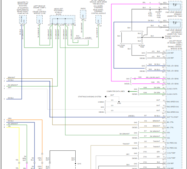

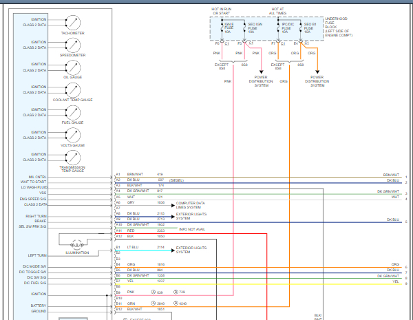

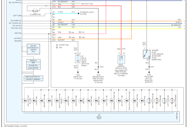

Need to locate the following three wires, preferably near the instrument cluster, fuel level sensor wire (s/b purple but I cannot locate), ignition on hot wire and instrument cluster hot wire. I may be a little color blind so a point in the right location would help! Lol, I have tried to find decent diagrams, but have had no luck. Haynes manual is not much help either. Thank you

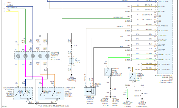

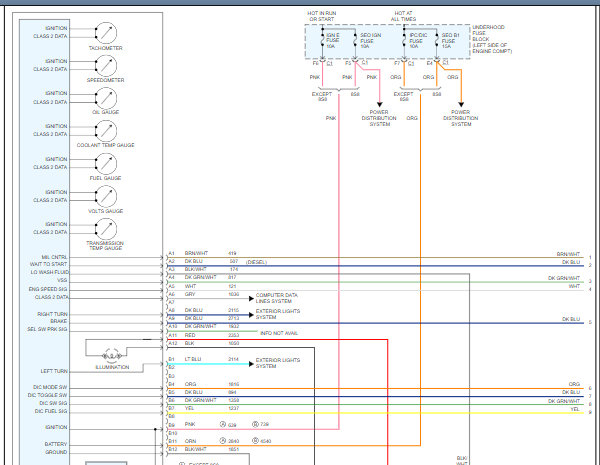

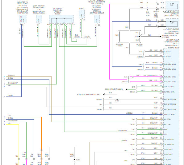

I've attached the wiring diagrams you've requested below. I've cut the 2 pictures in half so you can view larger.From what I viewed the purple wire for fuel you are looking for originates from the ECM. Let me know if you have any further questions on this issue.Hope this helps and thanks for using 2CarPros.
Sep 16, 2020 at 8:38 AM
WINKSV
Danny, I believe this information will help me. If I am reading it correctly, I can tap the pink wire leading into the instrument cluster as ignition hot and the red wire leading into the instrument cluster as illumination hot. It looks like I have to tap into the purple wire for the fuel sending unit as it enters the PCM? I do not see where I could tap into it anywhere near the cluster under the dash? Thanks, Vince
