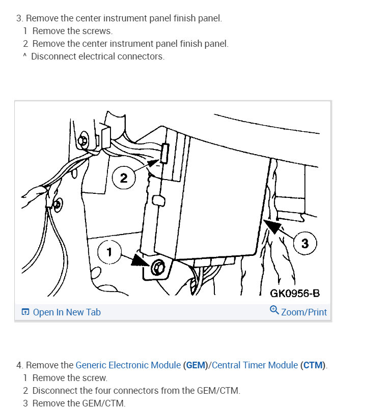

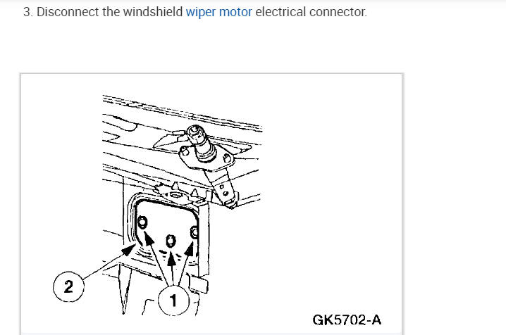

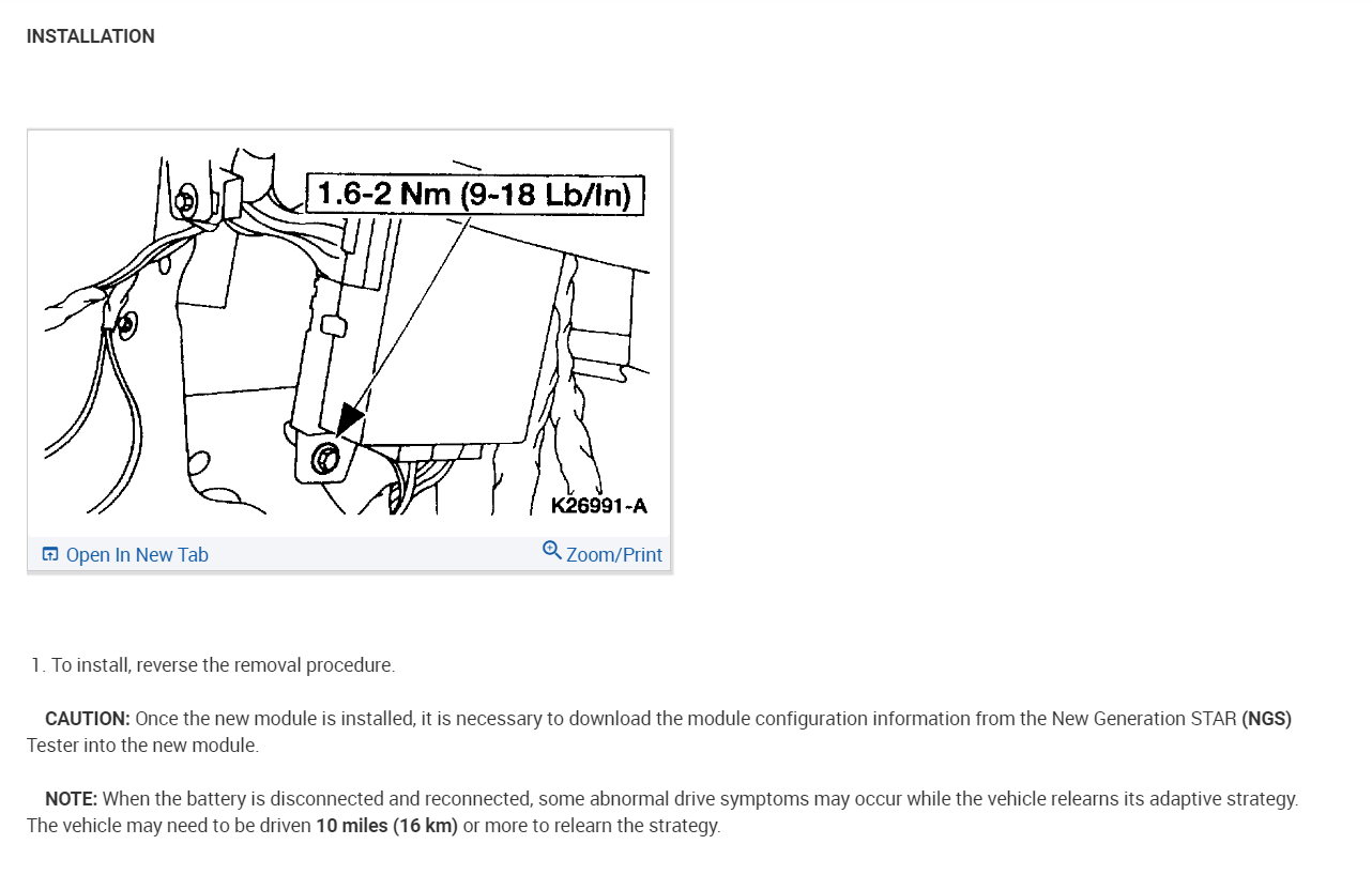

Location of wiper module
1999 FORD RANGER
123,546 MILES
JERRELL FARRELL

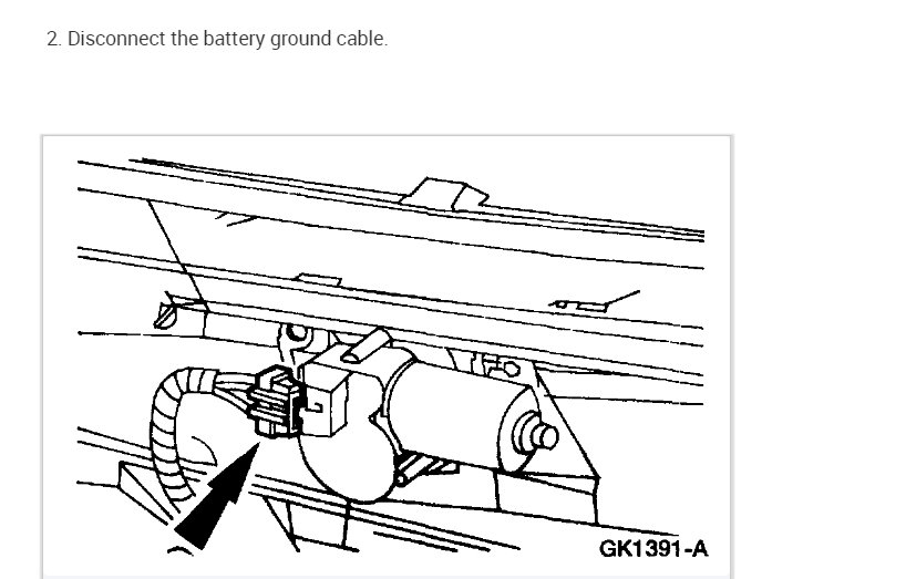

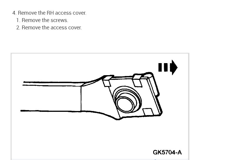

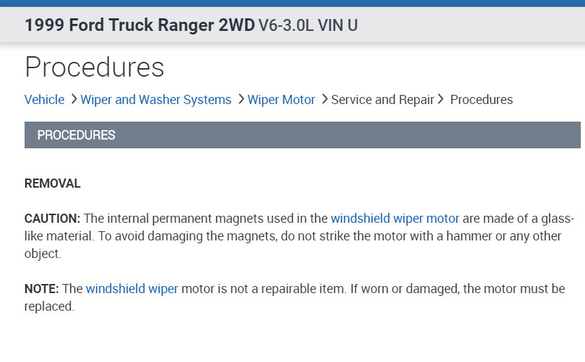

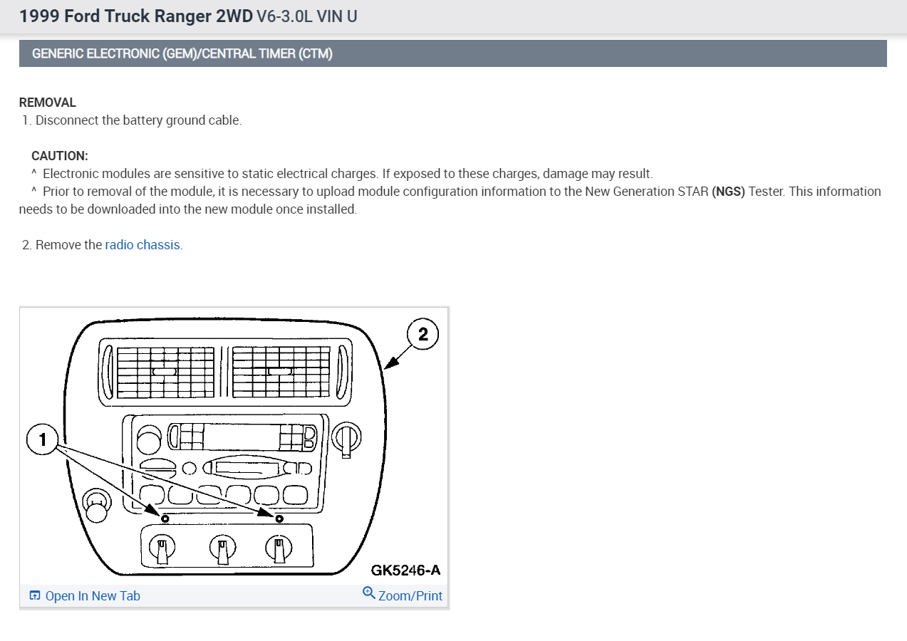

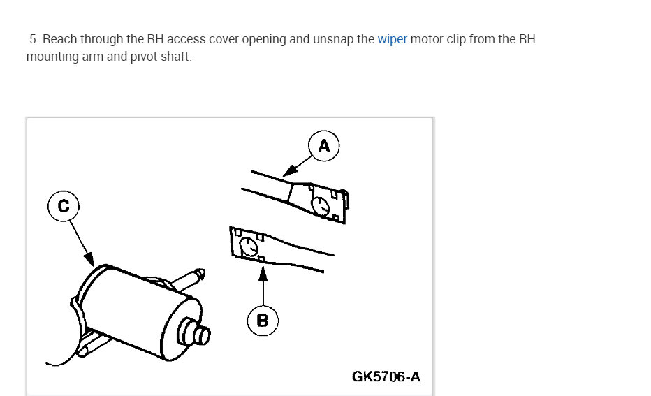

Looking for wiper module.
Oct 25, 2019 at 2:31 AM
SCGRANTURISMO
  • 4,897 POSTS

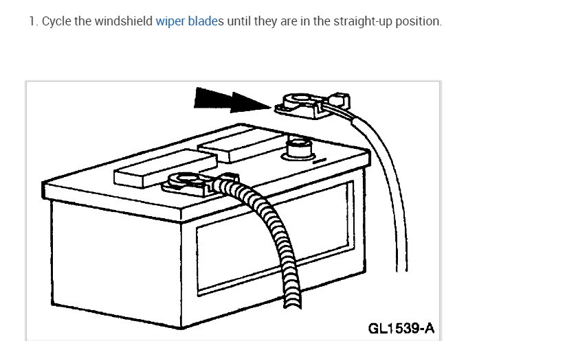

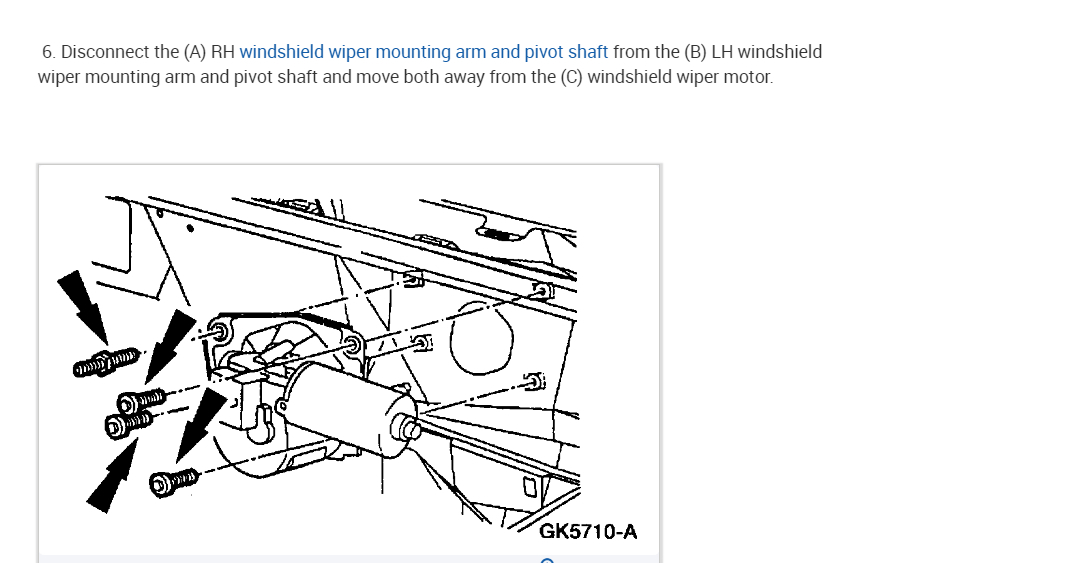

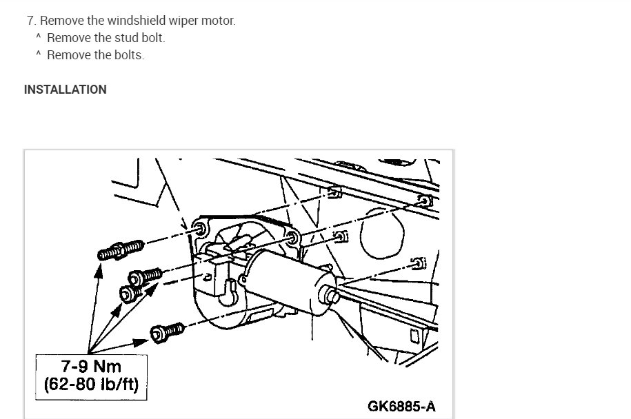

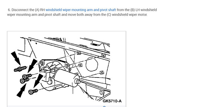

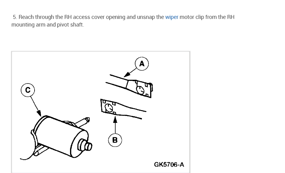

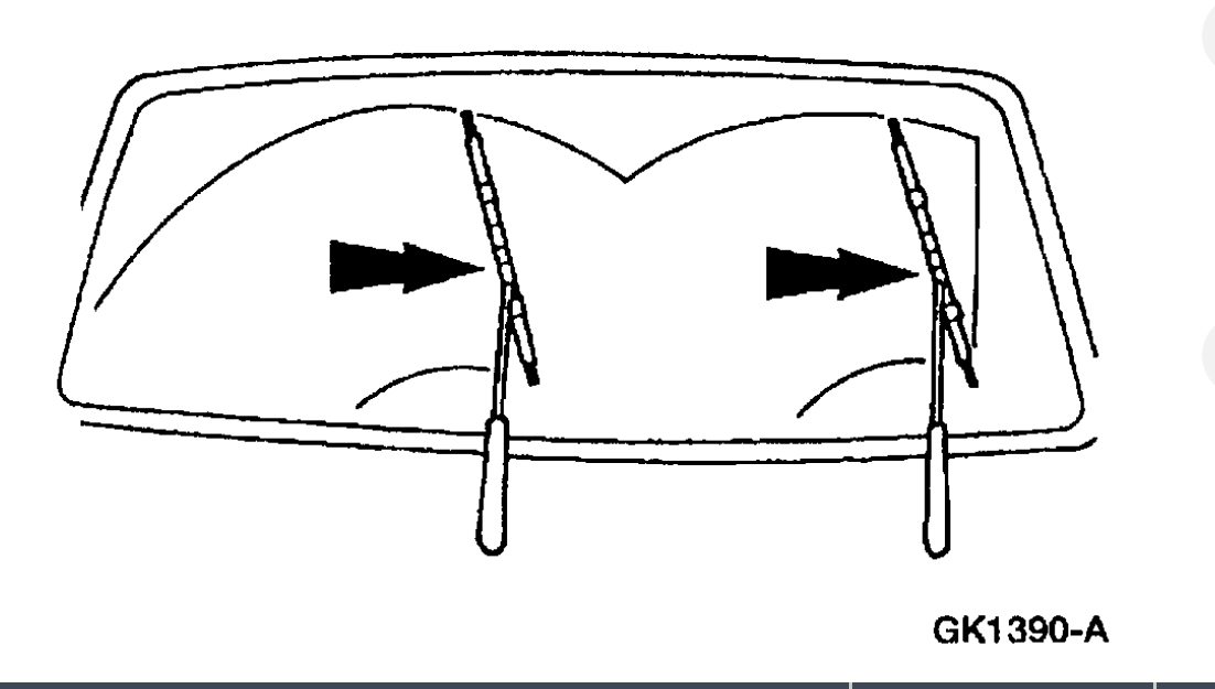

The windshield wiper motor is located along the firewall. In the diagrams down below I have included the directions from the vehicle manufacturer on the removal and installation of your vehicle's wiper motor. Please go through this guide and get back to us with how everything turns out. I hope this helps. There is a GEM module which is located behind the radio which controls the wipers. Check out the images (Below). Please let us know if you need anything else to get the problem fixed.
