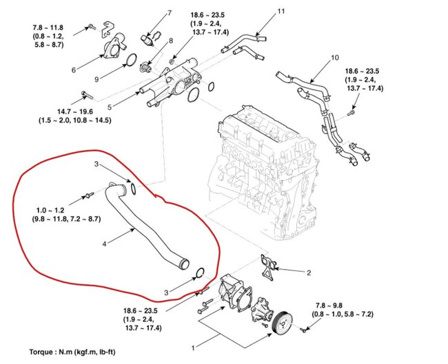

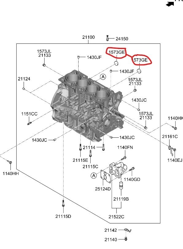

We have a coolant leak on the right side of the engine, IVO of the water pump. The water pump has been replaced and there is no sign of leaks/weeping from the weep hole or hoses. We suspect there may be a bad water jacket core plug based on the Haynes manual but are having a hard time finding a good diagram of the location of the core plugs. The leak is slow - one reservoir-worth a week, but we need to pin this down.
Can you help me out with some diagrams of the core plug locations?

There are 2 core plugs on that engine, and both are on the opposite side of the engine than the water pump. If the leak is on the same side as the pump, I would suspect the inlet pipe that goes into the pump, either a bad O-ring or the pipe itself is cracked.

The inlet pipe is dry, and the coolant "seems" to originate on the right face of the engine. Spatter/kickback/spray is making the origin difficult to pin down. No coolant present in the oil (checked by drip pan, no separation or discoloration in the sample, checked by dipstick, no foaming or discoloration). There does seem to be a "clean" area on the engine on the right face that is less grimy/normal grease is thinner with possible coolant. It is possible that is due to kickup of coolant.
Appreciate the diagram! Thank you.
