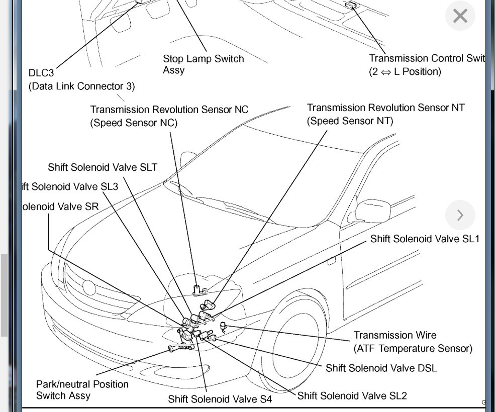

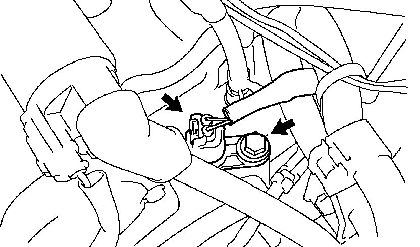

The transmission speed sensor is located on top of the transmission near the starter motor area. See image below:
Replacement
1. Remove battery.
2. Remove air cleaner assembly.
3. Remove air cleaner hose no.1.
4. Remove air cleaner bracket.
5. Remove air cleaner inlet no.1.
Let us know if the information help.

there are 3 sensors that sensor is magnetic the sensor I am looking is the gear driven speedometer sensor

That is the sensor for code P0500. It reads the transmission speed in the transmission and sends the data to the cluster.

yes there are 2 sensors on top below the air cleaner. I have replaced both of the those, but where the sensor with the shaft and gear that sends the signal to the speedometer? thank you for your help I appreciate it.
Feb 23, 2020 at 3:46 AM

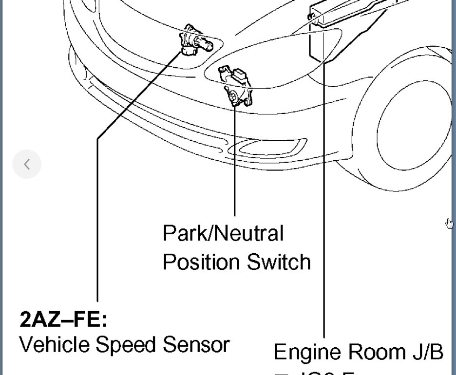

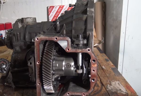

If I can jump in, looks like you already replaced the NC and NT speed sensors. These are the magnetic sensors that you are referring too.
The driven gear "sensor" that you appear to be looking for is the vehicle speed sensor.
Here is a video and a picture of a 1997-2001 Camry. I could not find them from your model year but it should be in the same area. The first two diagrams with the drawings are from your model year.
Keep in mind they say this is in the transmission but it is actually in the differential part of the transmission because it is considered the output speed sensor.
https://www.youtube.com/watch?v=rrPaU7a4sxs
Hopefully this helps. Let us know if you have questions. Thanks
