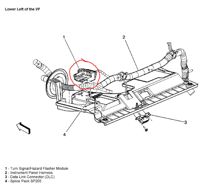

Vehicle listed above is the LS model. need to replace flasher.
Sep 8, 2019 at 9:18 AM
MRSHEETMETAL82
right signal works okay left does not.
Sep 8, 2019 at 9:21 AM
DANNY L
  • 5,648 POSTS
Hello, I'm Danny.
The flasher is located under the dash near the steering column. I've attached a picture below of its location and what it looks like.Hope this helps and thanks for using 2CarPros.
