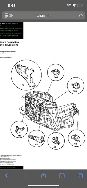

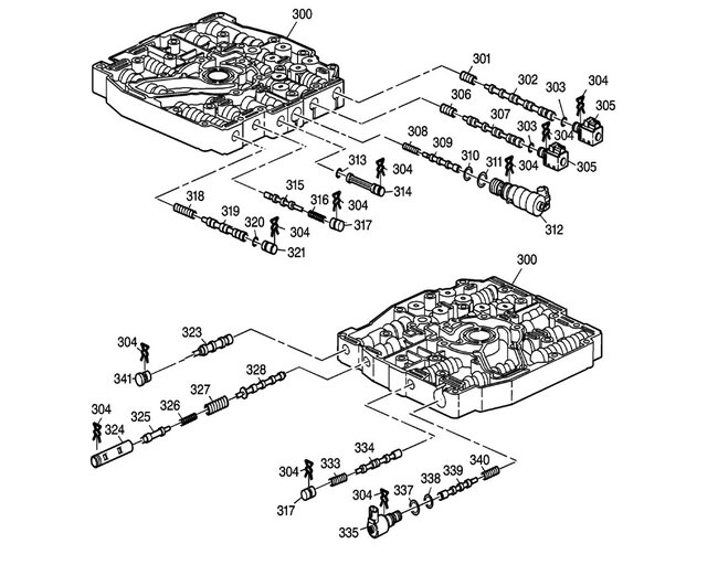

Hey, I’m trying to replace my automatic transmission solenoid. I already found the diagram which I have attached to this question. I know how to replace the solenoids and board; however, I don’t know where exactly they are on the car. I need to know where under the hood/car they are exactly. I haven’t been able to find any source telling me where they are.

Here is the diagram.

They are inside the transmission attached to the valve body under the access cover. You need to drain the transmission, remove the cover and you will see the solenoids where they mount.

Are you sure about that? All the information I have managed to find implies the components in the diagram i sent are next to the engine. I’ve been told the repair requires me to remove a side panel, and I’ve found no mention of having to drain my transmission in order to switch them out.

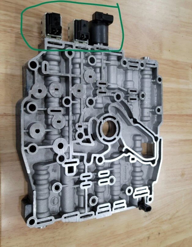

100 percent sure. The solenoids are mounted to the valve body that is inside the transmission. They move the shuttles in the valve body to change the fluid flow and pressures that make the system operate. That valve body looks like the attached and is under the cover on the transmission. Your car uses a 4T40 transaxle and the valve body is under the side cover. You need to drain the fluid, remove the left side axle and then remove the cover to get to the valve body where the solenoids are. Generally, most information on that vehicle also assumes you have removed the transmission first as there isn't enough room to get the side cover off in most applications that use that transaxle.
