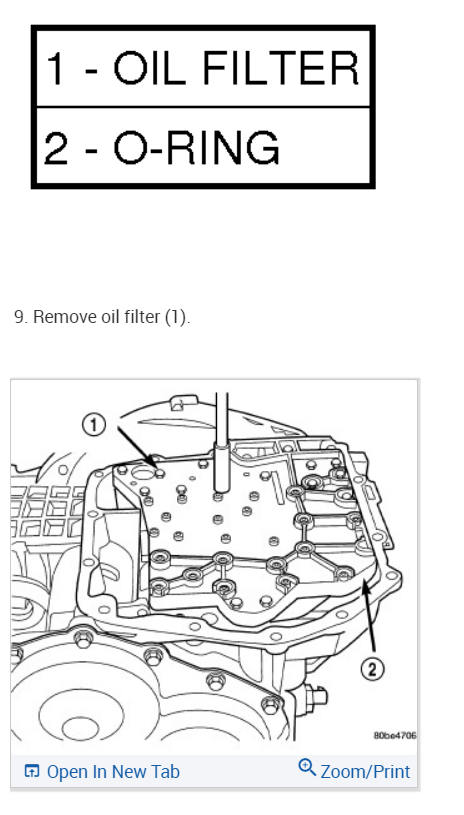

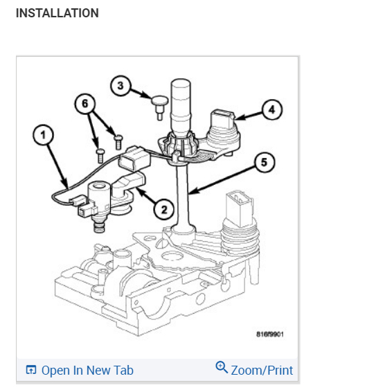

Transmission will not shift out of first gear, where is transmission fluid sensor located?
2013 CHRYSLER 200
180,000 MILES • 2.4L • 4 CYL • 2WD • AUTOMATIC
MS.SGT.21

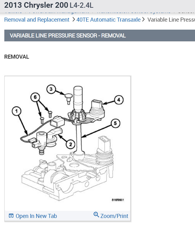

I think I need to change the transmission oil pressure sensor, but I can't find it on my vehicle. Please help.
Jul 15, 2023 at 12:39 AM
  • 55,433 POSTS

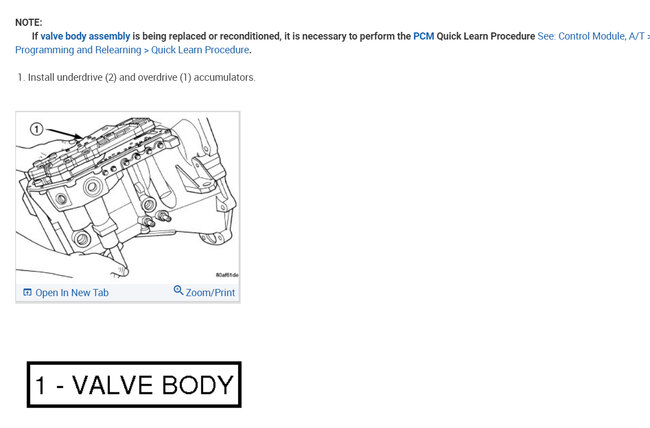

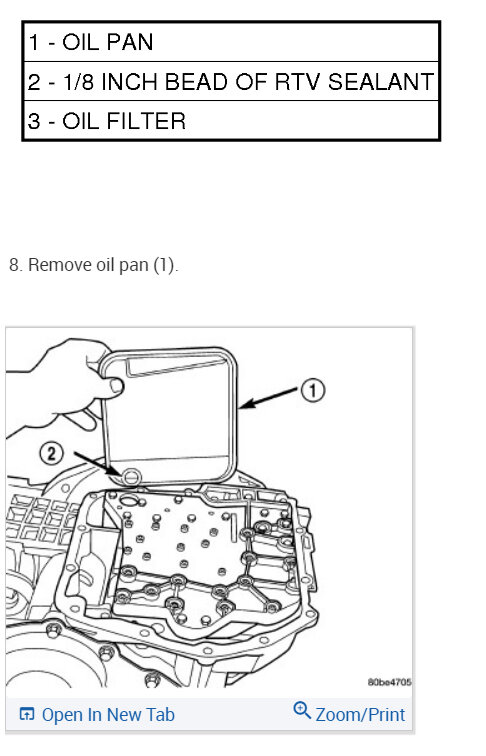

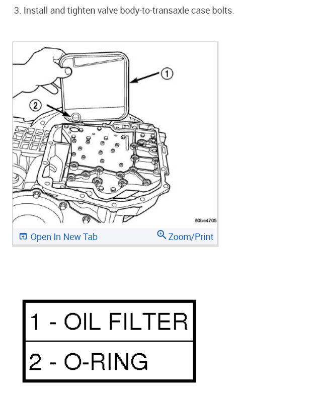

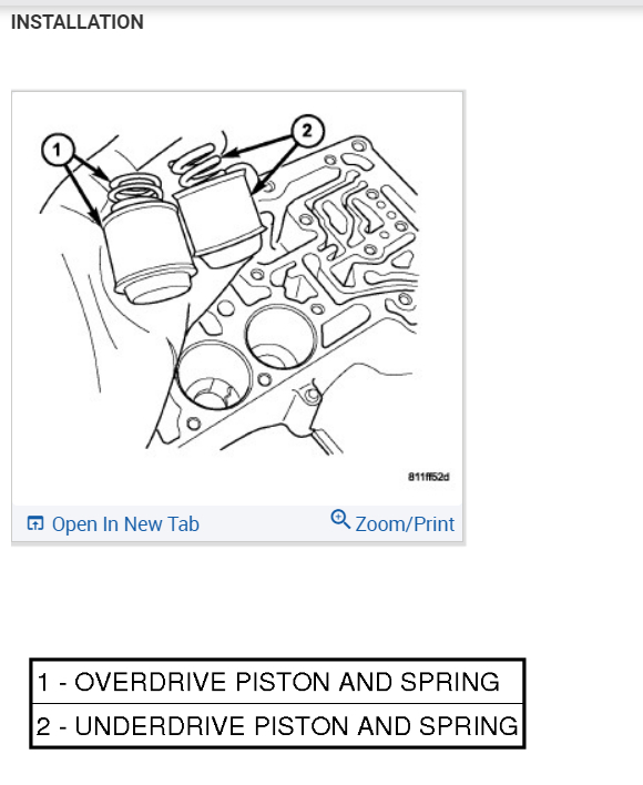

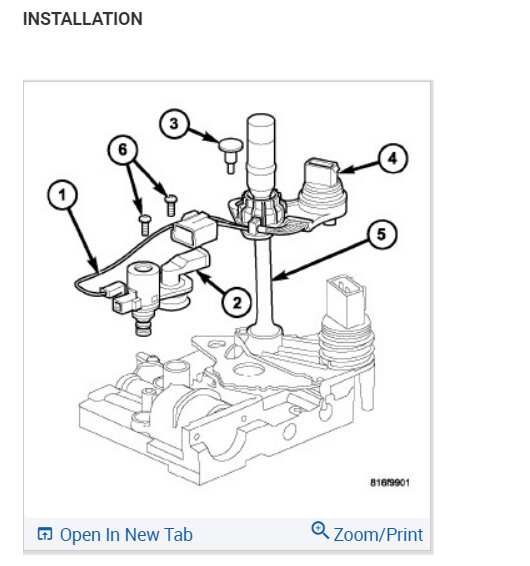

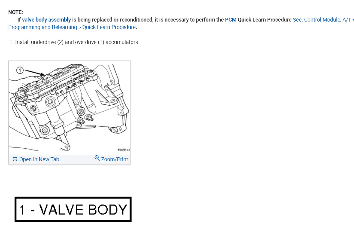

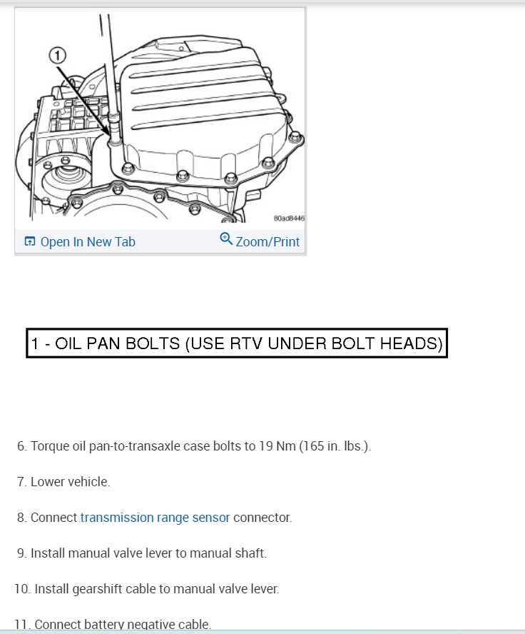

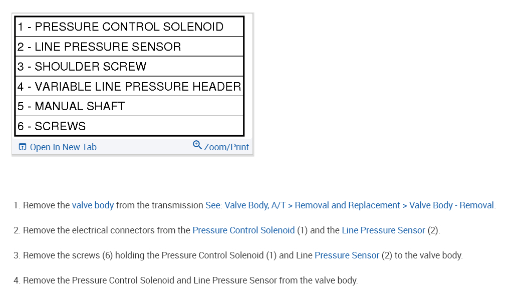

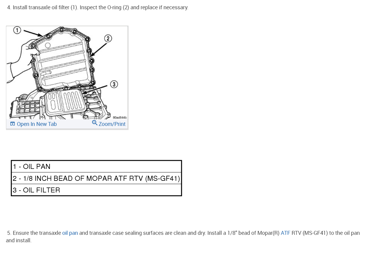

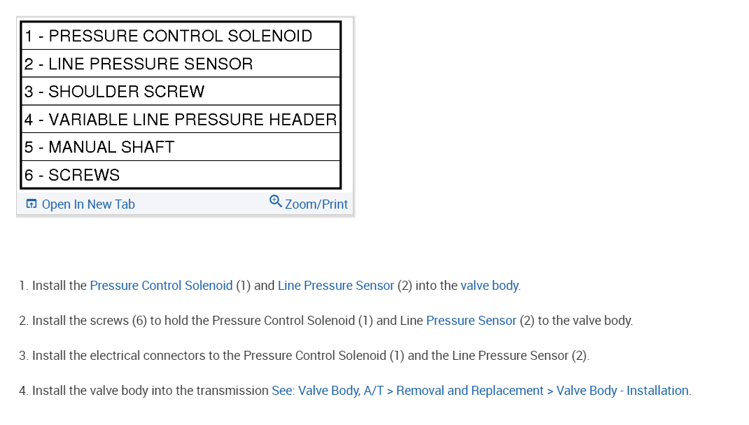

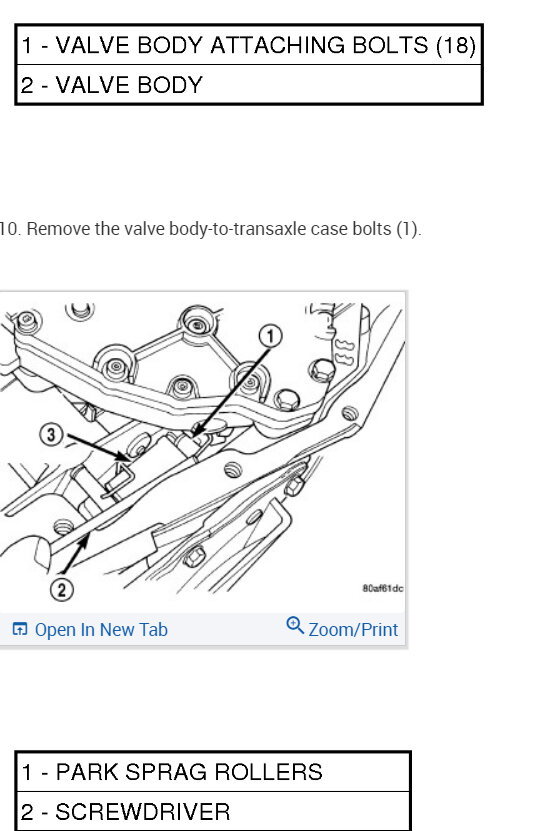

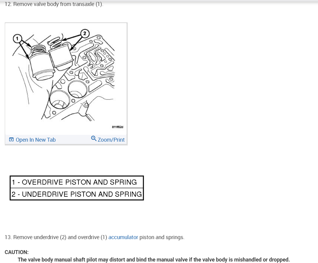

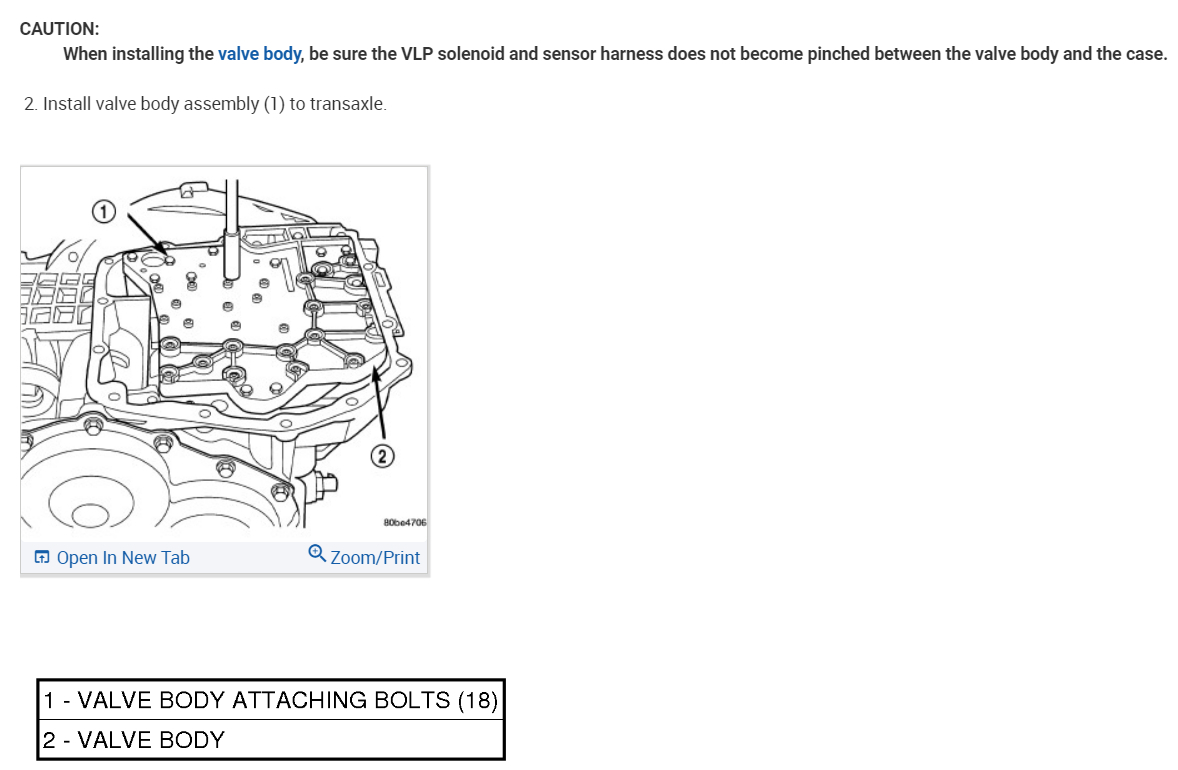

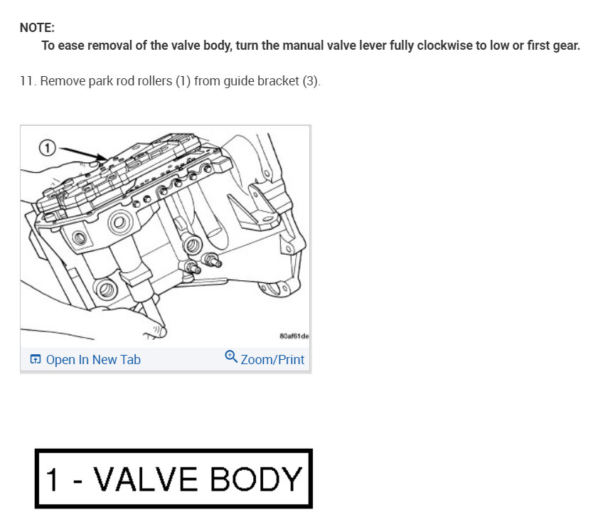

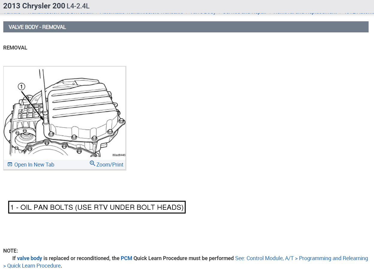

The oil line pressure sensor is in the valve body. Here is how to remove the valve body and replace the sensor.
Fill the transaxle with Mopar(R) ATF +4 Transmission fluid.
Check out the images (below). Please let us know if you need anything else to get the problem fixed.

The piece that was suggested looks to be an external piece that goes on the side of the pump.
Jul 15, 2023 at 6:05 PM
  • 55,433 POSTS
goes on the side of the pump? I am not sure what you are saying here. The transmission pan must be removed to change the sensor out.
Jul 16, 2023 at 3:06 AM
MS.SGT.21
Thank you, I see that now, your advice is most helpful.
