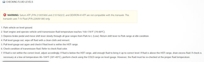

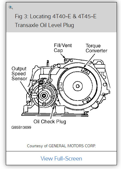

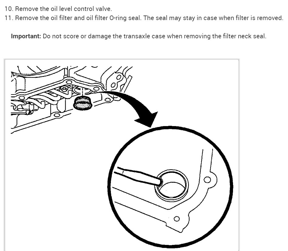

Can you please send me a diagram showing the location of the drain plug for my Saturn Lw300 3.0l automatic transmission? These cars have a sealed transmission and we had to replace a leaking line. Want to make sure we don't over or under fill.
As usual, thanks in advance.
Jon
Feb 8, 2019 at 1:05 AM
SCGRANTURISMO
  • 4,897 POSTS

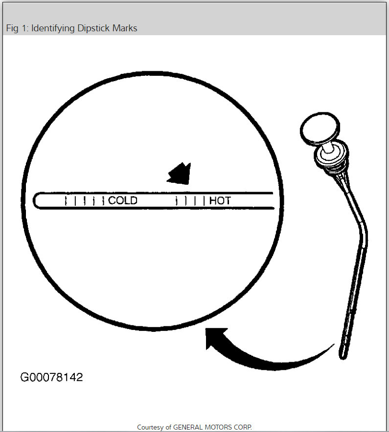

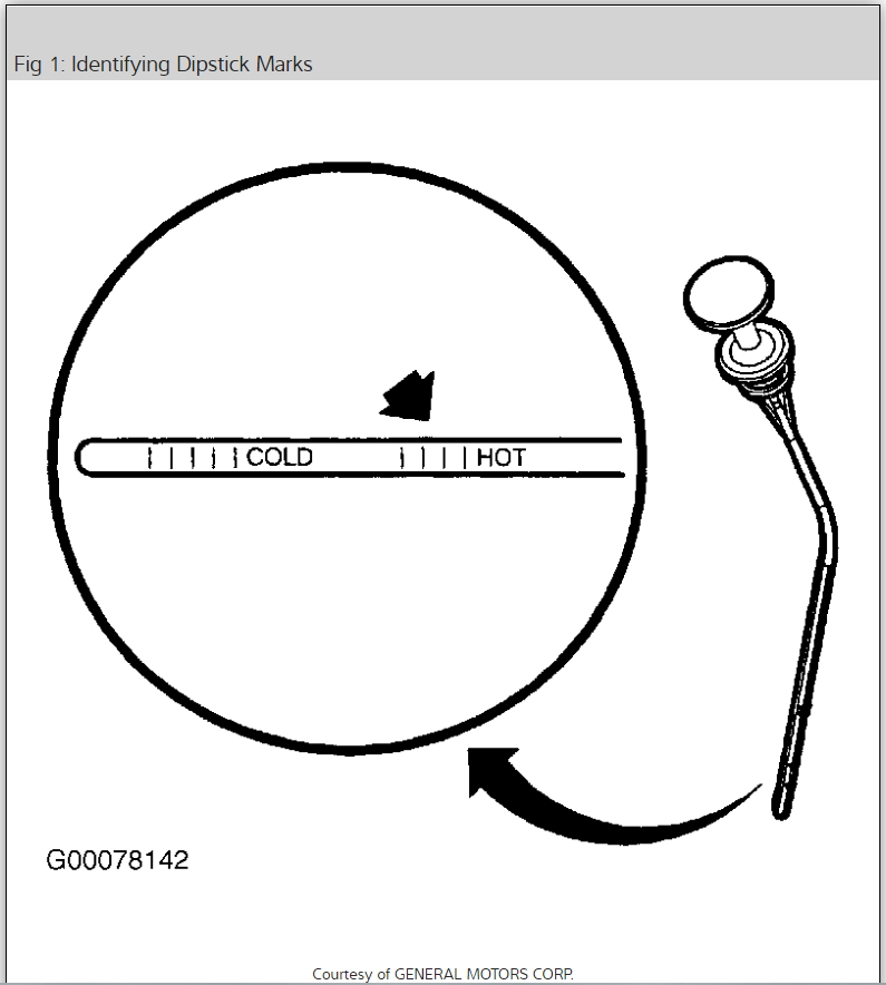

I have included the information you have requested in the diagrams below. I hope that this helps you and please feel free to ask us any more questions that you may have.
Thanks,
Alex
2CarPros
Feb 8, 2019 at 2:37 AM
JONSOLOW13
  • 133 POSTS

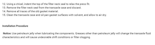

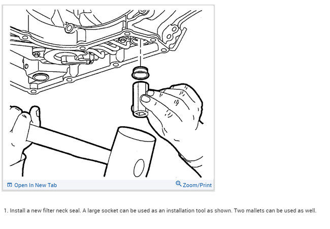

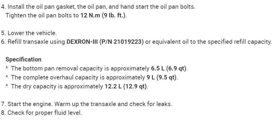

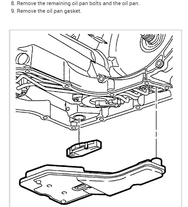

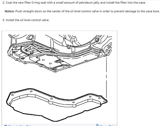

I'm confused. On my LW300 (3.0L engine) there is no transmission dipstick. There is only a plastic top on top of the transmission to be able to add fluid, and a drain plug underneath the engine, presumably at the transmission case. Are you sure you didn't send me information on the four cylinder engine (LW200)?
Feb 8, 2019 at 1:37 PM
SCGRANTURISMO
  • 4,897 POSTS

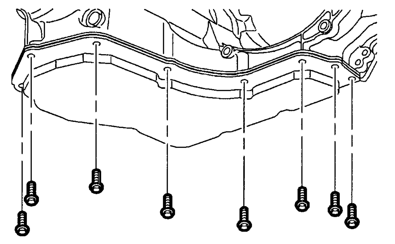

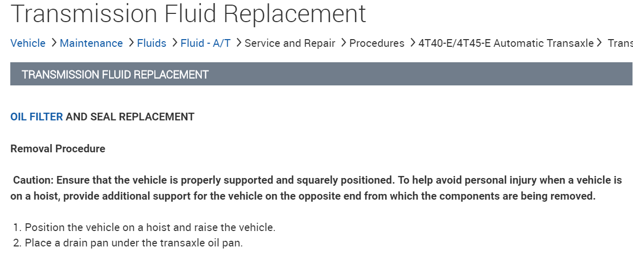

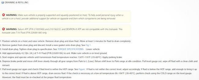

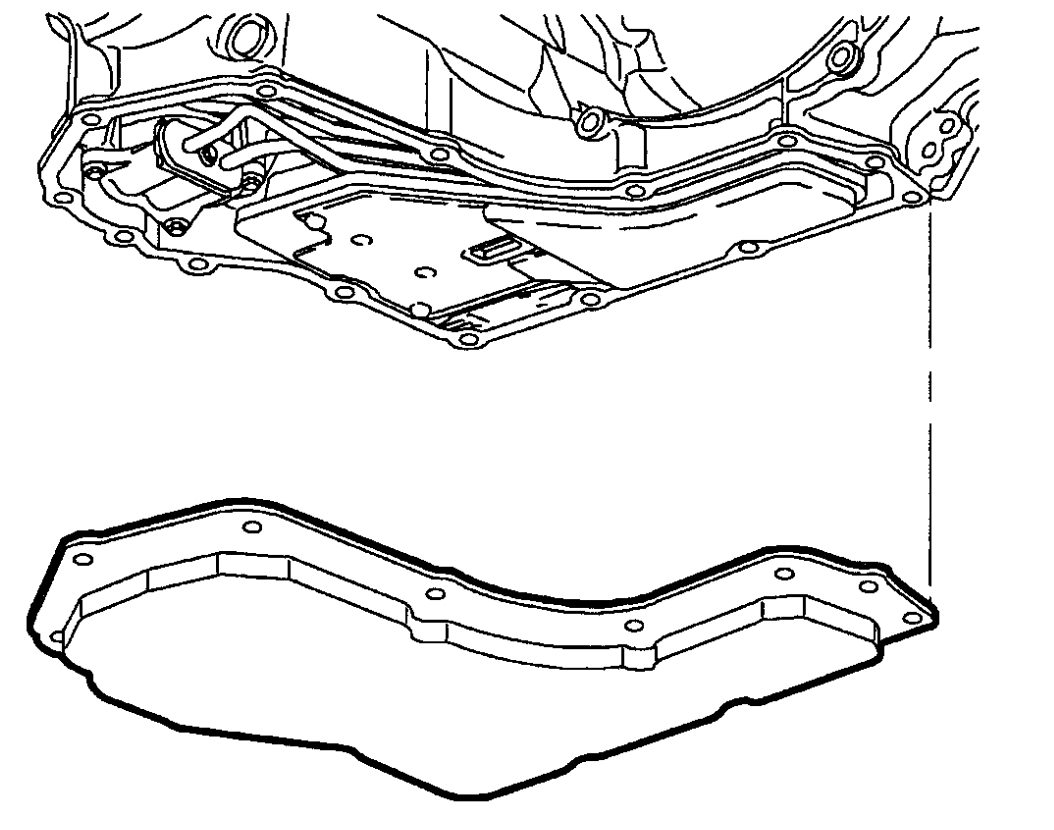

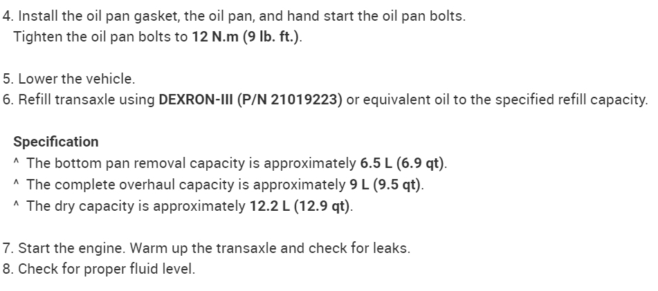

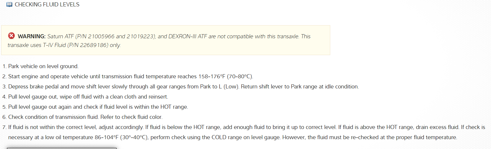

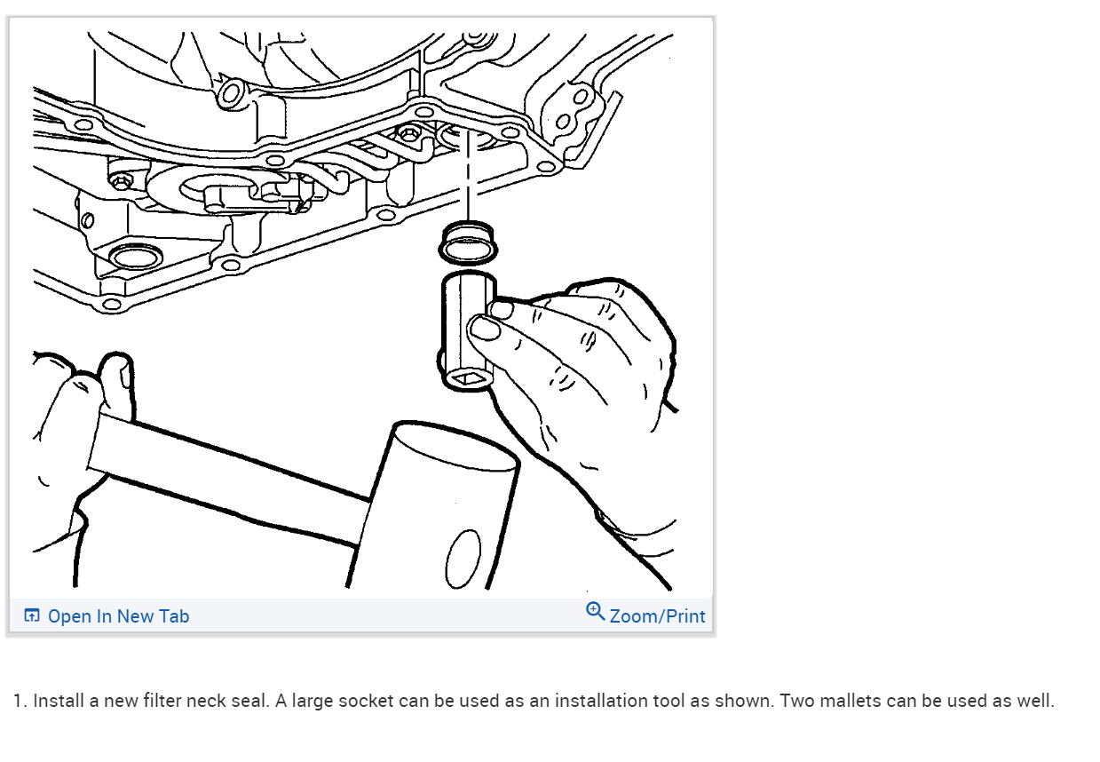

Sorry about that, I did get the wrong one. I have included the correct step by step directions for your vehicle, 2002 Saturn LW300 transmission, on how to change Transmission Fluid in the diagrams below. Hope this helps, and again, sorry.

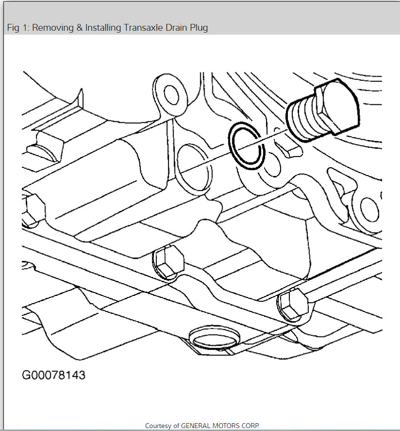

JONSOLOW13
  • 133 POSTS

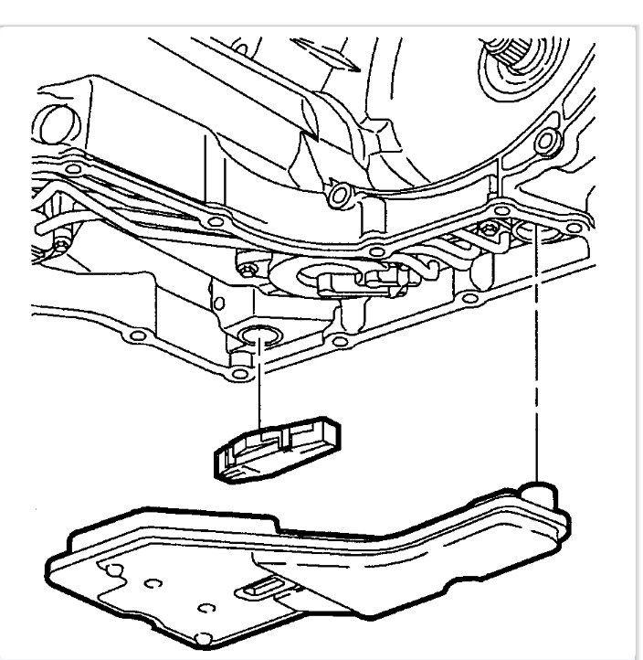

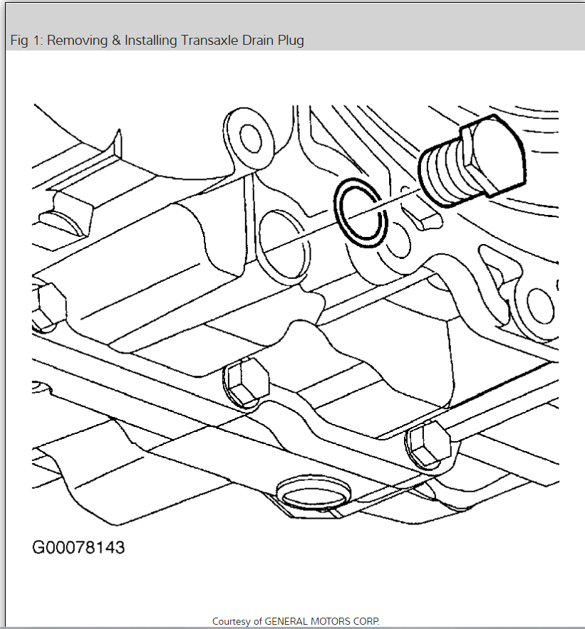

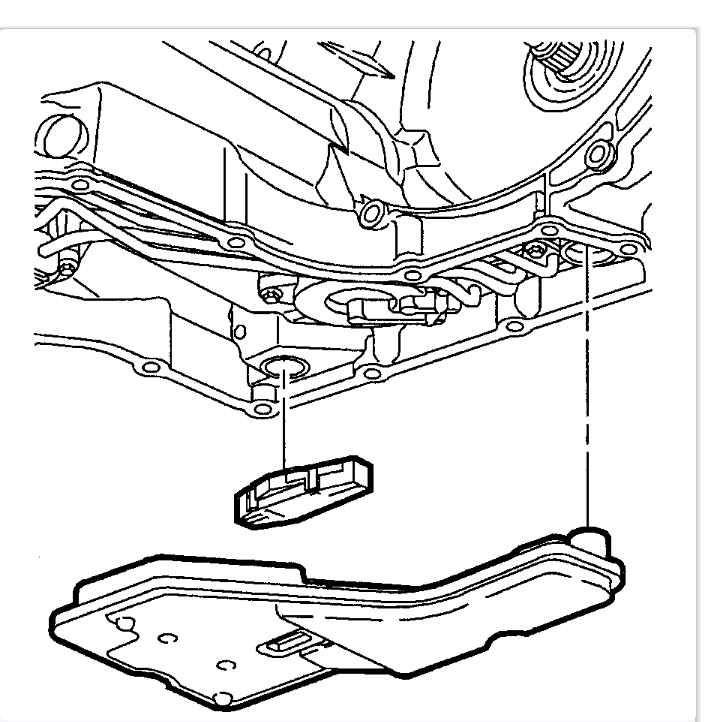

However, your information failed to answer my question. Please send me a diagram showing the location of the trans-axle drain plug.
Thanks,
jon
Feb 9, 2019 at 12:51 PM
SCGRANTURISMO
  • 4,897 POSTS
Hello again,
Sorry. Here is a diagram below.

JONSOLOW13
  • 133 POSTS
That's it!
Many thanks.
Jon
