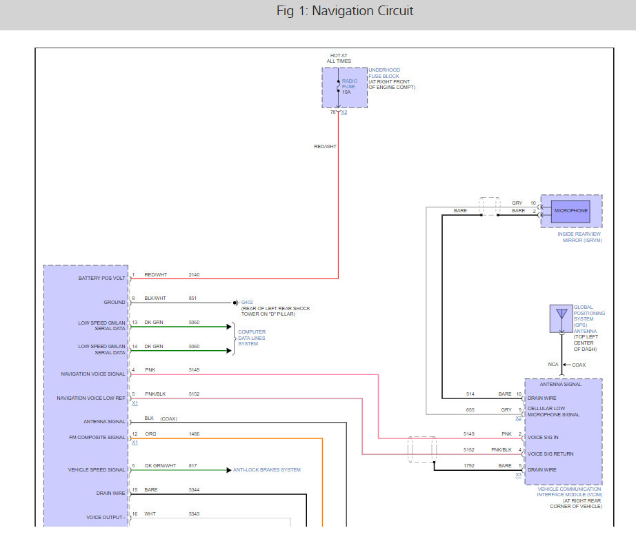

Where is the VSS wire located?
2008 CADILLAC SRX
102,000 MILES • 4.6L • V8 • 2WD • AUTOMATIC
JPRIETZ
  • 11 POSTS

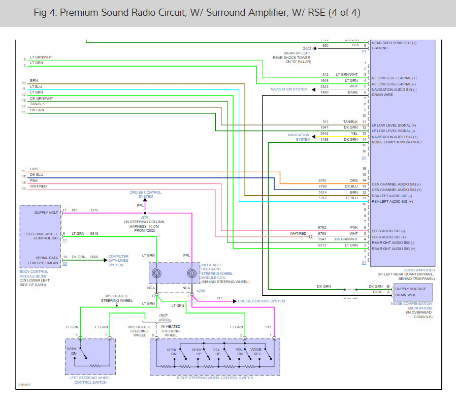

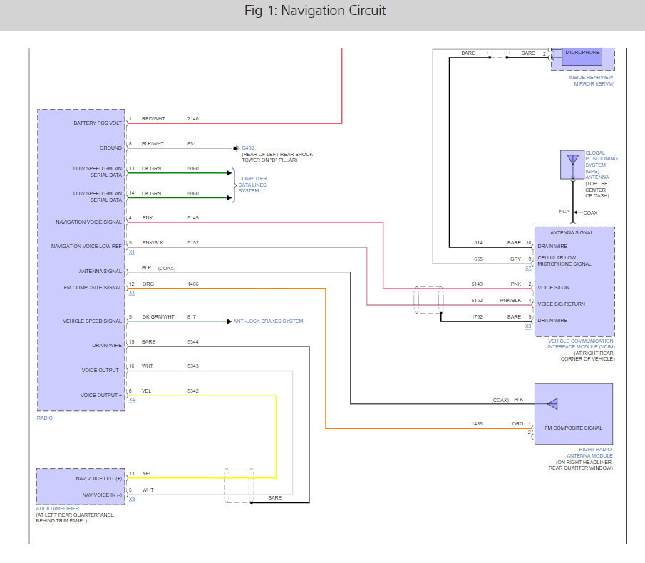

The car has the OEM AM/FM/CD/XM radio and will get installation the OEM sat nav radio, much of it will swap over. but need the VSS signal to work correctly. I'm trying to find a location to get the VSS wire. Any help is appreciated.
Jeff
Jun 26, 2022 at 11:26 AM
  • 55,423 POSTS

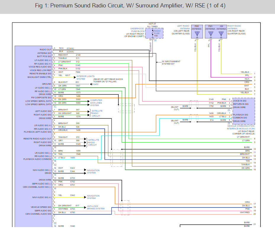

The VSS signal wiring from the ABS system (dark green and white wire) I would think this information is available in the CAN system which is where the NAV system would pick it up. It should be present in the radio/Navi wiring harnesses. Here are the wiring diagrams for the NAV and radio I have found to help you with the job. Check out the diagrams (below). Let us know what happens and please upload pictures or videos of the problem.
Jun 27, 2022 at 4:05 AM
