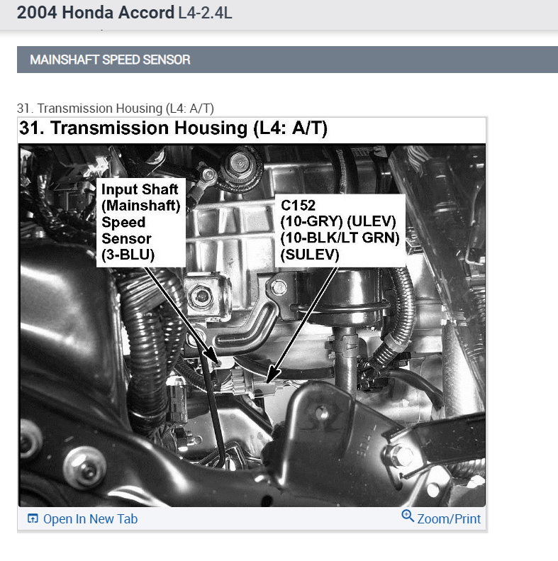

I need to replace the output sensor on the car, but I cannot find the location of the sensor for my transmission.
Thanks!

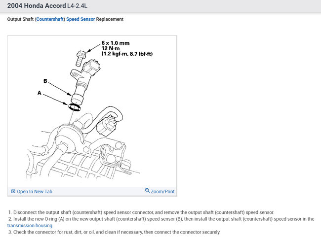

It looks like the output shaft speed sensor is about halfway down the case on the passenger's side. here is the exact location in the diagrams below. Check out the diagrams (below). Please let us know if you need anything else to get the problem fixed.

Are there any landmarks I can use to identify where it is? I think I found it, but I am not sure. That picture is much cleaner than my corroded engine.

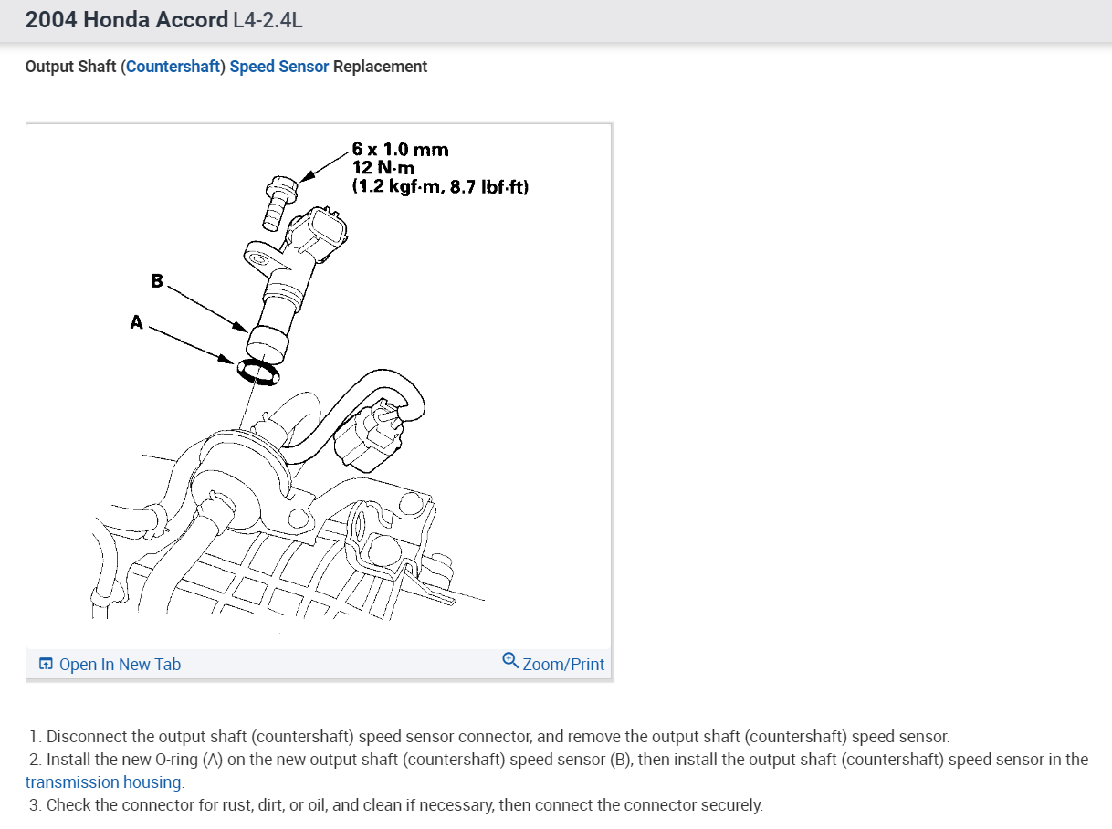

Lol yep, here is a better image. Check out the diagrams (below). Please let us know what you find.
