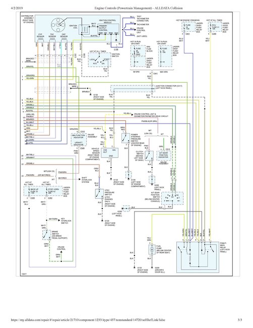

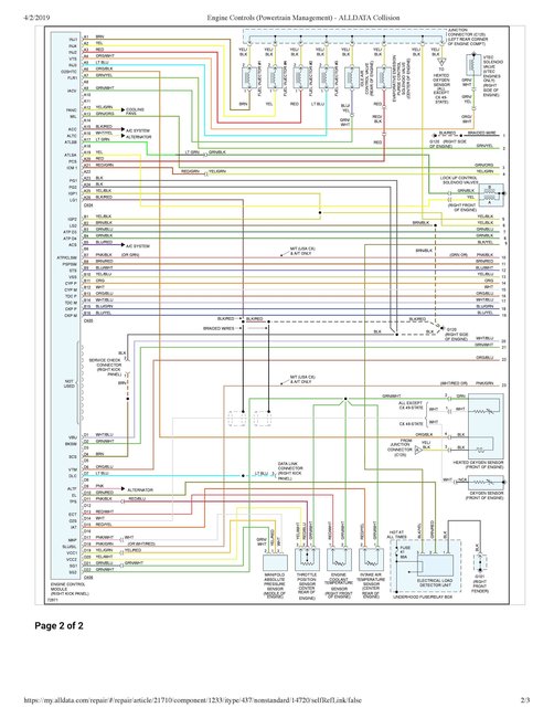

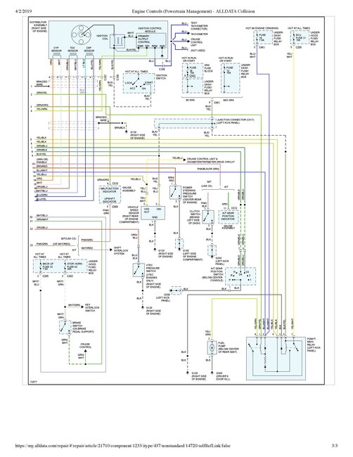

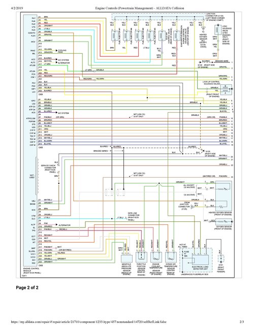

I replaced the engine harness with a wire harness so its from the ECU to the engine and the only part of the old harness that is used is the two clips on the drivers side. Yes, I have a multi-meters yes Hondata told me it can’t be the Hondata unit because the ECU is what reads the speed so they said it’s wiring or the ECU I open the ECU looking for anything burnt and did not see anything. Also my cruse control still works but that’s for the diagrams it raining here today. So I’ll do some more work on it tomorrow.
Thursday, January 7th, 2021 AT 10:32 AM (Merged)
JOETECHPRO
  • 705 POSTS
Hey TIMOTHY SHINKAROFF,
So the harness from the VSS to the ECM/cruise control/instrument cluster has been replaced?
Where does the Hondata connect?
You will need to check the wiring, I would start by disconnecting the VSS and the ECM.
Check resistance between -
Pin 3 Yellow/white wire on the VSS
Pin B10 Yellow/blue wire on the ECM
You are looking for a low resistance value (0-3ohms)
Let me know what you get here.
Do you have the check engine light on?
I have attached the wiring diagram again below, it came out low resolution before.
Regards, Joe
