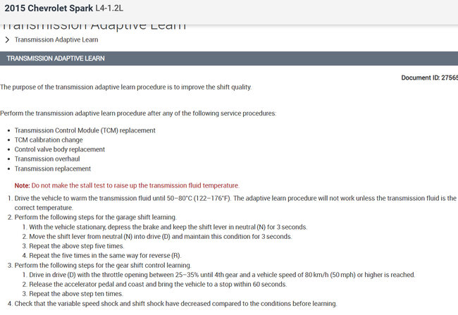

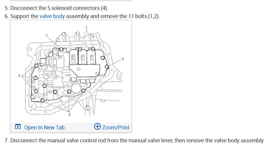

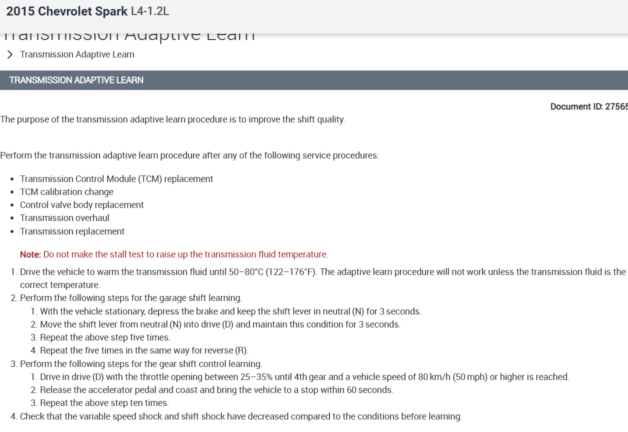

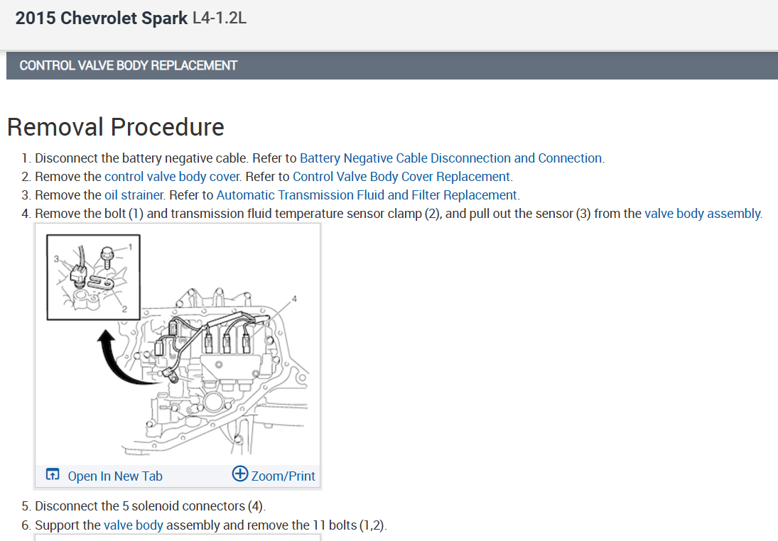

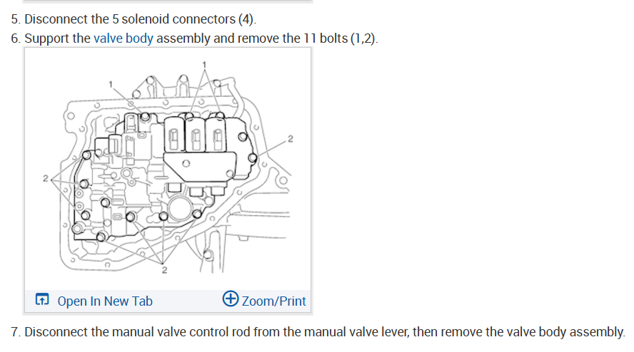

Where is the transmission pressure sensor located?
2015 CHEVROLET SPARK
109,000 MILES
ORANGE
I need to install a new transmission pressure sensor on my vehicle listed above. Where is it located?

This car doesn't not have a pressure sensor, but it does have a pressure which is that what you mean? If so, the pressure switch is located inside the transmission control solenoid valve assembly. Once the valve body has been replaced you will need to do the adaptive relearn which I have included as well. Check out the images (below). Let us know if you need anything else.
