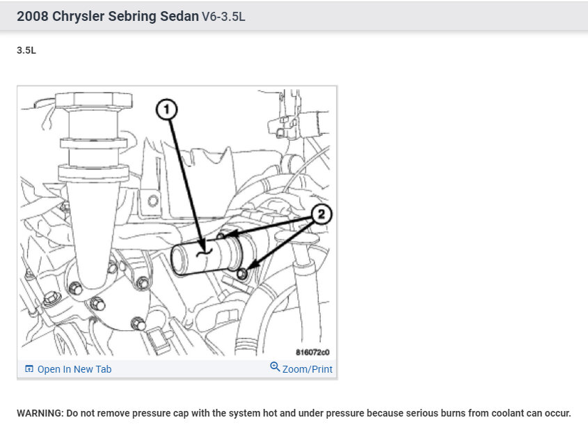

I need to know the location of the thermostat.

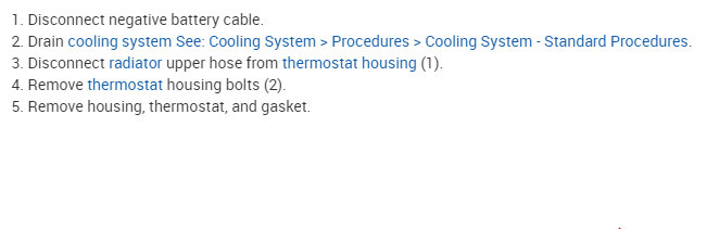

If you follow the top radiator hose from the radiator to the engine, the thermostat is under the housing that the hose connects to the engine.
If you are replacing it, here is a link you may find helpful:
If you look at the pics below, they are the directions for replacing the thermostat specific to your vehicle.
