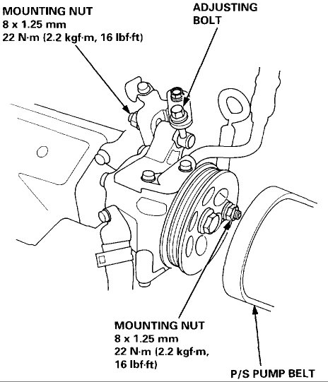

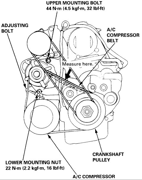

Location of the tension pulley
1994 HONDA ACCORD
140,000 MILES
ALICIA ARELLANO
My serpentine belt fell off and I am wandering where the tension pulley is located?
Jul 4, 2017 at 3:20 AM
ED-WEEZY21
  • 248 POSTS
So this vehicle is equipped with two serpentine belts AKA drive belts. You have the power steering belt and the other one that runs your alternator and AC compressor. The first picture shows the adjusting bolt for the power steering belt and the second picture shows the adjusting belt on the left side on the alternator. Hope this helps.
