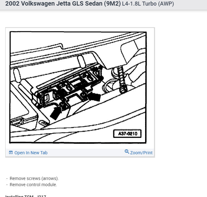

Where is the transmission control module located?
Oct 21, 2022 at 7:15 PM
SQM
  • 6,383 POSTS

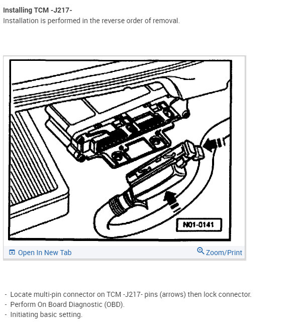

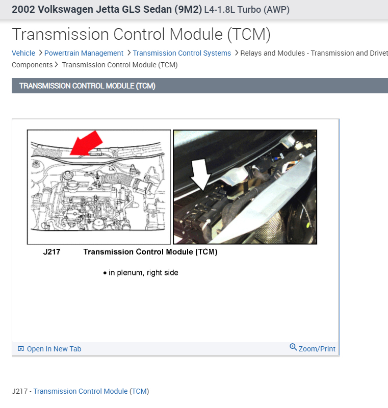

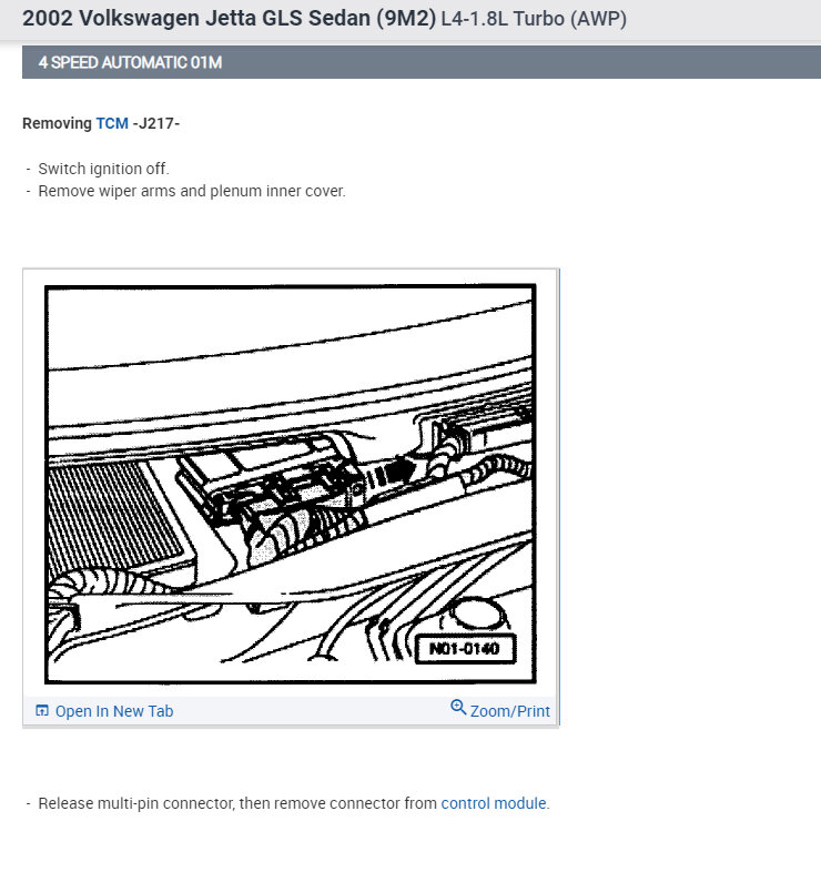

The TCM is located below the windshield cowl on the passenger side.
I have attached diagrams below for your reference.
Let me know if you have any questions.
