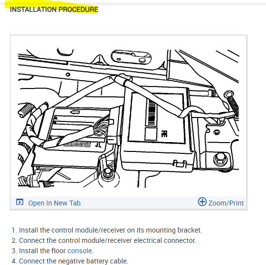

Where is the Keyless Receiver Module located?
2004 DAEWOO MATIZ
100,000 MILES • 1.0L • 4 CYL • 2WD • MANUAL
ROBERTO DI BIAGGIO
Cannot find the Keyless Receiver Module location, not even on the Service Manual.

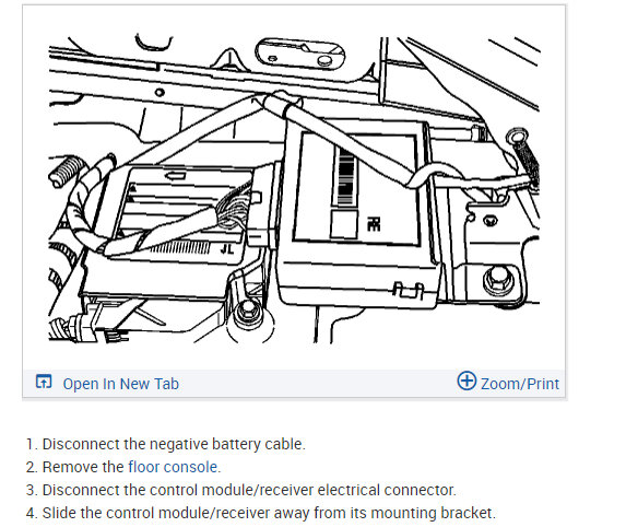

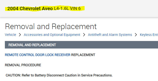

This model wasn't offered in the US, so I have no specifics on it. However, I believe it is very similar to the Chevy Aveo that was offered here.
According to the manual, in 2004 the RKE was under the center console. I attached the directions below. Take a look and let me know if this helps.
