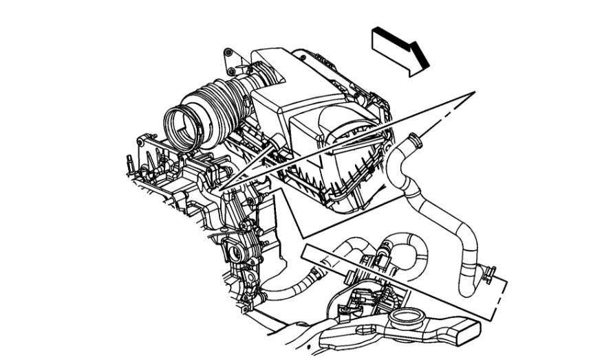

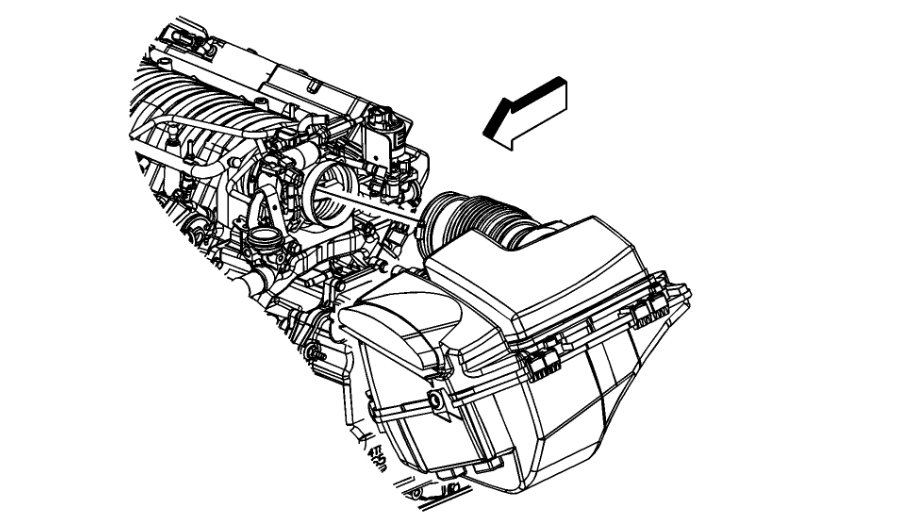

I cannot find the cars computer to clean the connectors or check it out, after disconnecting battery of course.
Jul 4, 2018 at 4:28 AM
Good evening.
It is under the air filter box assembly.

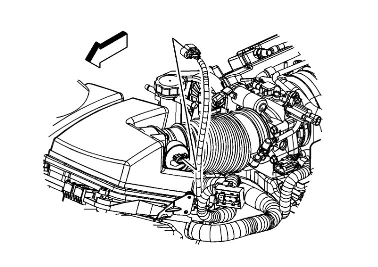

4. Disconnect the engine harness electrical connector from the mass air flow/intake air temperature (MAF/IAT) sensor.
imageZoom/Print

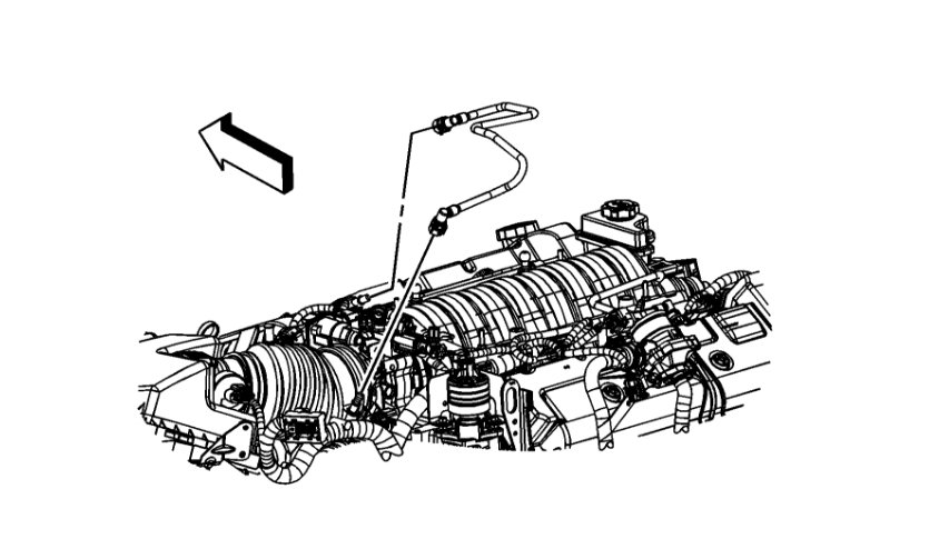

5. Disconnect the positive crankcase ventilation (PCV) fresh air tube quick connect fitting from the air duct.
imageZoom/Print
6. Disconnect the secondary air injection (AIR) pump inlet tube quick connect fitting from the air cleaner upper housing.
imageZoom/Print
7. Loosen the air cleaner outlet duct clamp at the throttle body.
8. Remove the air cleaner outlet duct from the throttle body.

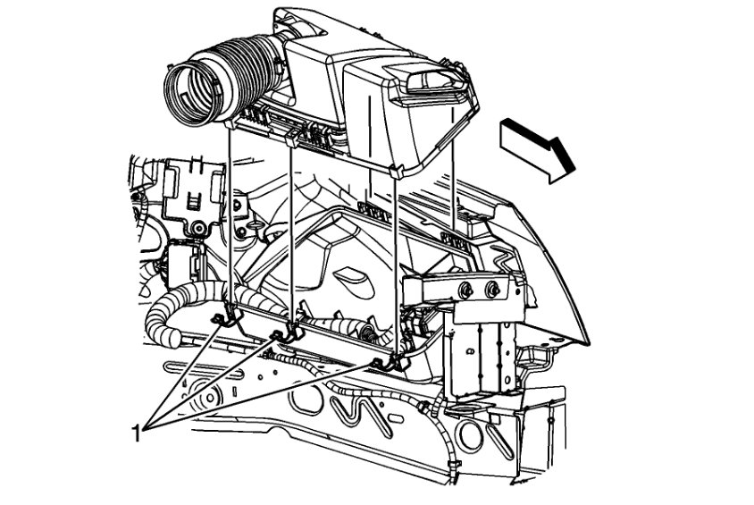

9. Disengage the lower housing clips (1).
10. Disengage the upper housing front tabs from the lower housing.
11. Remove the air cleaner upper housing.

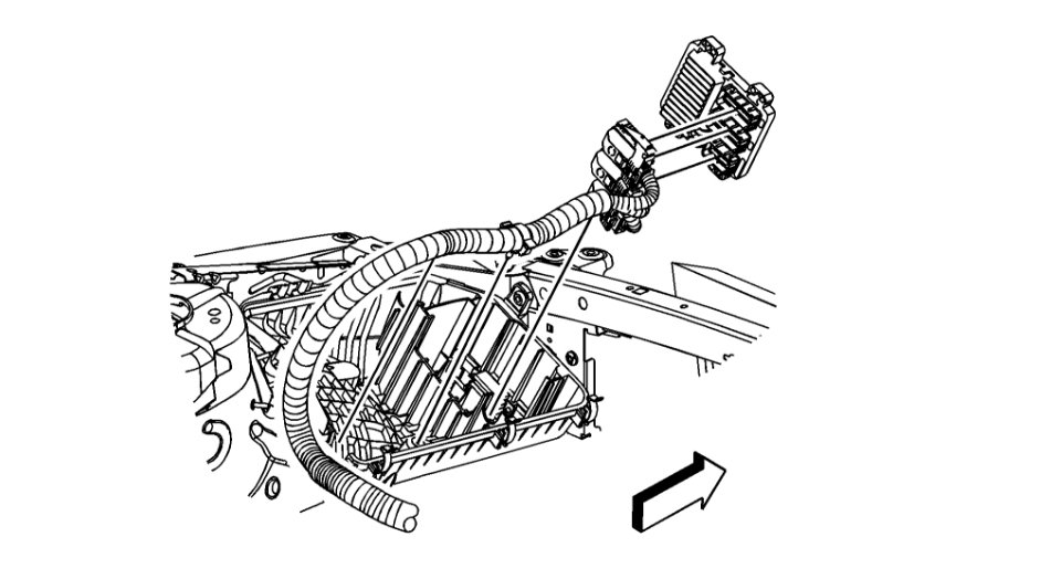

12. Disengage the engine harness electrical connector lever locks at the ECM.
13. Remove the engine harness electrical connectors from the ECM.
14. Remove the ECM from the air cleaner lower housing.
