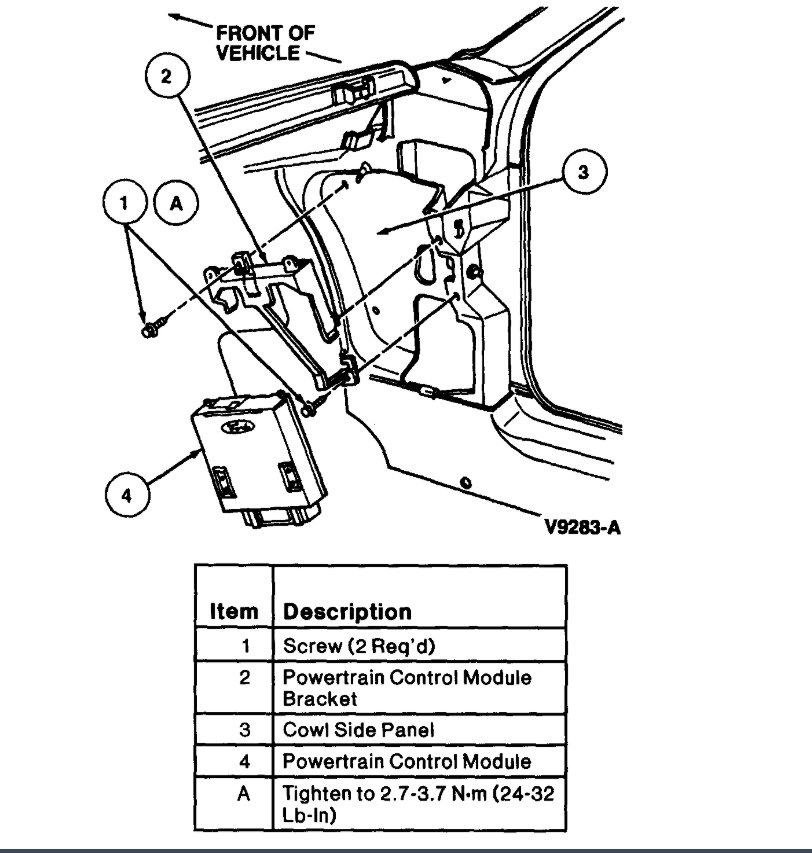

I do not know where the ICM is. I have one new I just need to install it. Can you help me?
Jul 11, 2018 at 11:43 AM
DANNY L
  • 5,648 POSTS
Hello, I am Danny.
The ignition control module is inside the PCM on this car (1995 is the last year for the ICM). The PCM (power-train control unit) is located behind the right kick panel. Hope this helps and feel free to ask any questions if needed. Thanks for using 2Carpros.

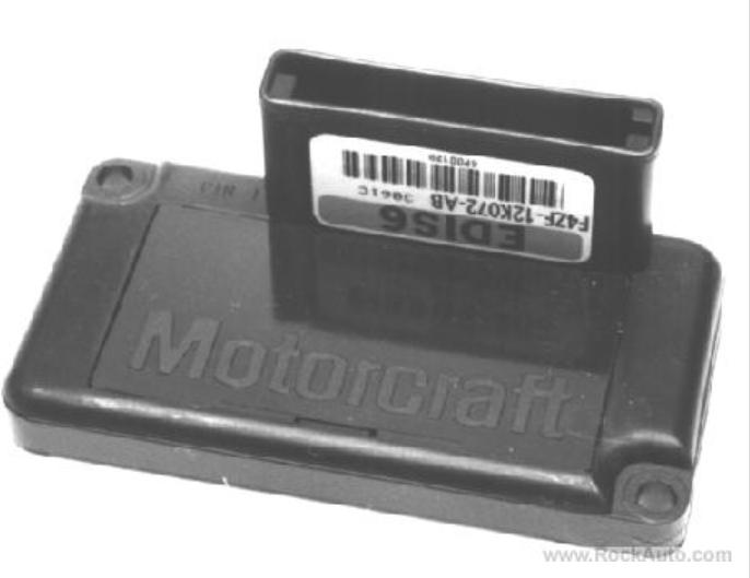

I can not find the ICM (Ignition Control Module) on my 96 Stang 3.8L. After searching several blogs, all the recommended places ... under/behind the air intake, next to the radiator mounts, engine comp. strut areas, behind the kick panel on the interior passenger compartment, under the splash guards behind each front wheels. Nothing is found. Ford parts still show an ICM for this vehicle and even an exploded view of the ignition system showing the ICM screwed to the frame. Oddly, the Ford Electrical Troubleshooting Manual for the 96 makes no mention of an ICM nor the Haynes Manual. Any ideas?
Mar 29, 2021 at 7:58 PM (Merged)
HMAC300
  • 48,601 POSTS
I can't find it in our manual as well but I have poic of it from rock auto so it might be a partial year thing

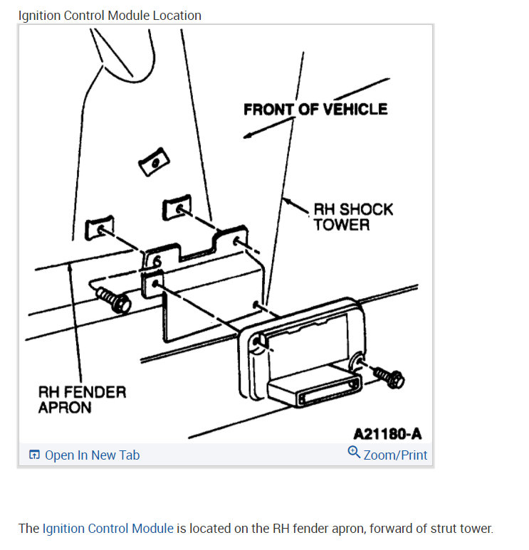

if you do have it on a 95 it is on right inner fender panel forward of strut tower.

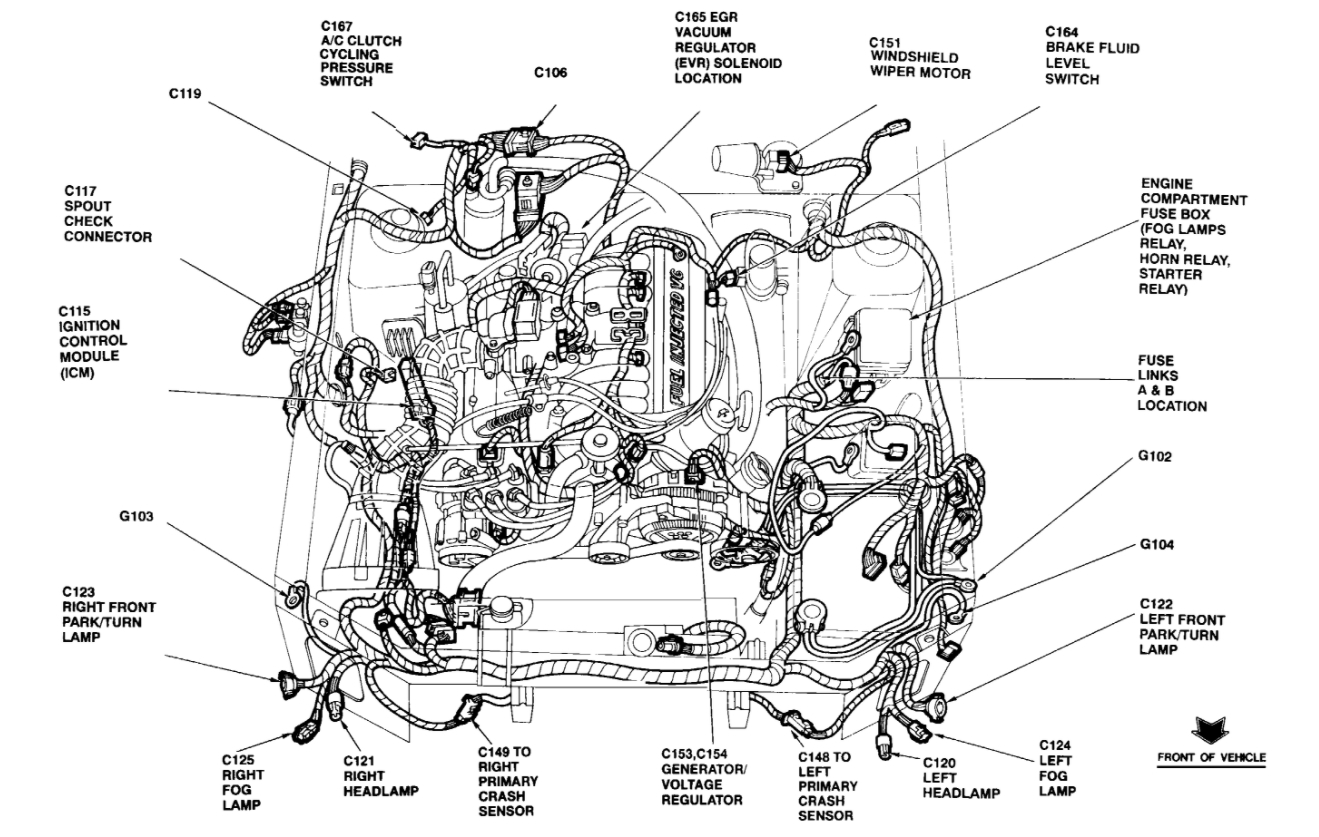

Mar 29, 2021 at 8:02 PM (Merged)
WRENCHTECH
  • 20,761 POSTS
Here is the location and replacement instructions of the ignition control module. Check out the diagrams (Below). Please let us know if you need anything else to get the problem fixed.

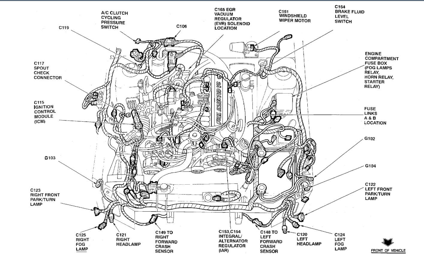

KAYBEE034
I bought the car not knowing what was wrong with it. It was apparently having an electrical problem that the previous owner was trying to chase because the electrical harnesses were spliced all over. Then it also had the radiator and fan out as well. I have replaced the engine and ignition harnesses, ignition module, coil, plugs, and wires and a 20 amp EEC fuse that was blown, the radiator and the fan. Once I did all of this, the car fired right up. It sounded good and was holding a steady idle. I was warming the car up so that the thermostat could open and I could finish filling the radiator. Then all of a sudden, it just shut off, like the key had been turned. When I tried to restart it, there was no spark. I took the ignition module off and replaced it again and the car fired right back up. I have done this 3 times now and each time the car runs long enough to start to get warm, the ignition module goes out all over again. Does anyone have any suggestions as to what could be causing this? Thanks in advance for any and all advise.
Robert Bates
DAVE H
  • 13,384 POSTS
I would check for codes because it sounds like you have a computer going out but to be sure here is a guide to help you get the codes and the computer and ignition module location as well.
https://www.2carpros.com/articles/ford-lincoln-mercury-obd1-1995-and-earlier-diagnostic-trouble-code-definition-and-retrieval
Check out the diagrams (Below). Please run this test and get back to us.

need instructions on how to change the ignition control module on a 1994 Mustang GT Cobra, 5.0 HO
WRENCHTECH
  • 20,761 POSTS
The Ignition Control Module (ICM) is located on the RH fender apron, forward of the strut tower.
It's just a matter of unbolting the other one and unplugging the wiring harness.

ANNETTE BRINSON
I have a new ignition control module, but cannot locate the old one. Been told it is on the distributor, but cannot see it. help!
Mar 29, 2021 at 8:03 PM (Merged)
WRENCHTECH
  • 20,761 POSTS
Doc is correct, right front fender well. Here is a picture. https://www.2carpros.com/images/external/41874774.gif
