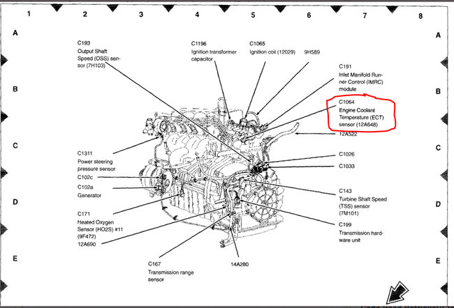

Hi team.
Please, can you help find the location of the ECT of my car? Is a Ford Focus mk2, 1.6L, 16 v, European version, from 2005.
Friday, June 5th, 2020 AT 12:29 PM
3 Replies
MECHANIC
109,932 POSTS

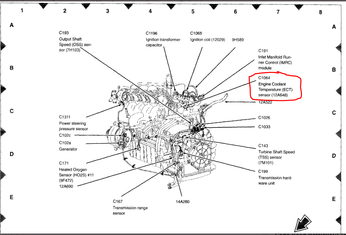

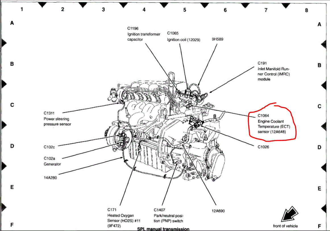

The engine coolant temperature sensor is located toward the rear of the engine. Here is a guide which explains in general how one is replaced:
https://www.2carpros.com/articles/coolant-temperature-sensor-cts-replacement
The two attached pics should help you locate the sensor.
