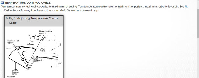

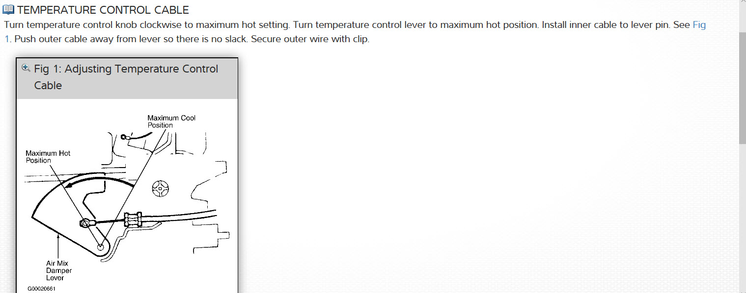

Cannot find the blend door actuator.
Thursday, December 22nd, 2016 AT 1:43 PM
HMAC300
MECHANIC
48,601 POSTS
You cannot find it because you do not have one. You have a cable that moves an air mix door check for a broken cable, see picture.
